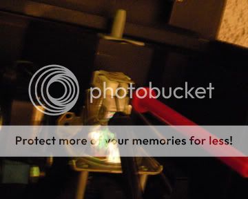

I bought a new bulb for the enlarger, a EJL 24V 200W (That's what was in the enlarger when it arrived). That still didnt work. My dad brught a similar bulb home from where he works, and it was a 12V 50W bulb, I think. I tried it just to please him (he was sure he had the bulb I needed, and it would fix the problem, despite my arguments to the contrary). Not suprisingly, it didnt work.
A few minutes ago, just out of curiosity, I plugged it back up to test the enlarger again. I turned it on and used the electricity meter to test the socket where the bulb plugs in. This time I got a reading, but the light still didnt come on :\ the reading on the meter was 400, but I dont know what that means. I got it to go up to 800 by spinning a dial on the meter. (I know nothing of electricity other than it'll kill me if I keepscrewing with my enlarger).
I took two pictures when I was using the electricity meter. Here they are
the positive and negative points in the light socket
The reading I was getting
any ideas what I'm doing wrong? I'll probably send it to get it repaired after the 4th of july weekend if I'm not stupidly looking over something (which I usually do)
