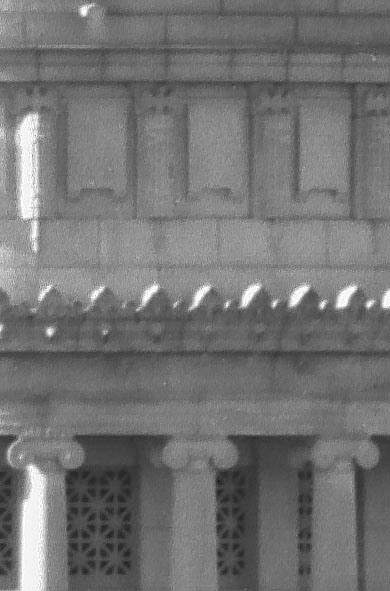

I've attached a quick test shot. This is the 15cm wide combination of 35+25 cm without the extension tubes, medium yellow filter (one of the three filters that comes with the set), f:25, about 3/4 sec, Polaroid 4x5" Type 55, on my Sinar 8x10" P with 4x5" reduction back. I used about a cm of rear fall. Scan at 1000 dpi from the neg (the detail is at full resolution). I processed the film about 50% extra (30 sec. total at room temp.) thinking I would need more contrast, but this was actually unnecessary.

There's a nice little trick that photographers knew all about when these lenses were new, which just about everybody has forgotten about....
You'll sometimes see old pictures of street scenes with seemingly impossible DoF - the street just in front of the camera is just as sharp as buildings in the far distance, and the tops of the closest buildings too. No tilt or swing can do this, since the sharp objects are not on a plane. So how did they do it?
Answer: Use a single element behind the stop. The field curvature makes infinity focus in the center coincide with 2-3 meters in the corners!

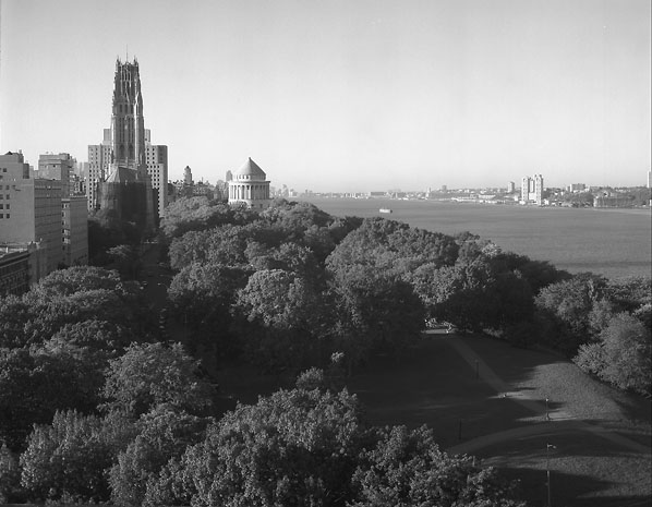

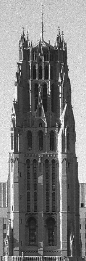

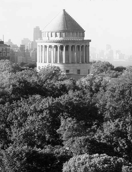

Here's another test shot with just the 75cm cell behind the stop, which normally covers 20x30". I put the two extension tubes on the front threads to cut down the image circle a bit. This is at f:83, 32 sec., medium yellow filter, 4x5" Polaroid Type 55 developed normally for 20 sec., scanned at 1000 dpi from the neg (detail at full resolution), and I used about 15mm of rear rise on my Sinar 8x10" P with 4x5" reducing back, lots of rail, and a second rail clamp so I could use two tripods. In lieu of a shutter, I just pulled the Polaroid envelope and pushed it back in after 32 seconds.
It's got a bit of a glow--definitely not as sharp as a modern lens (okay, I'm not usually using modern lenses past f:45, but I normally wouldn't have to either), but not a bad look for big negs destined for contact printing.

These are awesome shots Dave, I especially like the skyline in the background, in relation to the subject architecture.

Thanks, Dave. I'm just amazed that these simple tiny lenses work as well as they do.

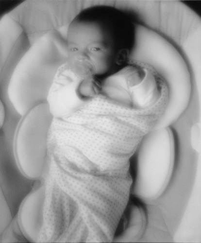

So anyway, the Busch Vademecum comes normally with a barrel that has a 19mm maximum aperture, but the cells are 34mm in diameter, and the Copal Press #1 has a maximum aperture of 30mm, so that makes everything about a half to a full stop faster. At longer focal lengths, that's a very usable extra stop. At shorter focal lengths, it becomes an interesting soft focus lens at the new maximum aperture.
The attached image is with the 205mm wideangle combination (the soft focus effect is stronger in the wide configurations) with a 45cm cell in front, 35mm cell in back, f:8 (around 26mm aperture), 1 sec. (isn't Melchior a fantastic baby who can hold still for long exposures!), Polaroid Type 55 print scan, Sinar 8x10" P with reducing back, window light. On my monitor, the print has more light in the shadows than the scan does. If you want to see the neg scan, which bears a closer resemblance to the print than the print scan, go to http://www.echonyc.com/~goldfarb/who/21.htm

Unfortunately, I see vertical streaks in the sky. Could that be the coating defect we have had posts about here? I doubt if that is a processing defect knowing you, but it could be a scanning artifact. I was just wondering.

In the first shot posted, that's a scanning defect. Eventually I have to figure out how to clean up that old Duoscan, but I'll probably just buy a new scanner by then. The second shot was also scanned on the Duoscan from the neg. The shot I just posted was a Type 55 print photographed on a copy stand with a Coolpix 990 and window light which results in a little uneveness, but one of the flash heads that I usually use on my copy stand just shorted out, and I have to have it repaired.
