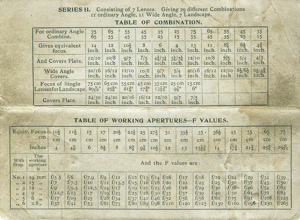

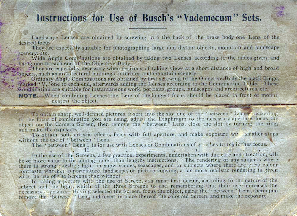

And thinking about it several years later...
I have lots of better lenses (either sharper, contrastier modern lenses, or more interesting soft focus portrait lenses), so I don't use the Vademecum set so often.
Whenever I think maybe I should sell it, though, I remind myself, mainly with the 11x14" and 7x17" cameras in mind, of how light and compact it is, and that it offers some long focal lengths that I don't otherwise have with really big coverage.
Here are the instruction sheets--
