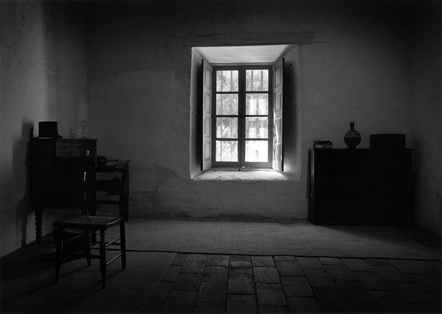

Here's a simple example of mine below. Overall print exposure was at grade #2, but the window was blank white without any outside detail. There was window detail in the negative, but it would have made the rest of image too dark if I extended the base exposure long enough to bring it out. I wanted to burn in the outside details without making the window frame or the shutter doors too dark. I cut a hole to match the window shape in cardboard ( about half the size of the image on the print) and held it a few inches above the easel while burning in the window with a #0 filter (after the base exposure has been made). Important to keep the cardboard moving slightly during exposure to blend in the difference.
I then did some more burning-in of the ceiling area, floor and lower corners with #3 and #4 filters to darken those areas a bit.

Not surprisingly, the choice of filtration for the burn will affect the contrast of the burned area.
Sometimes, you want to decrease that contrast - which usually brings in more detail across a wider range of negative densities.
Sometimes you want to increase that contrast - which brings in more delineation across a narrow range of negative densities.
In jimjm's example, the range of densities in the window area was probably quite wide, even if it was all crowded into the highlight recording shoulder of the film. So a low contrast burn restored a lot of information and put it on the print.
It is often quite rewarding to work counter-intuitively - burn with a high contrast filter in what appears to be a detail deficient highlight area, like bright clouds in the sky. That can have a really nice result: adding contrast to that part of the image, which means that there is added form and shape to the clouds.
Matt, that's a good explanation. Years ago when I got my Zone VI VC head i noticed if i used the soft light i got overall added density in cloud highlights, but not detail...... I stumbled on using the hard light for less time and got the effect i was looking for in the print.
Thanks for the clarification, Matt. Yep, the lower grade filter usually just adds density to the highlight and higher grade filters can add "weight" to the darker details of the same area to give more contrast. It can be a lot of trial and error, but I've had quite a few Eureka! moments in the darkroom.
