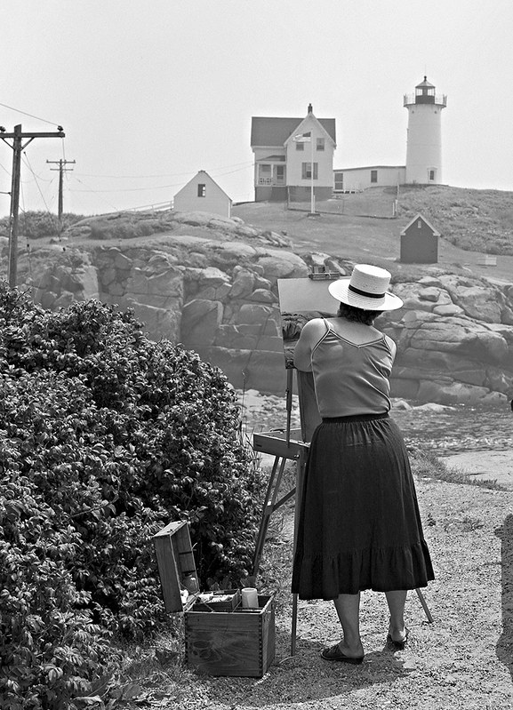

Below is a photo of the Nubble Lighthouse submitted to Photrio a while ago by ColColt (David Fincher). ColColt has not posted to Photrio in five years, so I can't ask him the following question, so I'll ask you:
How did he create a high-contrast foreground and low contrast background? If he used a mask, he did a great job because the detail of the bush and the outline of the woman are contrasty with sharp edges, so alignment must have been perfect. Although the power-pole on the left is half low-contrast and half high-contrast. I could not have come close to this print using burn/dodge cut-out cards.
Or was this a hazy day?
Mark Overton
MattKing
Apr 24, 2005
52,879
Delta, BC Canada
Don't discount the possibility of this photo being shot with a long lens on a hazy day.

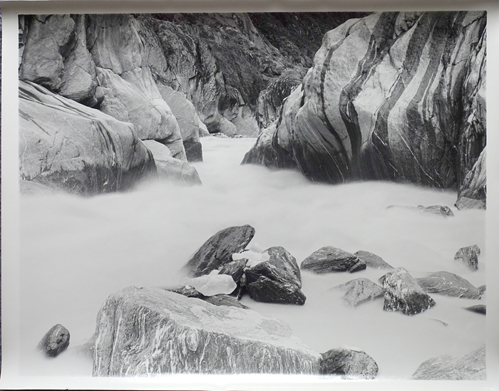

I had my own way of printing my 16x20 prints from 4x5 negatives. More for the enjoyment as a way of creating than anything else. Test strips and a full-size work print got me to the base exposure and contrast (graded paper), and importantly, a good look at the image itself and where I wanted to take it. I rarely dodged, but my base exposure would be on the light side with the idea to eventually bring the whole print up through burning. I had to be careful at this stage and not abandon an image because it has not rung true yet...most did but some needed to be coaxed out.
I saw the white paper below the lens of the enlarger as a slab of marble that became darker as I chisled deep into it with light...I used boards with a hole to chisel (burn) small areas at a time. My base exposures were often around 20 seconds and I had that on the timer. I would then perhaps do edge/corner burning, then spend the next 5 to 15 minutes hitting the timer button and continously burn in 20 second intervals. I would process the print thru the fixer, take it out of the darkroom and study it for several minutes, plan my next changes, then go back in the dark and print it again...and repeat as needed over a period of ten hours, give or take a couple hours. What a joy! I don't think I'd actually recommend it to anyone.
This print took a light touch. The negative was exposed with a red filter to lengthen the exposure (very little color in the scene) and I thought of trying to bring the water and the rocks close together in feeling when I made the exposure. The speed of the water shooting out from the base of the glacier behind me said otherwise once I got into the darkroom, and I enjoyed working with the negative and image to make the print.
