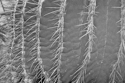

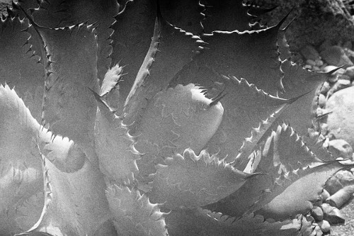

Thanks Bill. I'll try that, too (so far I am having a lot of fun playing around with this old spool of film!). I don't have a spot meter, but used a macro lens and my DSLR's internal meter to do the measurements, which I am fairly confident in. I did some test shooting and think that things are in the right ballpark. Although a little grainy here on the scans (possibly due to the scanner? I'll know when I have more time to spend w/ my enlarger), here are a couple quick shots I took with the film, both at 50 & pushed to 100.

I am sure your meter technique is up to the challenge.
Scanning can make negatives look grainier than they are, a major reason to avoid talking about it here.
But yes, that fog contributes a lot to graininess and will be a central "look" that you get with this old roll of film. Something to embrace and expect.
Looks like you might not have used enough chemistry liquid in the tank for the full view agave... Do you use Patterson plastic tanks? They take more than a pint to cover two rolls (always for some reason, the top roll slips up on the pipe)... So always use enough developer to fill the tank completely to avoid the "top half under-developed" look.
