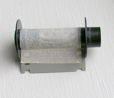

I used to bulk load a lot and just like David above, I used ordinary masking tape. You want the tape to hold as much film as possible to add the strength. Attached is the picture showing the tape holding the film on both sides and firmly squeezed. It never came out even pulled hard with my manual film advance.
