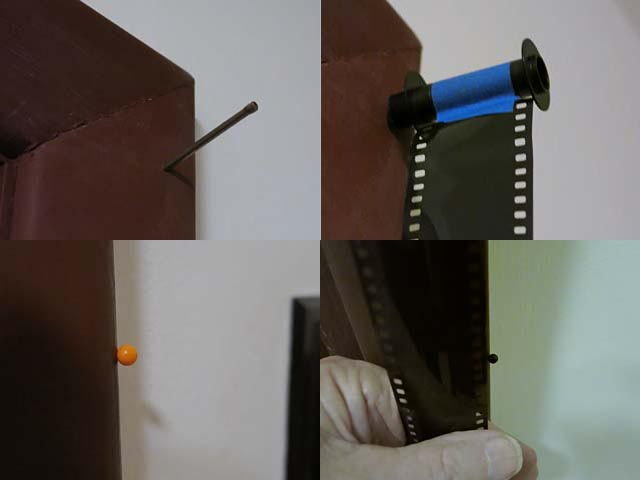

What I did way back when as a kid, handling film in my bedroom closet:
Install a 4-penny finish nail in the door frame up near the top.
Place some markers along the door frame -- shown here are ball head thumbtacks.
Tape end of film to spool (I use more tape than shown here!)
Hang the spool on the nail and gently unroll the supply to the desired length marker.
Snip the film with scissors.
Roll the film onto the spool.
Place it in the cassette.
(Note that in real life I try to avoid dragging or contacting anything against the film.)
I resurrected the method in the current darkroom several years back when I found myself the recipient of a 100 foot roll of Panatomic-X.
