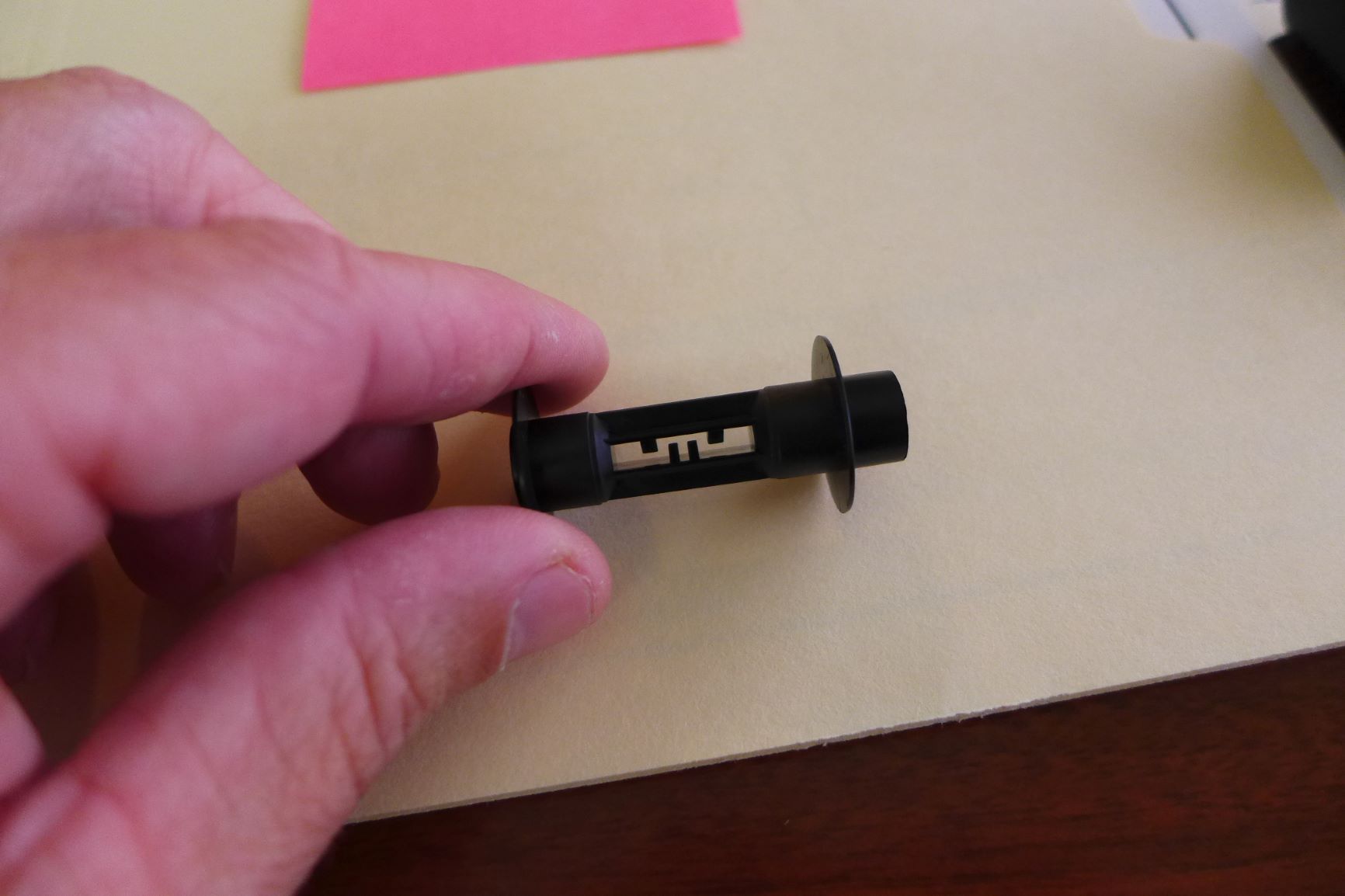

I have recently started bulk loading 35mm B&W. I had been taping the film to the cartridge spool, but I have a hard time feeling the resistance at the end and usually pull it loose and have to unload the film from the camera spool in a dark bag.
The cartridges I bought have a slit in the middle. Should I try to cut the film on both sides to fit in the middle of this slit, or will it still just slide out? See the pic below...
Also, does anyone have any suggestions for how to minimize the lost shots next to the spool? I don't think I can line up and start the spool in total darkness, so I lose those first few shots every time.

Go with the tape around the spindle, by this taping the emulsion side too.
Well, that's common sense... which I evidently don't have, because I did not do that. Thank you!
I usually use 2 strips 2" of tape that cover the sprocket holes to secure it to the spool. In the winder I make sure the tape is attached by manually tighten the tape on a few inches of the film and secures to the emulsion side . Have had very few that were not bound properly and released in the camera.

I take about 7 cm of medium width masking tape, put 2.5 cm on the emulsion side of the film, wrap the tape around the spool and put the remaining 2.5 cm on the back of the film.

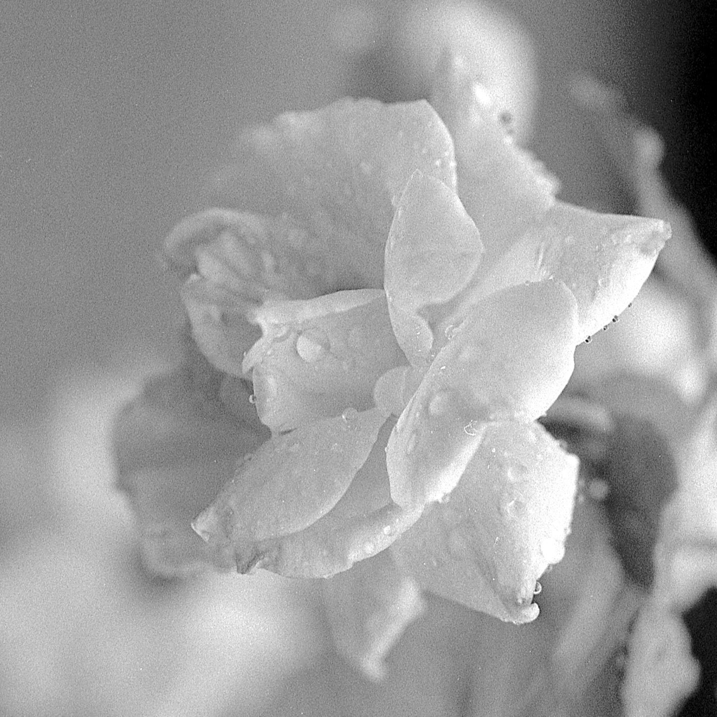

My mistake was not taping both sides of the film, it seems. In order to learn, my first roll was Ultrafine Xtreme 400, which was pretty cheap. However, my results were very flat. I could not pull out any more contrast in the scan. I used HC110 dilution F. Does anyone know if one of the stronger dilutions of HC110 will give more contrasty results? The pic is below, with the best contrast I could give it. I have kept notes for when I want no contrast, but that is not what I was hoping for in this first test roll.
When I used HC-110, I used dilution B and replenished after each session. Stored the working solution in a 1 gallon amber glass bottle. If you use it weekly and keep it replenished it will last for years properly cared for. Great developer, should yield beautiful negatives. Don't use high dilutions with Rotary-Tube Processors. Not enough activity. For Jobo I would use dilution B one shot. Or XTOL or D-76 straight, no dilution.
I will give dilution B a shot. I use the concentrate and discard after each use, because I doubt I can use it all before it expires. Dilution F is 1+79, which is insane and will develop tons of rolls, even with all fresh mixtures.
Are you using at least 480 ml of working solution F in your tank? If not, you are probably seeing the results of developer exhaustion - Kodak recommends a minimum of 6 ml of syrup per roll.
Where did you get times for dilution F? If times come from the Massive Development chart, they aren't particularly dependable.
I used HC-110 for years - both one shot and replenished. I ended up liking Jason Brunner's 1 + 49 dilution, which is effectively the same as dilution E.

I've found that with regular adhesive tape (Sellotape, Scotch tape) there is a chance that the film can be pulled off the spool especially by cameras with motor drive.
I've taken to using 16mm film splicing tape, as it seems much stronger but isn't too wide.
Exactly this. I use plain and simple masking tape, the kind that is used for painting around the house. Works perfectly in all my cameras, manual and motor wind alike.
FWIW, the "painter's tape" comes in a number of forms. The (usually) beige coloured stuff is designed to stick and stay stuck, and is perfect for bulk loaded film. Some of the coloured stuff (usually green or blue) is designed to stick very lightly and release easily, and is not suited for bulk loaded film.

For 35mm just use white artist masking tape. Never a problem. Something like electrical tape may become too gooey.

A 3" long piece of 1/2" wide 3M masking tape, around the spool and then equal remaining amounts on each side of the film, and never had a problem bulk loading hundreds of rolls this way.

I use 1/2 inch wide Scotch tape from my teacher dispenser. Both sides of film get taped to the spool. This works quick for me as I have 30 rolls at a time to do.
