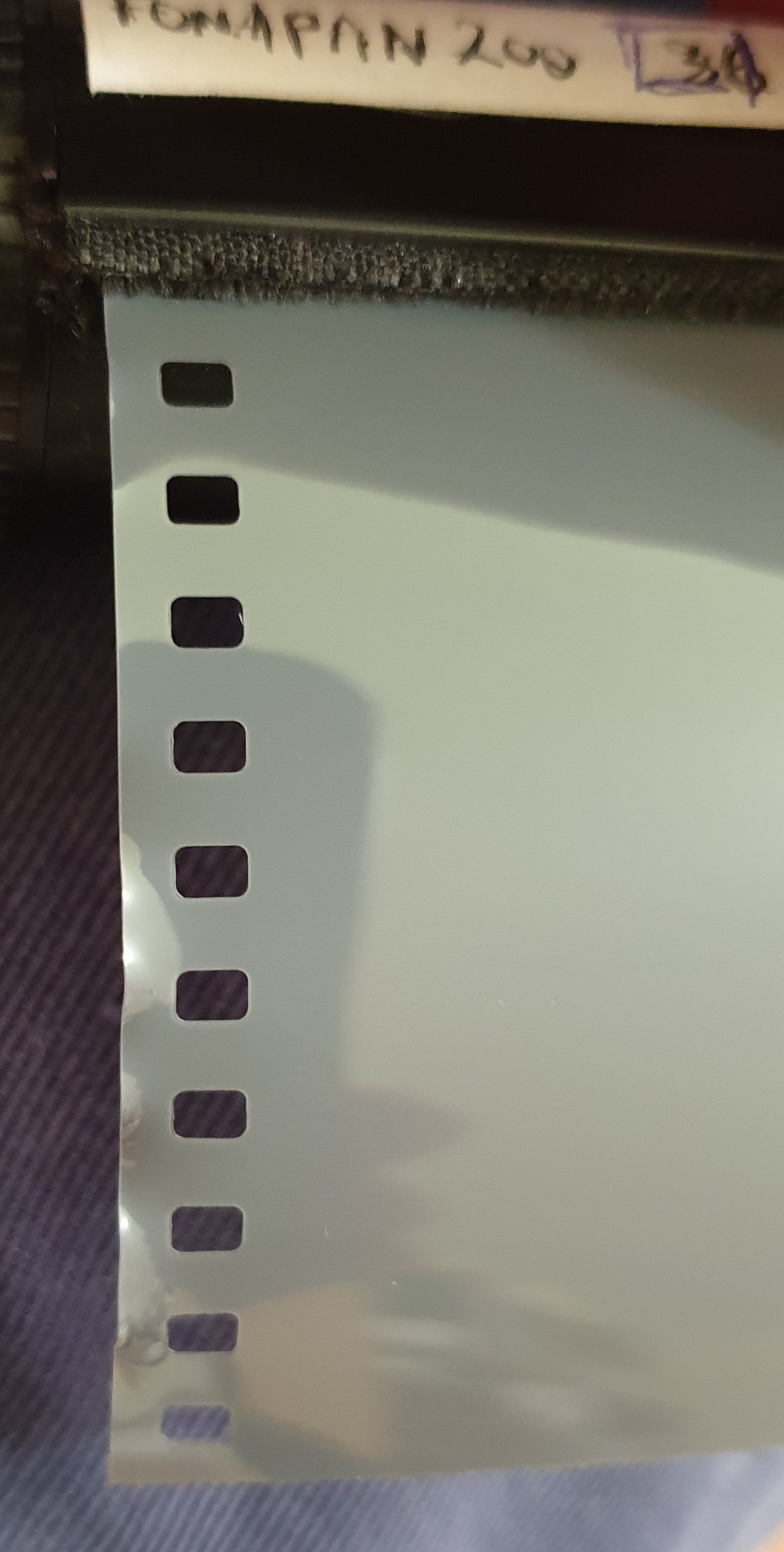

I'm using a Daylight/Lloyds type bulk loader today, one I've used several times before. I have a 100 foot roll of Fomapan 200 in there bought a few months ago and from which I had previously rolled four cassettes without issue. Today every time I try the film is crinkling at the edge and getting very difficult to turn - indeed I have damaged the winding key.
I am using a plastic cassette which I've also used before, albeit possibly only once. It's nearly new. I'm also using 16mm splicing tape to attach the film to the spool - again my usual modus operandi.
Has anyone experienced this? Is there something wrong that I can fix? Photo attached to show what's happening.

The crinkle artrefact is only at one edge, not over the whole width. From this you should start deducing.
Yes only on one edge. I've tried three cassettes and opened up the loader (in my changing bag) and can't ascertain anything is wrong. The film doesn't pull out of the loader as easy as my other similar device loaded with HP5+ but it's not difficult to pull.

If this is an old lloyd style loader I would take the film out of it and look the felt seals over really well. I had to replace the felt on both of my lloyds loaders. The felt was starting to peel away and grabbing the film. Try moving it around with your fingers to see if it is loosening. Try the film in the loader that currently has HP5 in it and the HP5 in the loader you had a problem with. See what happens.......

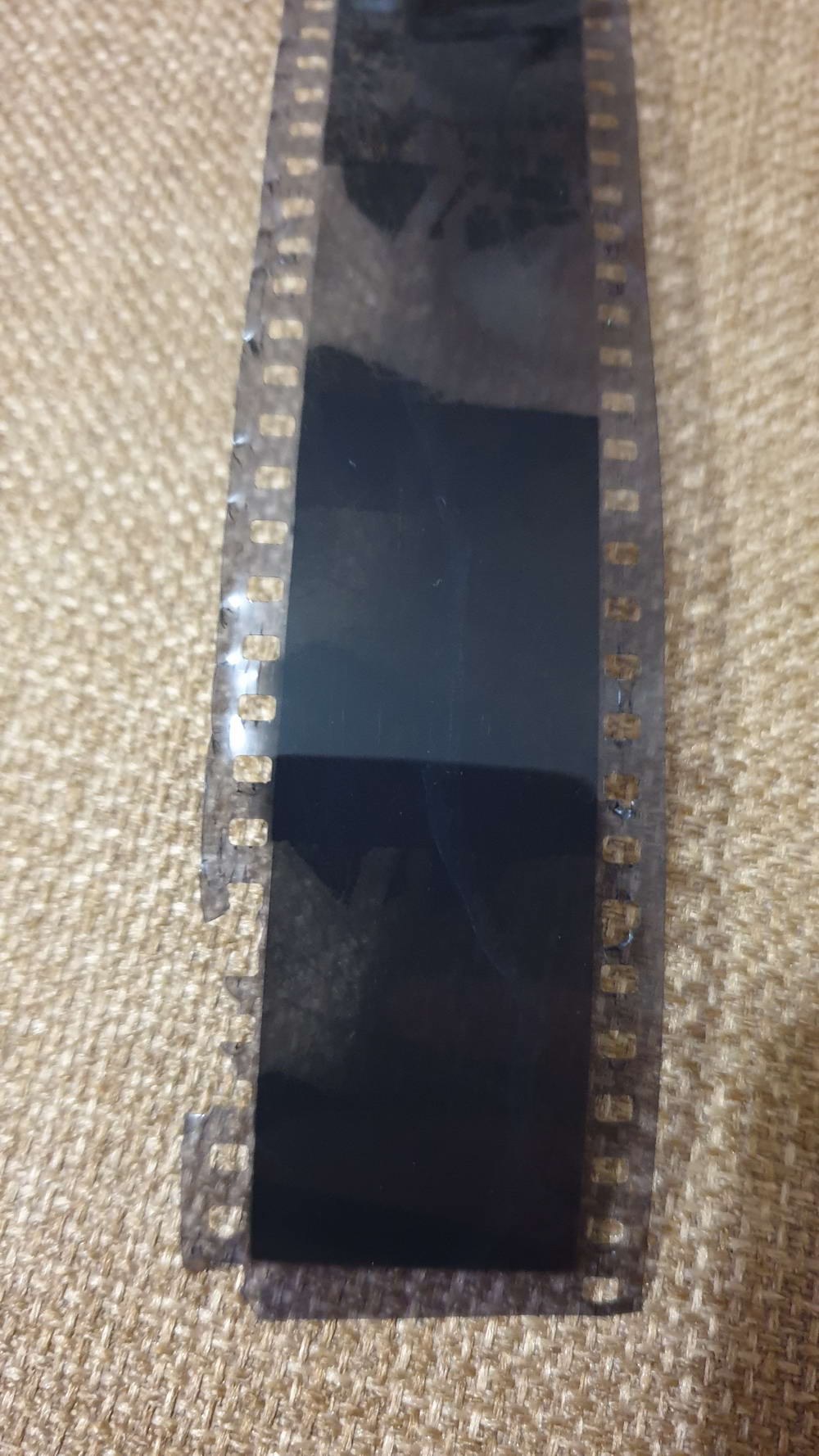

Revisiting this. I haven't yet managed to swap the Fomapan into another loader, but I did have another go at rolling some films today. I was able to load a 12 exposure test cassette without difficulty, so I then rolled two 36 exposure cassettes....each was more difficult than other films but not so difficult that I damaged the winding key.
Howver, the 12 exposure test film went into the plastic cassette OK but when I ran it through a camera today (known to be working) I did note that the winding of each frame was *very* stiff, I could feel the film tugging. Upon rewind the film actually broke going back into the cassette. I developed what I had, and the sprocket holes on both edges are damaged but one edge especially. There is also a lot of scratching across each frame (horizontal if looking in landscape).

Try placing a very thin spacer, like a circular piece of thin cardboard, under the bulk film roll to push the film up further. There may be a casting defect in the throat of the bulk loader that is grabbing the edge of the film.
Also check the throat of the bulk loader carefully; you might have a film chip embedded in the velvet that is hard to see...
