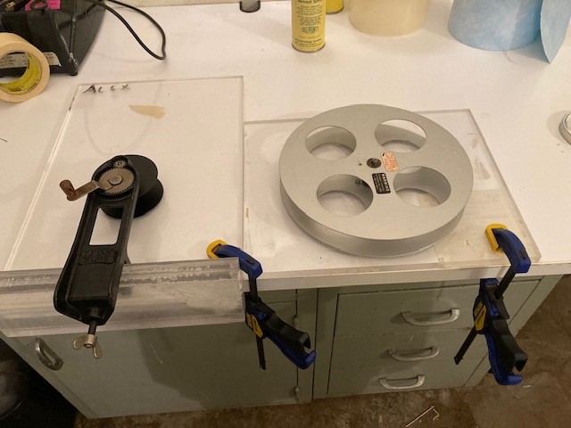

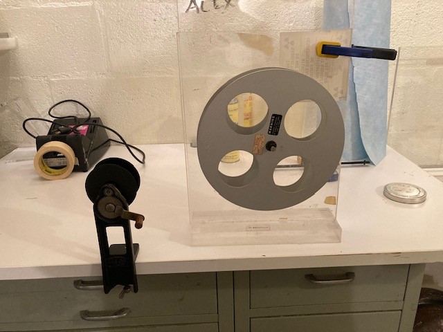

I have a 1000 split reel that I transfer the bulk film to then use a 16mm film rewinder clamped to the bench either onto a 100' reel (microfilm) or core. This can be done flat or upright, but with 1000 feet i recommend upright to eliminate friction from the weight of the film.

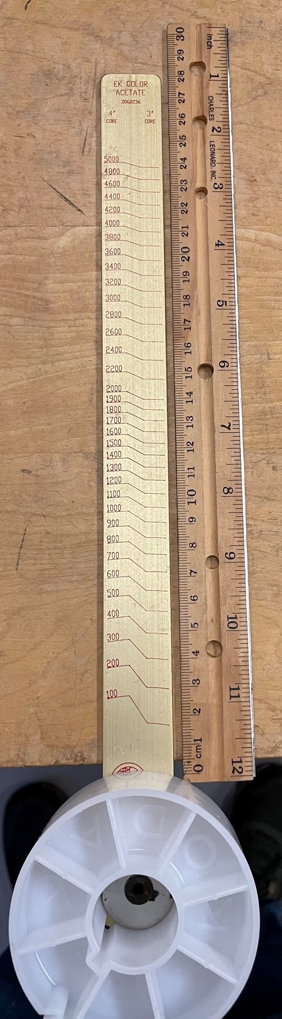

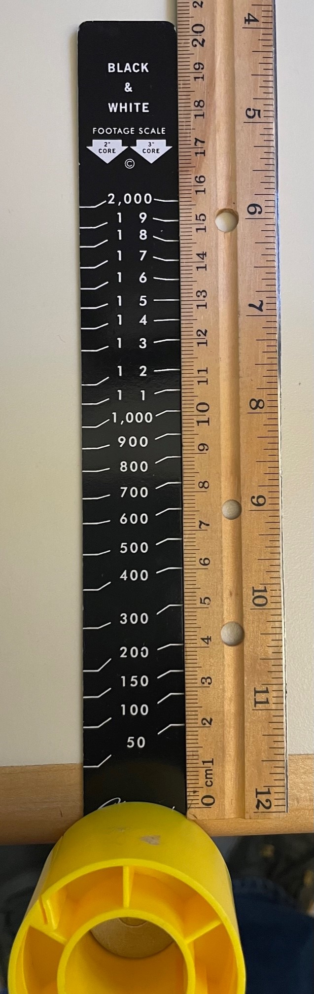

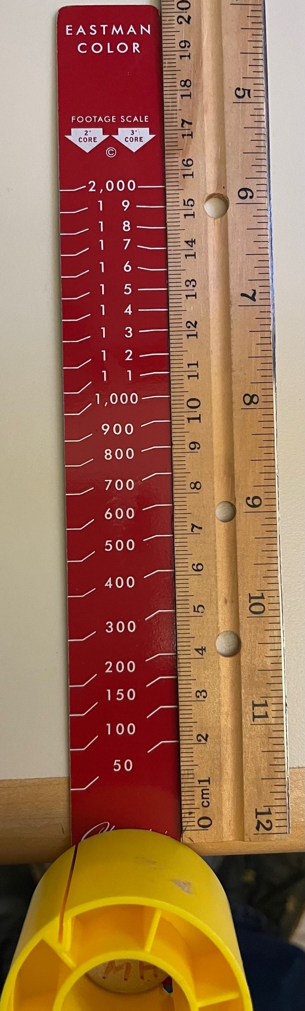

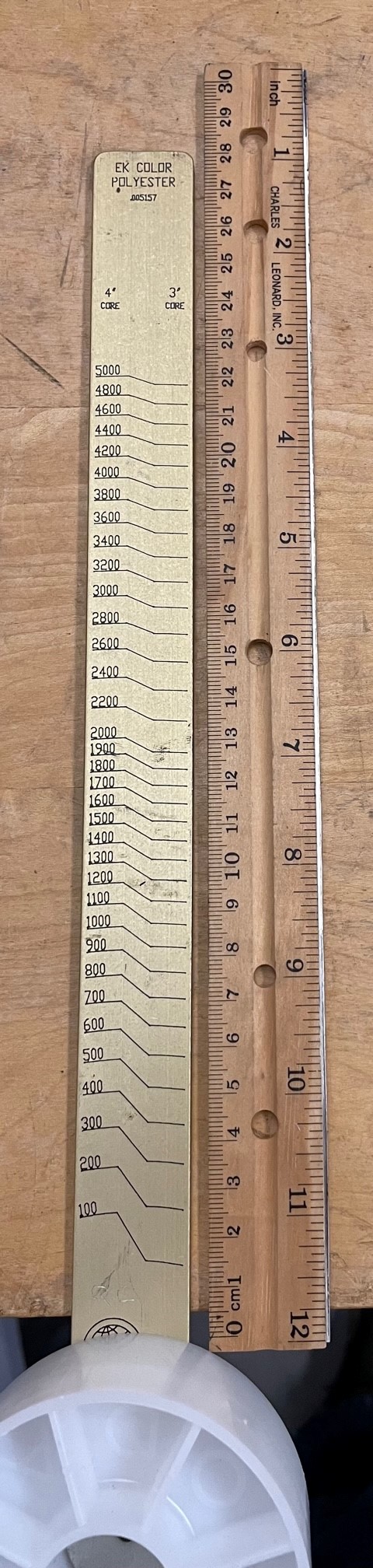

Here's a few shots of film-on-core measuring sticks we have around the lab to help with measurements. One is predicated on 2 and 3 inch cores and the other has a scale for 3 and 4 inch cores.
Click to enlarge. Hope this is helpful...

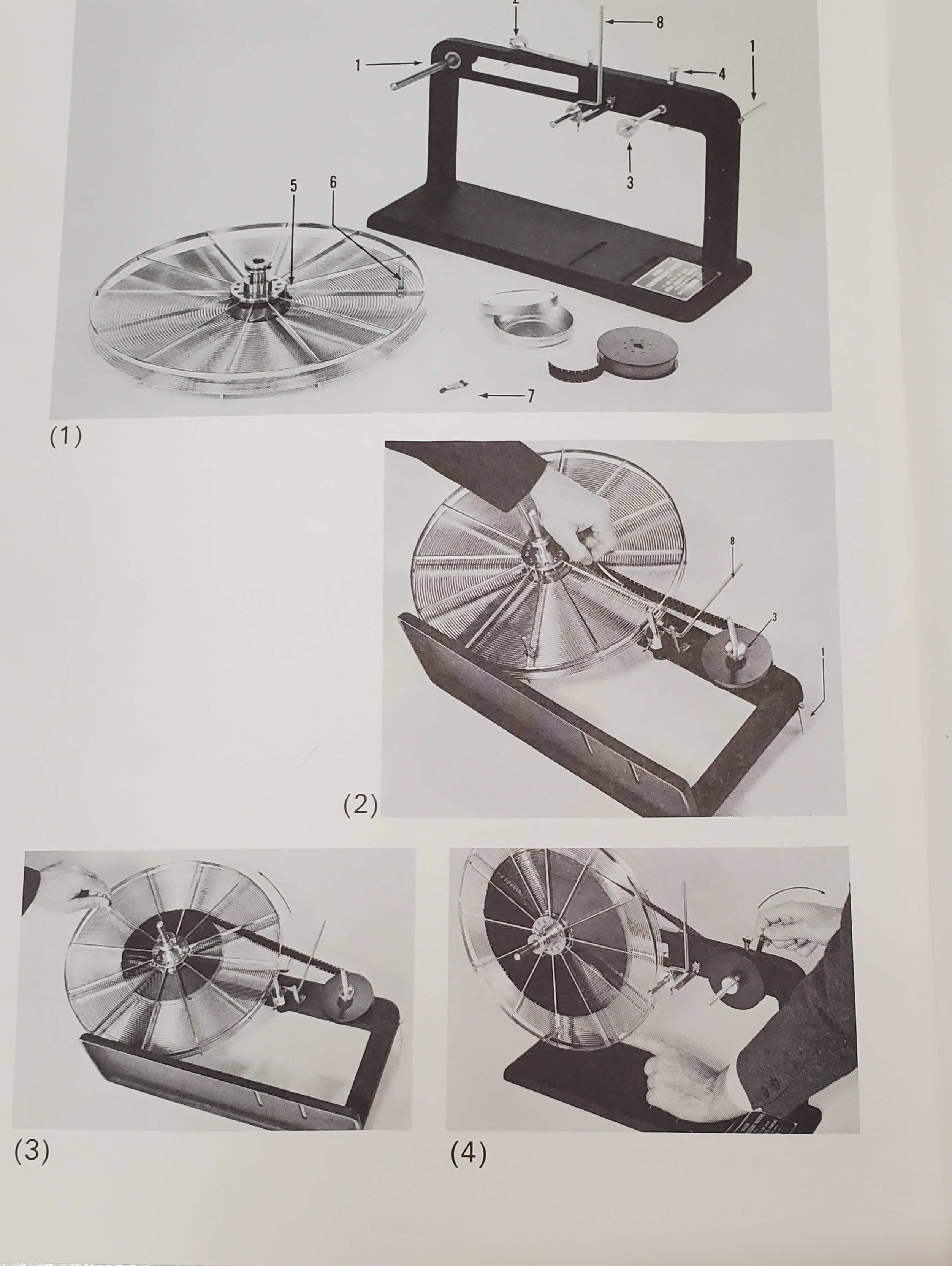

Honeywell Nikor had a Film Processing Machine that would allow the loading of up to 100 feet of 35mm film onto stainless steel reels up to 17" in diameter. You would have to reverse the loading direction.
Kino
Jan 20, 2006
7,908
Orange, Virginia
wow, those are neat!
Yeah, they are handy for quick estimates!
Thought it might be helpful to answer the questions about diameter of film rolls. You can make your own based on these photos; should be close enough for Government work... :wink:
