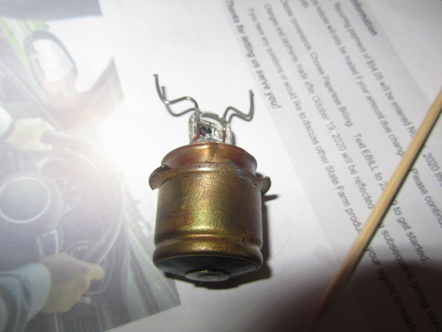

Success! You might say it was a smashing success! That giant bulge on the side was preventing it from turning a full 90 degrees. Now comes the hunt for a bulb that costs less than a projector. :laugh:

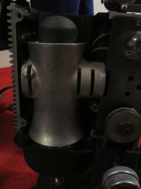

Here is what it looked like before the smash. The heat bulge was on the rear (left) side where the opening for the mirror is, which allowed it to bulge beyond the diameter of the main condenser housing. So it would only turn 45 degrees or less before hitting that housing.

Well I can show you the top and the bottom, but that's all. It has a 1" diameter base and locks in with the tabs as shown above. It can take up to 750 watt but I'd prefer 500. It appears similar to this one below, which I won't buy because its used and they have short lifespans to begin with
