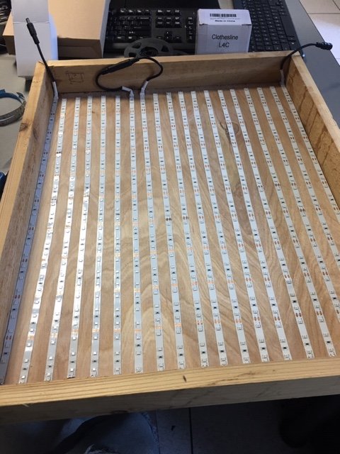

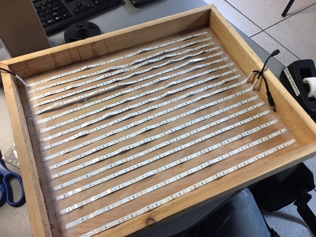

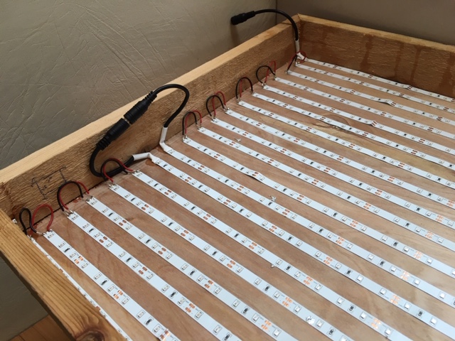

Decided to make my own UV light source for my cyanotypes.

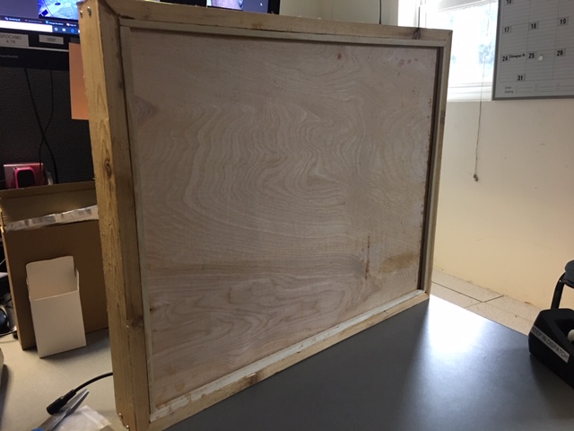

I used some 1x3 cypress scrap wood and cut a 1/4" wide groove the length of the board using my cordless circular saw and a jig. Then cut two 22" pieces, and two 18" pieces with 45° mitered corners. Bought a 2'x4' piece of sanded birch underlayment, cut it to size and placed it in the groove. I then screwed/glued the frame at the corners, and ran a bead of glue alone all sides of the bottom.

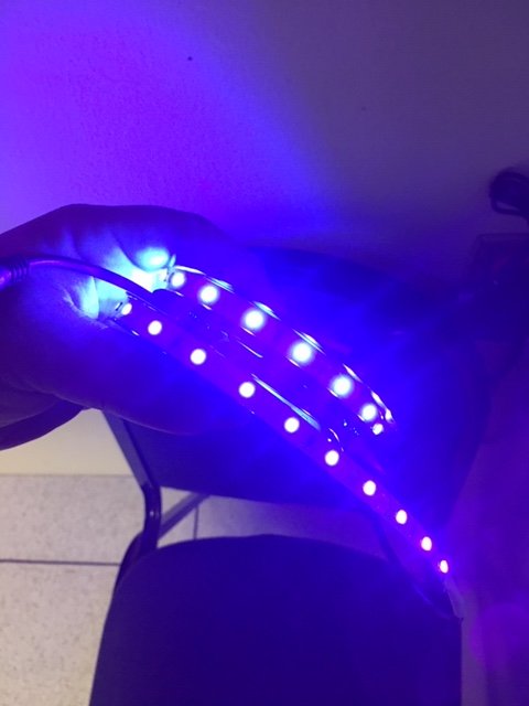

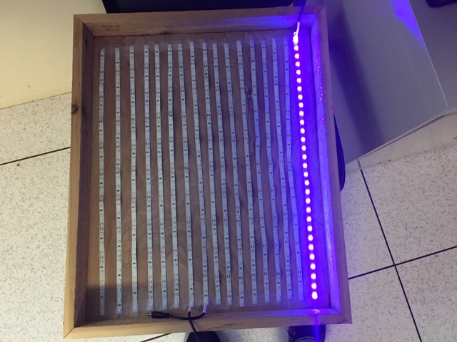

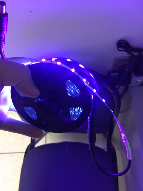

I purchased THESE uv-a blacklight LED strips from eBay. I ordered them on Friday and they were delivered on Sunday. I liked these because they came with the power adapter, and the plug already soldered on. And as a bonus, every tenth diode has solder on the contacts already, which was perfect for my application. All that's left is to wire each section to the other. I have them temporarily taped in place until I figure out the exact width they need to be. Total of 33 feet of LED's, or 600 individual LED's in the box.
Total investment thus far is a mere $30 for the LED strips and underlayment.

I'm wondering how well they'll work. I didn't believe it when I first read that black lights are UV-A. The listing says these are 385-400nm but they're cheap China imports. Hopefully they work.

I've got all the strips measured out and tacked down. Tonight or tomorrow I'll try to get all the connections soldered in place.
You want them as close together as you can get. There's no such thing as too much light in an alt process exposure unit! Don't hesitate to purchase some more leds and put them in. Looks like you can gain around one stop more light on this unit if you put the strips side by side.

Before you tack those strips down you may want to lay down a layer of aluminum foil, shiny side up. That would intensify as well as diffuse.

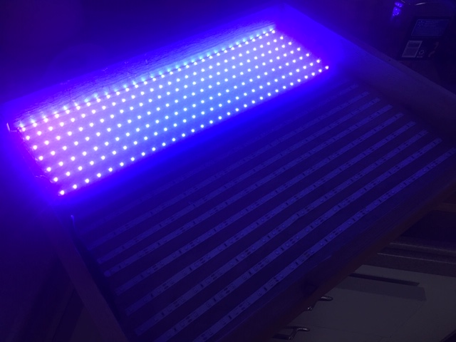

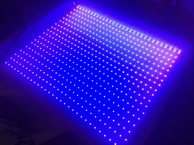

BAM! Looks like I’ll be doing some indoor cyanotype exposure testing today baby!!! Just got all these soldered together.

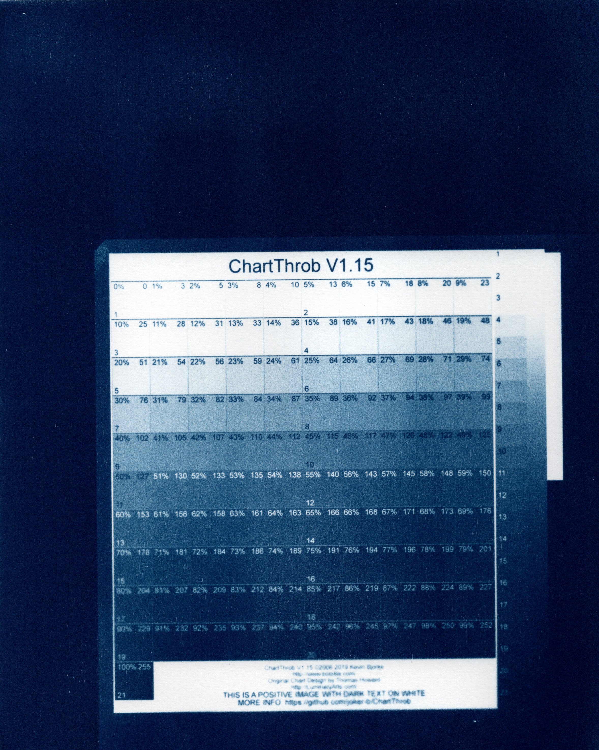

It works! Although the LED's aren't very powerful. I reached maximum black/blue/darkness, whatever its called at 45 minutes exposure time. But at least it's a steady, repeatable, that will give me consistent results.

Well... 45 min exposure may be too much. I just did another print, this time with the new chartthrob curve, and a less contrasty portrait, and at 45 mins it’s nearly completely dark. I’m redoing it now with 10 minute increments.

I was watching a video on youtube today of someone who built their own UV box as well, but he split the LED strips into two banks to prevent voltage drop. After watching this I was tempted to test mine. They're supposed to be 12v but at the end of the very first strip I have a .5 drop, to 11.5v. Four strips down I have a voltage of 10.7, and by the very end of the entire bank I've got a reading of 9.5v.
This is at the least a 2v drop, or at the max a 2.5v drop.
I'm wondering if this is enough to worry about, and reason to rewire everything into two banks.
The other option is to order two more rolls and fill in the gaps, and start the bank opposite of the one that's already installed, to balance everything out.
