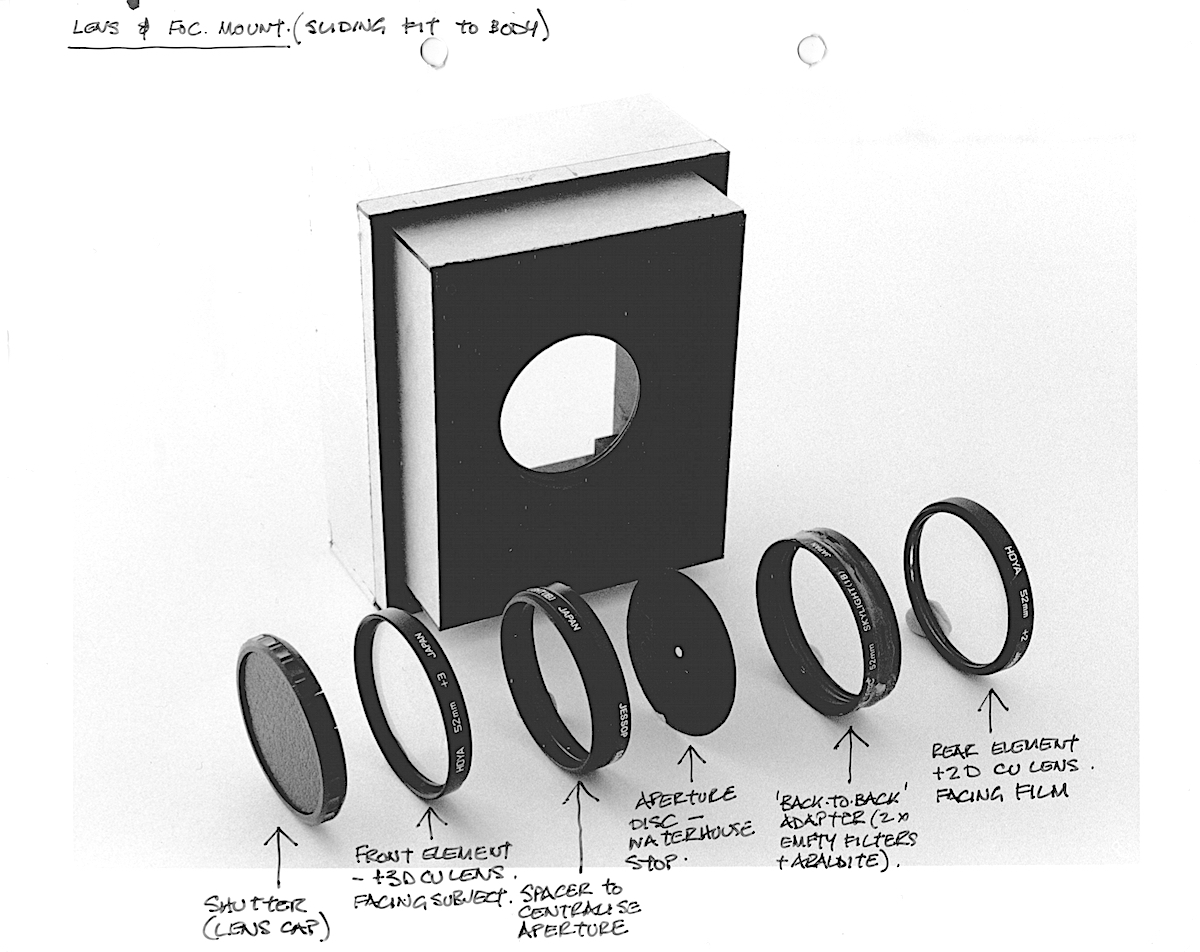

I have built a few cameras over the years and my most successful lens was made from two close up lenses mounted back to back - see images. Mine were 2 dioptre and 3 dioptre so it is advisable to mount them with the stronger lens to the subject and the weaker to the film. Film in my case was 8x10 Multigrade print paper.
I made waterhouse stops out of thin brass sheet and Araldited various filter rings together to make the mount. I duplicated the spacers to centralise the stop. Maximum aperture was around f8.
I include an image made with the lens.
Hope it might be of interest.

Thanks! I actually have two close up lenses here, a +1 and a +2, to experiment with. What is the distance between the lenses in your build? That is a very nice picture you have taken with it!
I don't think the distance isn't too critical but mine were effectively four filter mounts apart, roughly 1cm I guess, with the aperture approximately central. I think with a 1 and 2 dioptre combination the focal length will be longer. The results can be remarkably sharp, but the negative was 10x8 and so not too much enlargement is needed. It might be a little less crisp with a smaller format and I was using a smallish aperture. There would be be much more fall off of definition at wide apertures which would suit a less record type of image than mine..
A diopter is an inverse measurement, equivalent to 1/f with f the focal length in meters. That is, a +1 has a 1000 mm focal length, +2 has 500mm, and so forth. Diopters are used because they're convenient for calculating lens combinations; just add the diopter strengths before converting back to focal length -- a +6, -4, +2 triplet would have a net +4 diopter or 250 mm focal length.
So, your +1 and +2 would give a 333 mm focal length for the pair (maybe a hair shorter if you have space between).
What you're creating this way is a slight variation on the Rapid Rectilinear -- meniscus lenses with flats in place of the concave side, convex out on both ends. There's a formula for spacing the groups in an RR, and you'd put the aperture halfway between when the groups are identical -- it's probably more complicated if they're not quite the same.
