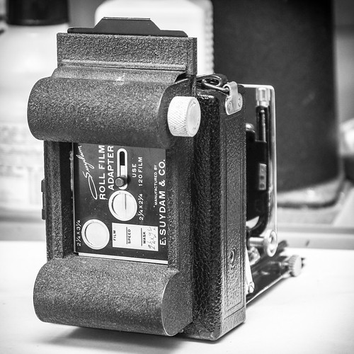

Have a lookout for a Plaubel Peco Junior, they shoot 6x9 with the old RADA film holder. Beautifully made little monorail camera.

You can build anything you like. You might find a 120 film holder/back from a Speed Graphic or Horseman helpful. It might be cheaper and easier to just buy a 4x5 camera like a Burke & James for under $200 (sometimes less) and use a back and lens of your choice.

I had forgotten about the Galvin 6x9. I had one for years, sold it a couple of years ago for about $250. Solid, compact camera. The bail back could easily handle a holder or a roll film back. I used an old Graflex 6x9 roll film back and it worked fine under the groundglass.
