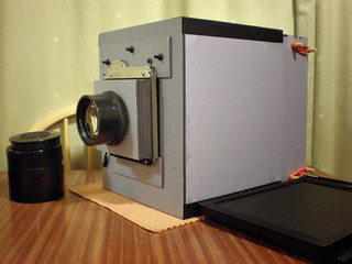

This is my 8x10 build (also posted somewhere on APUG before)
Mostly Foamcore, lens is a 300mm USSR process lens, shutter is an old Sinar I got from Ebay for next to nothing.
