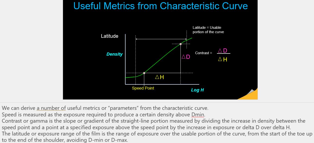

Perhaps this image will aid in your understanding of how to calculate contrast.

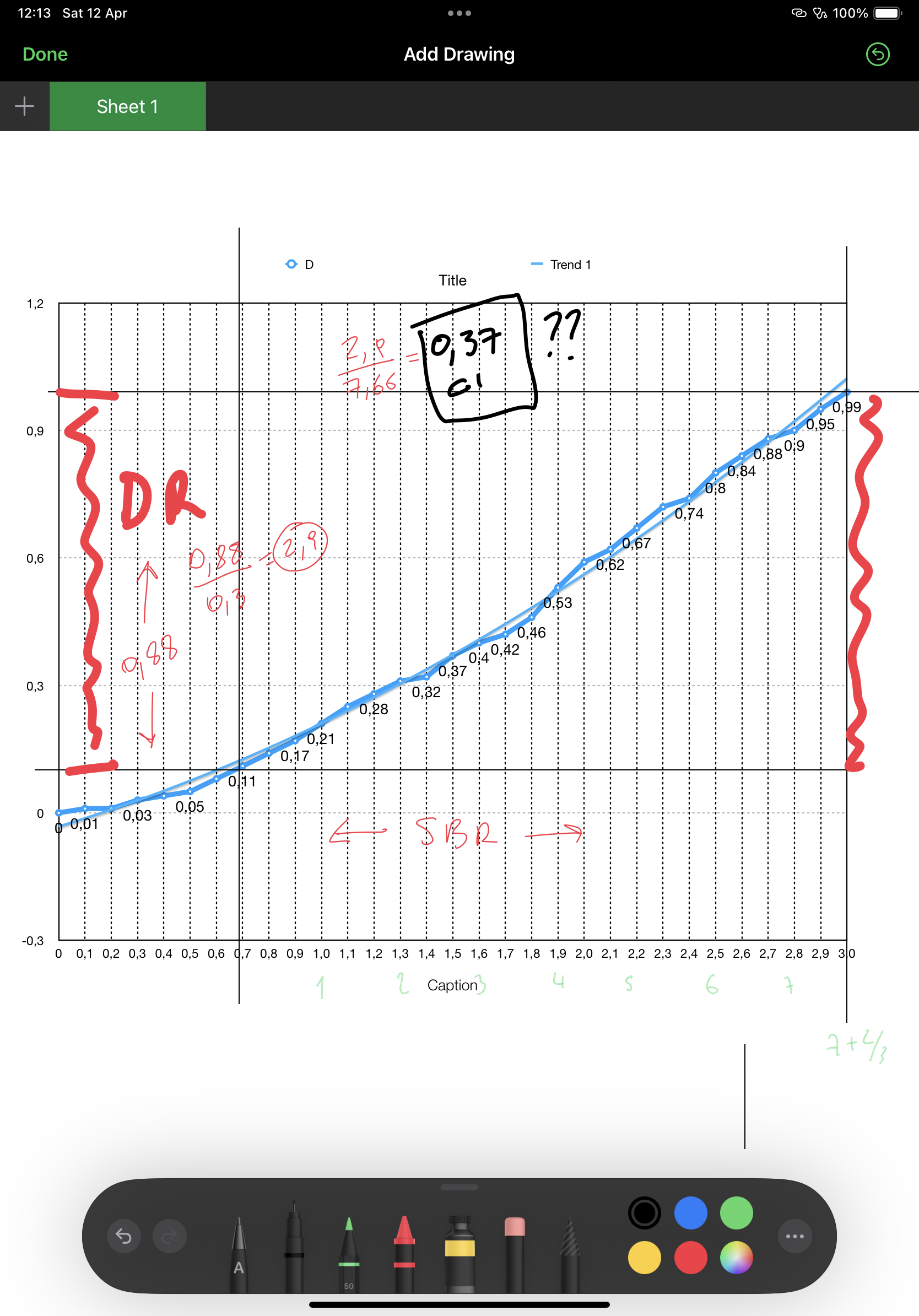

Ok, I did it.. sort of..
I exposed a 35 mm film (hp5) rated at 400 iso against a white wall north faced in an even lighted day. Exposure goes from -5 to +5, ten stops in 1/3 increments. i processed the film in xtol 1+1 at 7 minutes against the 12 suggested in the xtol datasheet for a CI of 0,51.
these is my fist curve, I’d like to understand if I made it correctly. It came out that my CI is 0,38! With a 0,99 LogD at +10 stop and an ISO of 80.
those are very soft numbers, aren’t they?
Have you looked at the Beyond the Zone System method by Phil Davis? There is software that will plot all your data and provide CI, EFS, etc. etc. automatically.
I just got it.. I’m at the beginning chapters. But software apart, is it correct what I did? Reading again the graph, ISO value should be 160 If I start from -5.
While I wouldn't have developed for 7 minutes (unless I was trying to put together part of a curve family), your graph and numbers check.
You got an 0.38 CI
By taking the center of your exposure as the meter point (40 on the film speed scale), and reading where the curve crosses 0.10 above base + fog, you get a speed of 250 the way most people would interpret these results.
By using the Delta-X meter (I used the shifted one), you can see that the effective film speed is 400. This is like using a POTA developer, you have a very flat negative, that you have to print on high contrast paper. When you print on high contrast paper, you can get useful image information from further down the shadows of the toe than you could if the film were developed normally and printed on normal paper.
I'd recommend giving it full development because it's unconventional to try to estimate film speed when it's developed to such a low contrast.
