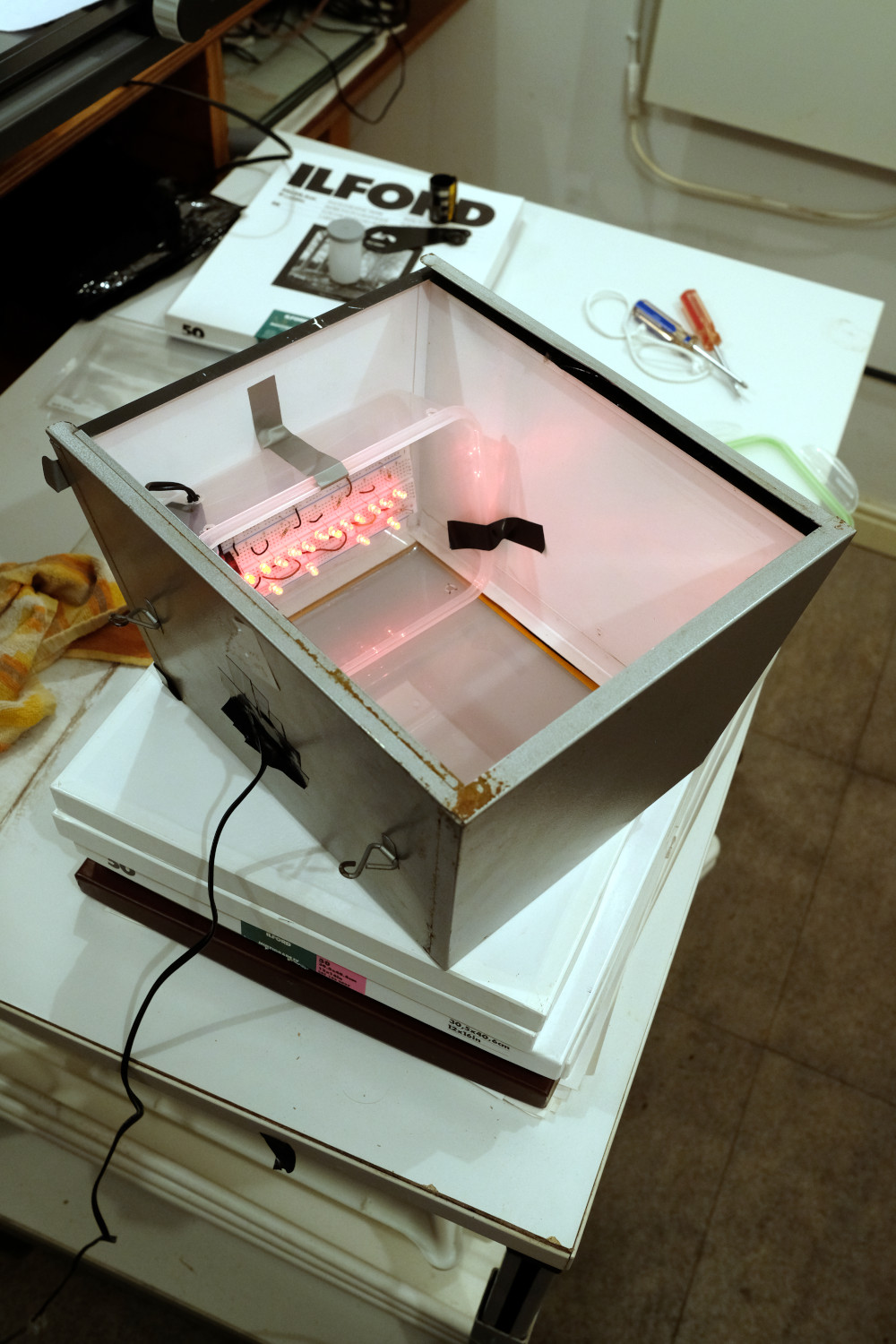

Here is my latest update showing the ILFORD housing with the top '902' off for demonstration purposes.

Tom for clarification: Are these the same 16 leds you had in the transparent box hung by strings from the ceiling and with the Ilford filter over them how does the light compare to the former 25W incandescent?
I have the 902 and recently changed my 15W incandescent bulb for the 25W. While the light is quite a bit better I am now worried that my filter may not now be good enough so your light comparison info will be useful
I currently have the red LEDs installed, whereas the original approach you mention utilised amber LEDs. With the red option the light is much lower. I haven't yet tried the amber LEDs within the 902 enclosure, this will be a next step. There does seem to be a "spectrum of safety" as regards safelighting, with Ilfobrom Galerie at one end and possibly the Foma papers and other fast options at the other.
