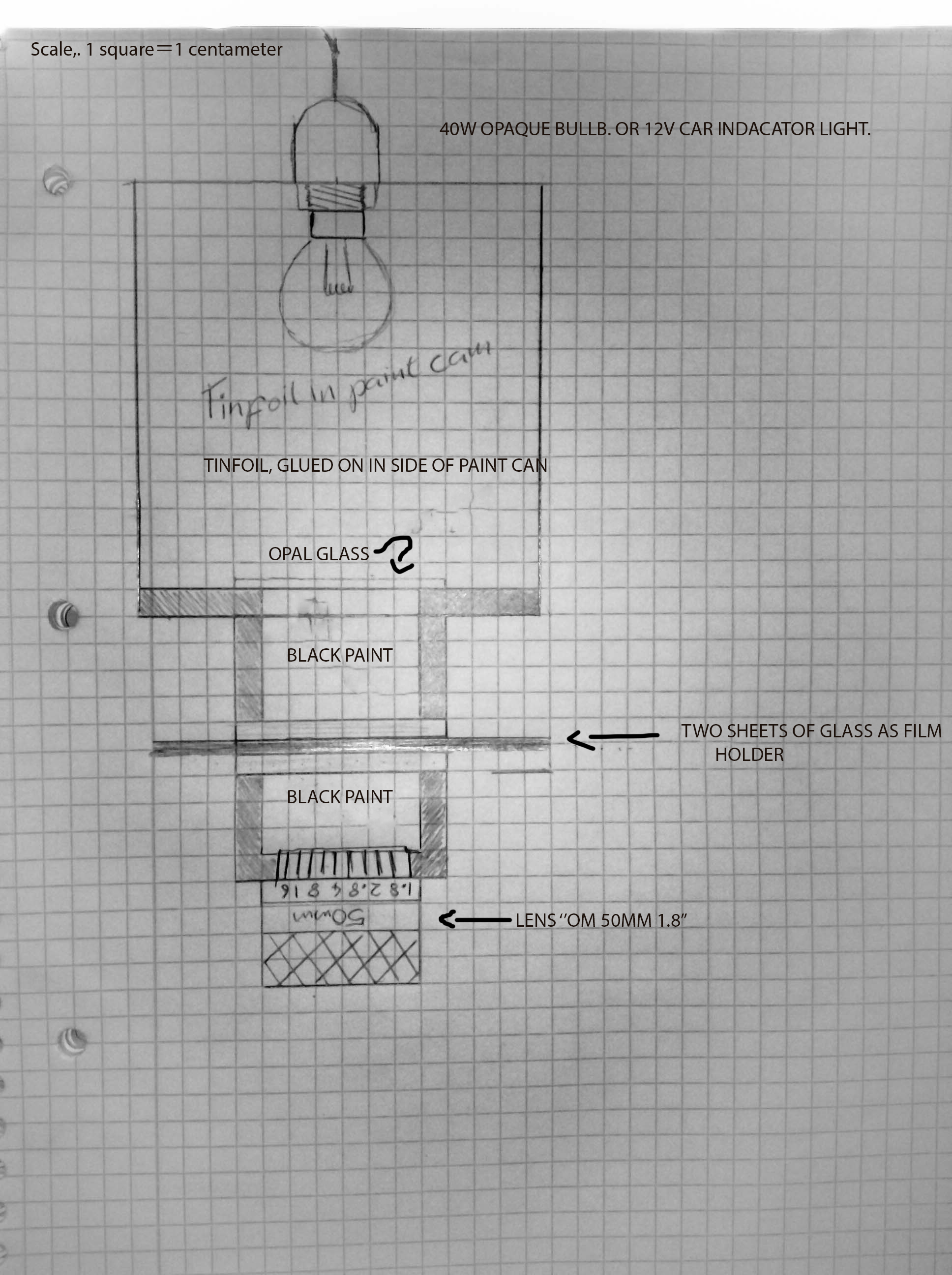

Hi, guys, Been kind of busy as of late, so couldn't get back to the forurm, or enlarger. As true as the car comparison, and some other comments probably are, I think I can handle the giving up part my self:smile:. I feel I've been thinking about making one for so long and never actually doing it, its time for me to at least try and fail. Thats just me. So, I've done a really rough pattern, nothing is measured exactly, but any input would be great, its just a concept, I'm aware that things always seem simple when you don't know how they work. but if i can get away with minor modification to this design il go for it. id imagine the light will leak them the film holder, so il have a thing about that. I see a lot of people are using folding cameras, but why, ''for now I'm just planing on enlarging 35mm'' I'm only planing on enlarging i few rows with it, until i find a good one in Ireland, or i have to cough up for an english one.
attachment.php
attachment.php
I also think you will be much better off using a real enlarger to learn the basics, but if you feel compelled to do this:
- how are you going to mount the enlarger head?
- how are you going to ensure the negative stage is plumb and the entire enlarger is rigid?
- how are you going to focus??
- where is the condenser?
- why not design to use a standard enlarger bulb like a PH211?
tip: using a 50mm camera lens is not a good choice -- you need a lens that is optimized for flat field. A decent enlarging lens is not much money.
You could probably just buy a used enlarger for the cost of a piece of real opal glass. Or get one downright free. But if that design you have in
mind doesn't work quite right, it might be suitable for a moonshine still.

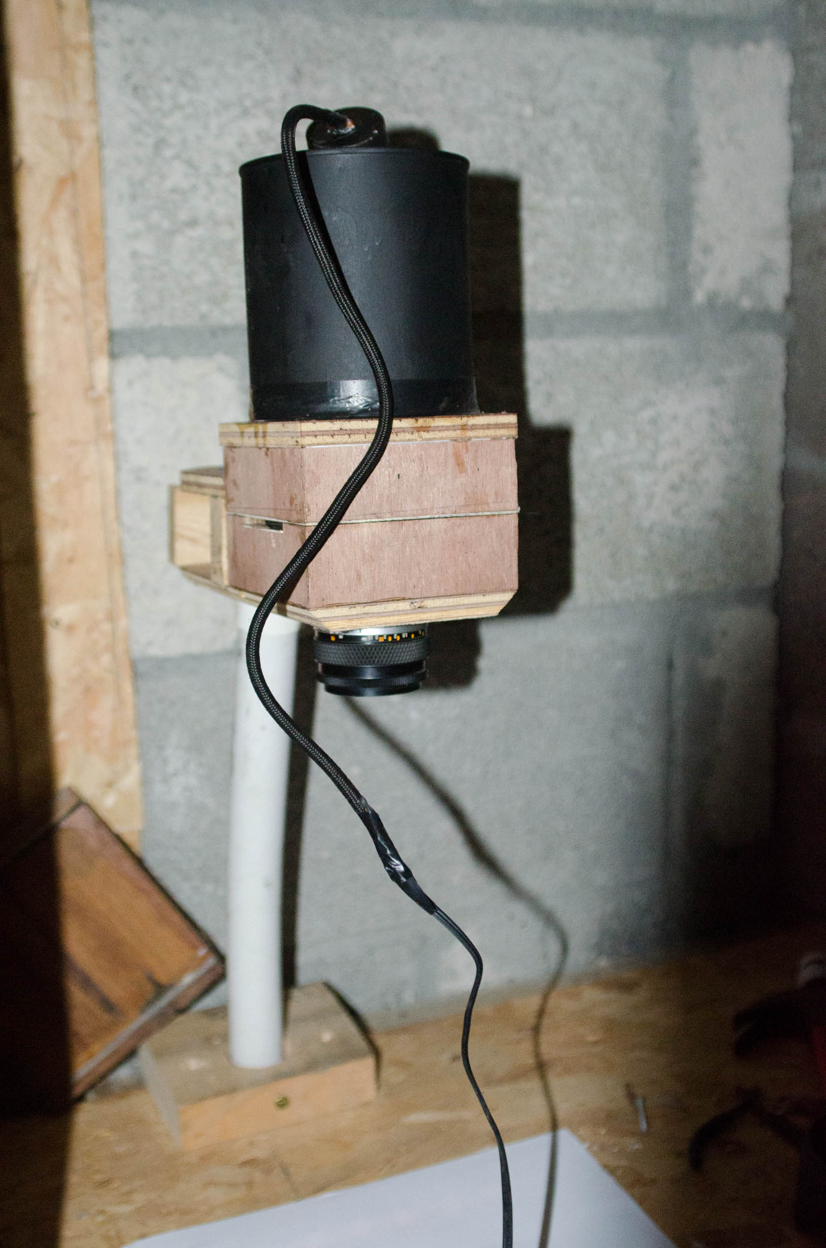

I booted it up for the first time today, And the car indicator bulb isn't bright enough to focus properly,
You can see the image, just not clearly enough with the naked eye.
Tomorrow il try a head light, If that blows my transformer i might use a car battery or switch to mains.
Just a summary of what I've don so far if any one else wants to make a ''Hillbilly enlarger©''Ply wood box then cut in half, and some wood taken out to fit the film, Then glued back together, An old paint tin that i covered the inside with tin foil,
A hole drilled in the bottom of the tin, And the top of a plastic bottle glue in the whole, I then drilled the cap of the plastic bottle, And shoved the wire for the bulb thru,
I used a pice of opaque plastic from a ice cream container as a diffuser ''who needs opal glass any way'' and thats a zouki? 50mm 1.8 mounted on it. So the whole thing cost ''me'' $0.000
Seeing that it was made of scrap, And bits of stuff lying around, I still have to get a print out of it tho, So I'm not out of the woods yet. :smile:
