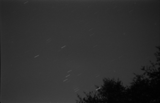

I developed some images yesterday, and scanned them today, taken with a fixed camera -- "star trails" -- and it seems to me there are other limitations on exposure time, at least when shooting from my yard in town. I found the sky background at EI 800 was quite bright after only a five minute exposure at f/8 (even with the relatively poor reciprocity failure characteristics of Tri-X); five minutes at f/2.9 was enough to render the sky nearly as bright as in a normally exposed daylight image. So, I'll either need to stop down a good bit (like to f/16) or shoot at a lower EI, or both.
My next experiment with this will likely be with my Zeiss-Ikon 250/7 Ideal plate camera -- not only will I get a much larger negative, but I'll be able to use ISO 100 film (I don't have any 100 speed film on hand for 120 or 35 mm), and stop down, if I choose, to f/45. And, of course, I can shoot and develop individual frames instead of dealing with a roll format. That will be much better for trails -- the trails will be longer if I can expose for, say, 20 minutes without the sky background starting to compete with the star trails -- but also suggests that tracked images could be effective with as little as five minute exposures, which is well within the capability of a single-arm barn door mount.
So, perhaps I can get some wood and make a mount sometime soon.

What I've found so far is that five minutes is near the practical limit with Tri-X pushed to EI 800. I need something that will put the sky glow farther down the reciprocity curve than the stars to keep them separated; I intend to try on the next clear night with Fomapan 100 through an f/4.5, which ought to let me use exposures up to 20 minutes without sky glow being too intrusive (though ten minutes would be more comfortable in terms of trying to print down the sky without losing the fainter stars, at least for trails). Of course, I can also stop down, but that will tend to lose the fainter stars due to reduced aperture. Also, the night I took the test shots (including the one I attached a couple replies back) might not have been the clearest in terms of transparency, nor was it much more than an hour past dusk at the time I made those shots; I can probably do a bit better on the clearest of nights by staying up quite a bit later.
I was rather surprised at how faint the stars can be and still be visible; with a 50 mm f/2.9, I was recording stars in a trail image that I have trouble seeing with naked eye. A tracked image should pick up faint stars better (I expect) since they will burn into the same point on the film rather than spreading along a trail.
However -- with the practical upper limit still under 20 minutes, I can pretty readily get away with a simple barn door for now.
