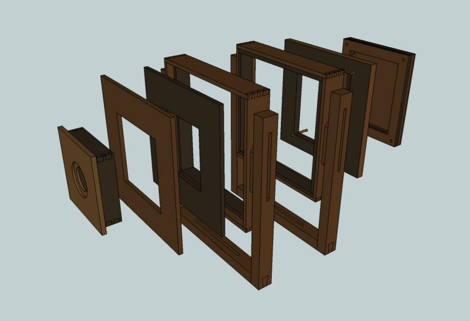

I'm building my first 4x5 monorail out of wood. I will post images of my design and will definately post a step-by-step when I'm done. The only part of the camera I am not building is the lens - everything else will be handmade from wood (no powertools). I was wondering if anyone had suggestions regarding the wood I use or tips/things they notice about there own wooden camera. Please feel free to comment about my design; any flaws you may see.
Already have a lens: 150mm F5.6 Fujinon-W
but I am keeping my eye out for a brass lens as well.
The design is a work in progress:

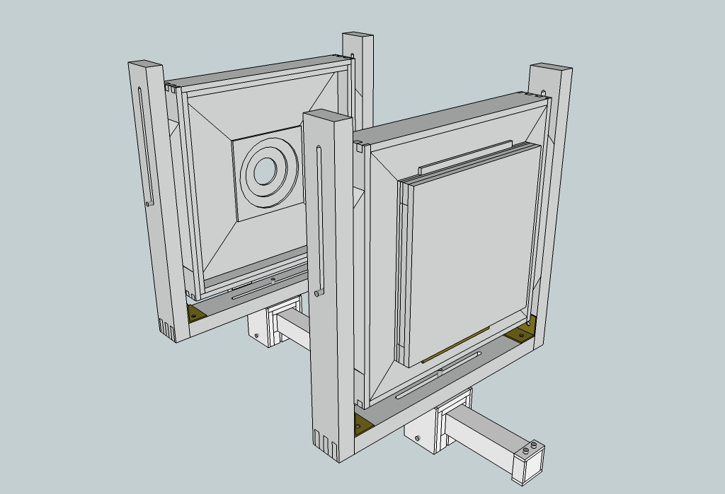

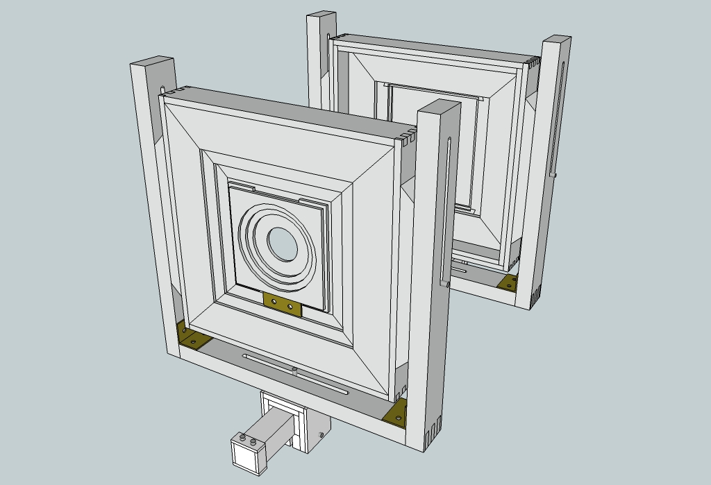

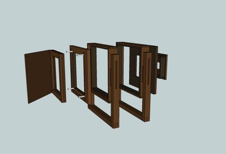

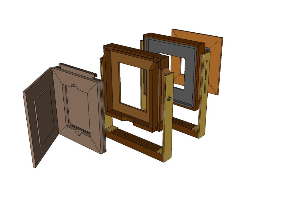

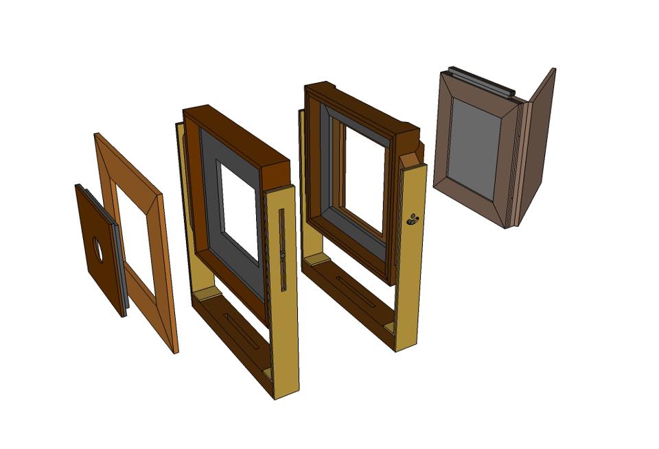

final designs
These are my final designs -- I may tweak them slightly here and there.
Let me know if you want to see different views. I'd be willing to export some images of specific areas exploded.
Steve Smith
May 3, 2006
9,110
Ryde, Isle o
Looks good but there's only so much you can do with CAD. Start cutting up some wood!
Some people like to get every little detail of a design sorted out before they start work. I don't! I make one piece then make the next piece fit to it, and so on tweaking the design (in my head usually) as I go on.
e.g. Although I have made the front and rear standards and temporarily fitted the bellows, I still don't quite know how I'm going to do the focusing rack. I have a few ideas in my head. I will probably have to try them out firs, possibly with some MDF before I cut up some more oak.
Steve.
