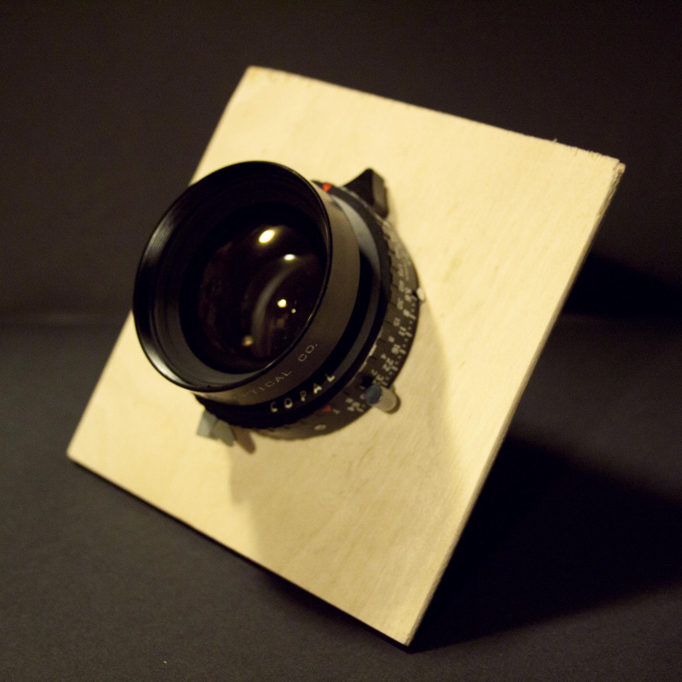

Cut lensboard today to test the wood - Baltic Birch. I'm going to test a few different woods at 1/8" -- Birds Eye Maple Lensboard :D.

May I suggest you stabilize the birds eye maple with a backing of thin plywood? The plywood should be smaller to make a step for the light seal. Better yet, you could use birds eye veneer on marine plywood. :smile:
That's what I was thinking - laying 1/8" not only for stability but for a light baffle.

I've made many lens boards with an outside "pretty" layer of wood sandwiched with an inside "stabilizing" layer of plywood glued together under flat pressure. I've never had a problem. Still... with birds eye maple I'd think about veneer over two layers of plywood (making a baffle). Doing it the "right way" with joints is best... but very costly.
