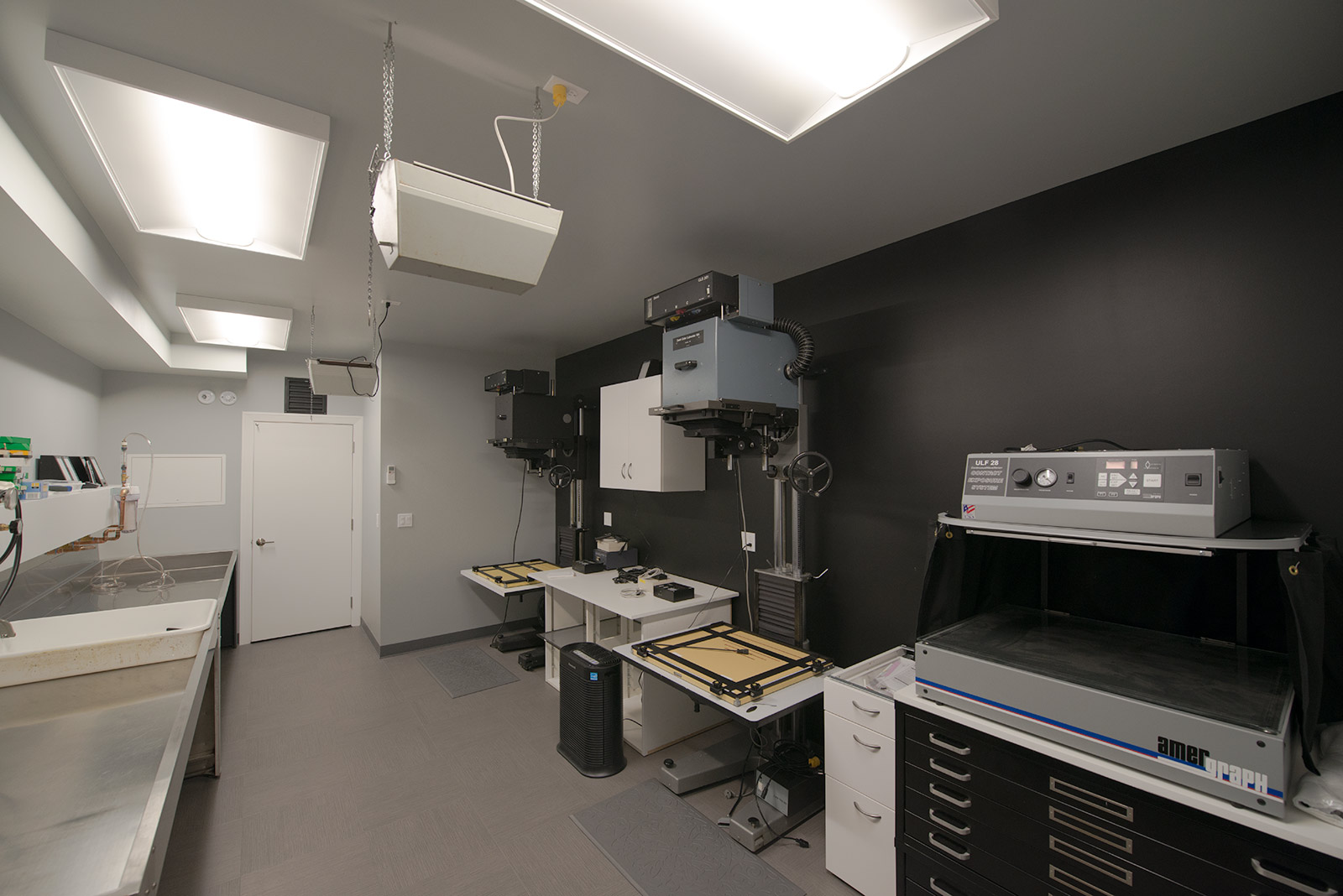

A 20 amp circuit for your enlarger just means that the electrician uses 20 amp rated wire and a 20 amp circuit breaker. You are building a whole new structure that's going have electric run to it correct? That means the electrian is likely to run a sub panel from your main electrical panel into the new building, that means you are free to use 20 amp circuits easily. In my darkroom each of my enlargers have a dedicated 20 amp circuit. So that's two just for the two enlargers, then the regular outlets are 20 amp, and the room lighting is a separate 15 amp. In my dry room my dry mount press has a dedicated 20 amp circuit, in my studio there are 4 20 amp circuits for studio lighting equipment, in my office my computers and scanners share 2 -20amp circuits. I have a dedicated 20 amp circuit for my stereo amplifier. In my old house I had a 30 amp circuit for it. It doesn't cost much more for the electrician to install 20 amp circuits as compared to 15 amp. The only increased cost is the higher cost of the wire, but it's the labor that's expensive, and there's no difference in labor for a 15 or 20 amp circuit.
You never know the long term requirements of the space you are building, to increase certain abilities now is far cheaper than doing it in the future.
