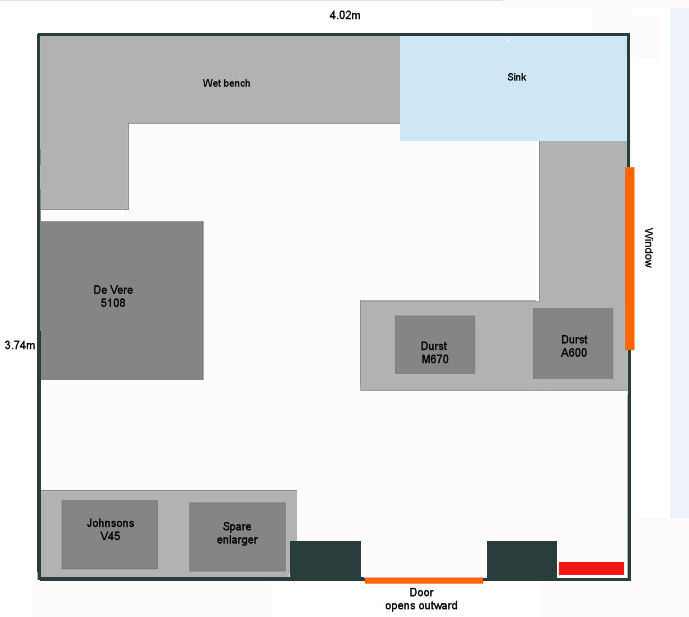

My darkroom is in a shed at the bottom of my garden, two walls are what's left of an old farm building the other two are breeze block.
My electrical sockets are at about 4' 6". I had planned to put my sink coming out from the wall at 90º but it wasn't practical and my second choice location was ruled out only after I'd insulated and plaster boarded the walls. In the end I added a bench that jutted out into the middle.
The blank wall space has a tall set of book shelves. In practice there's 3 enlargers but the other two can be used if needed.
Ian

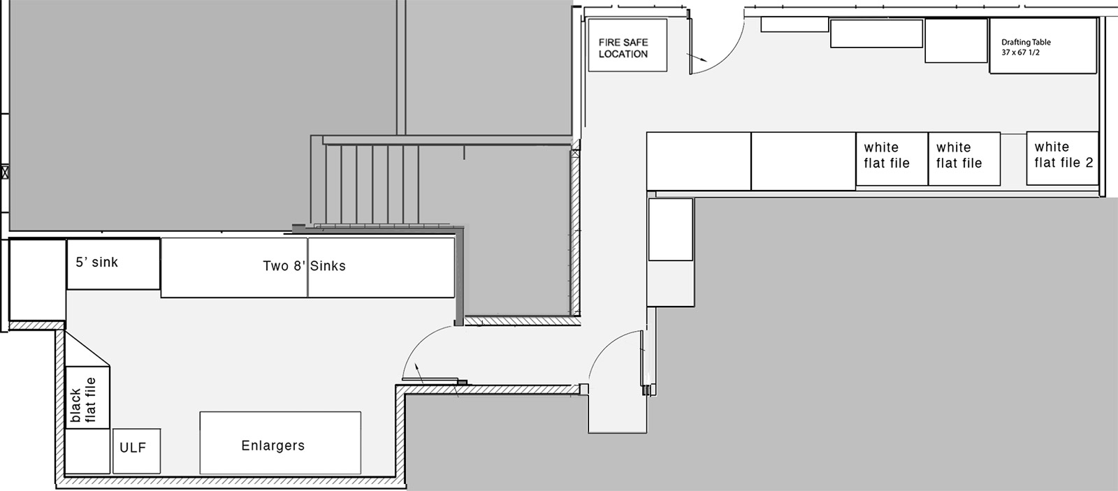

I can offer up my own experience. My darkroom is almost as big as what you're proposing. :wink:
Update: The 4' sink has been replaced by a 6', with the print washer now inside the sink. Same amount of space, just a bit "safer" from a water leak perspective.
