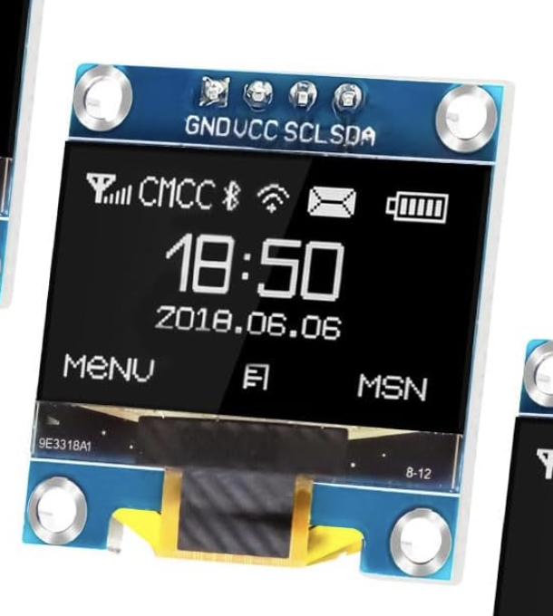

A standalone edge stamper would be good too
Yes we thought about a 0.9 inch oled display board from aliexpress. It could show custom information.

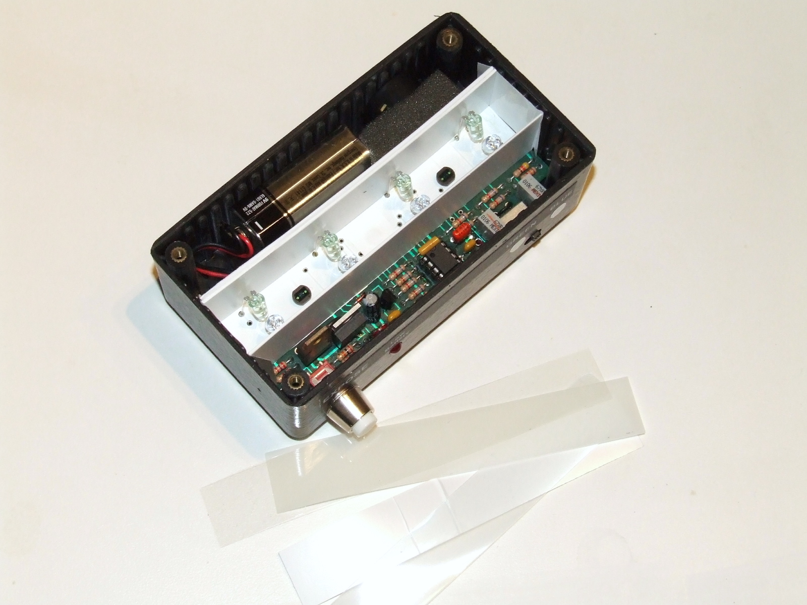

You might remedy this by making the left and right walls out of mirrors, creating virtual LEDs to the left and right, without increasing the physical width of your box.
Thats a good idea and easy to try, ill order some small mirrors and try.
