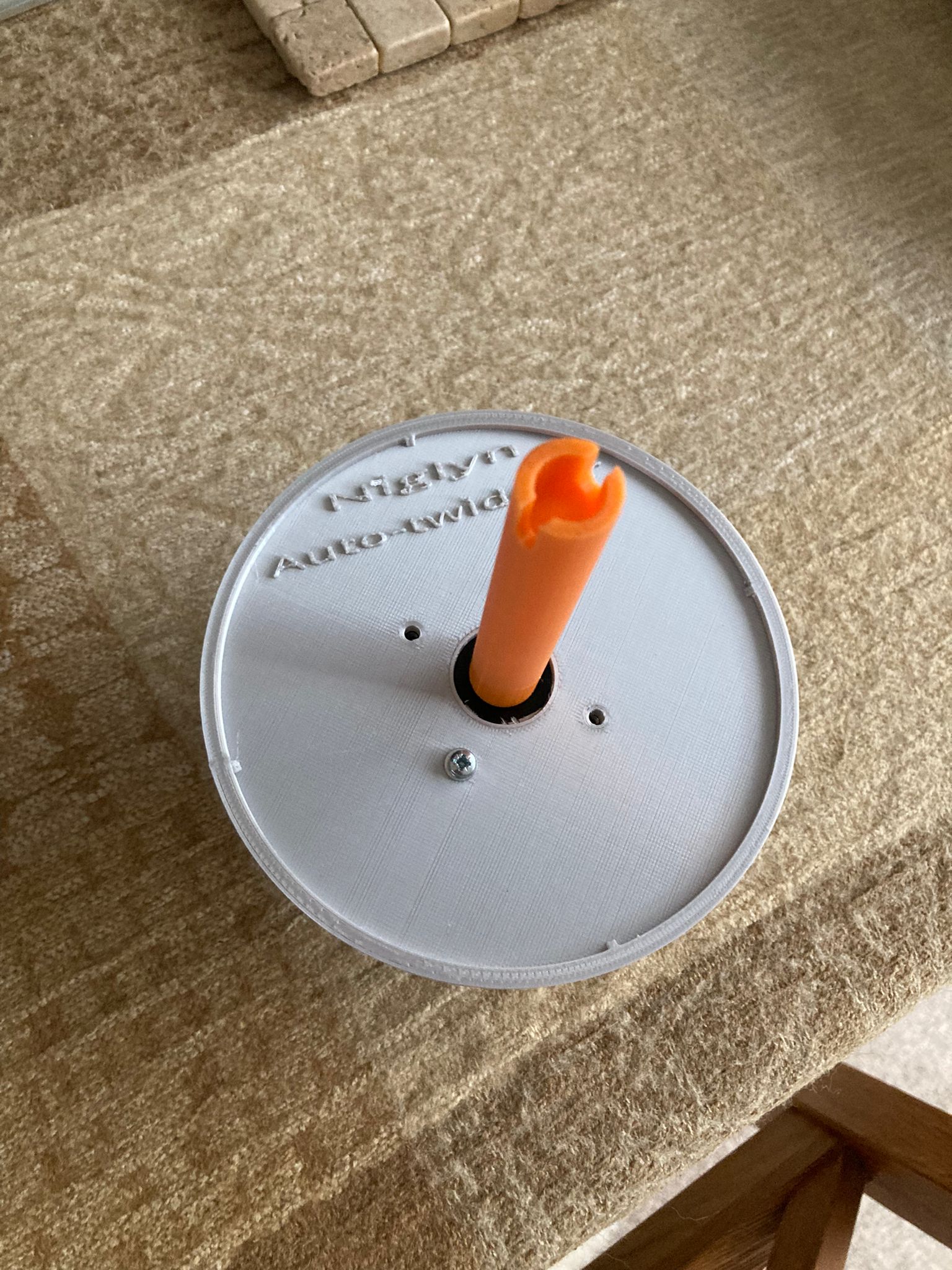

Here is the lid with twiddler. 3d print files will be on github shortly.

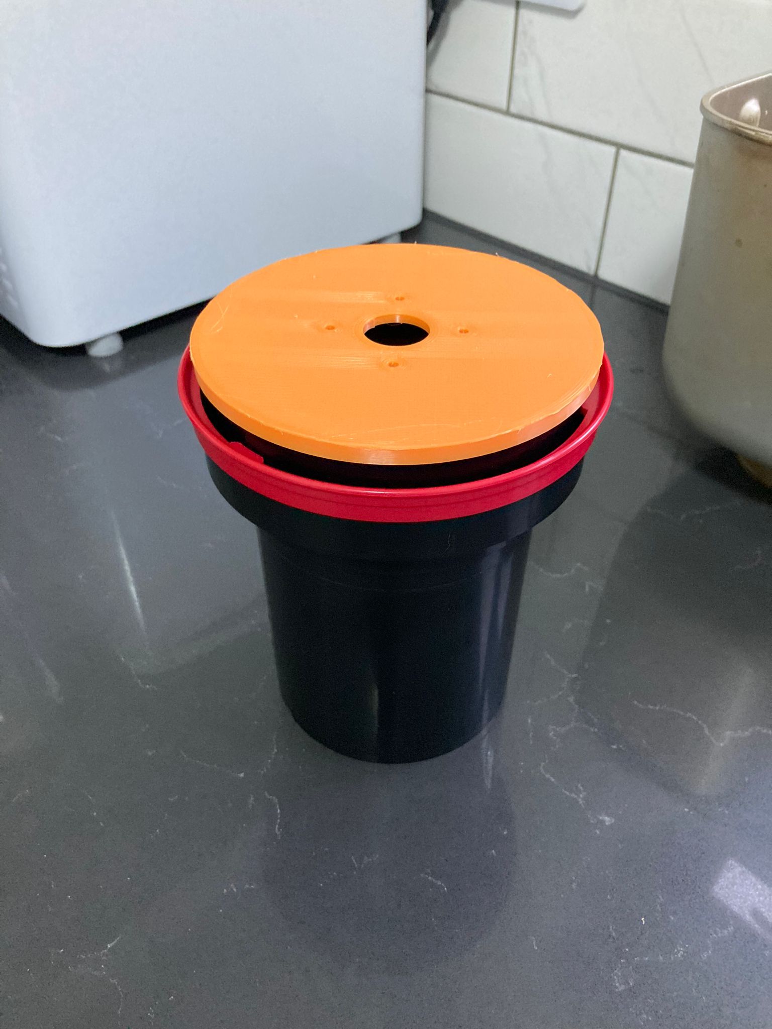

Here is a photo of the (new) 3d printed Patterson Super 4 Tank Lid.
It incorporates mounting for the stepper motor & teeth on the underside, to engage with the serrations on the tank rim.
A new twiddling stick will be available soon (printing now) which will connect directly to the stepper motor drive shaft.
stl print files on Github & Instructables.
Without a 3d printer, it is quite simple to make something similar from a piece of ply or plastic.
