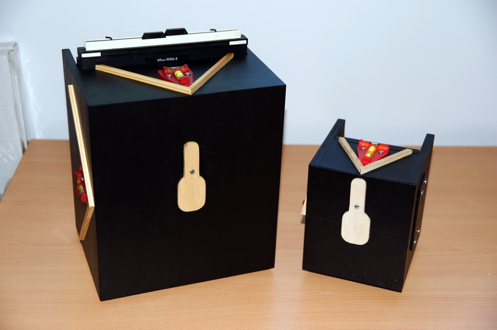

If you are talking pinhole, you can build your own. Here are the two cameras I built:
