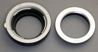

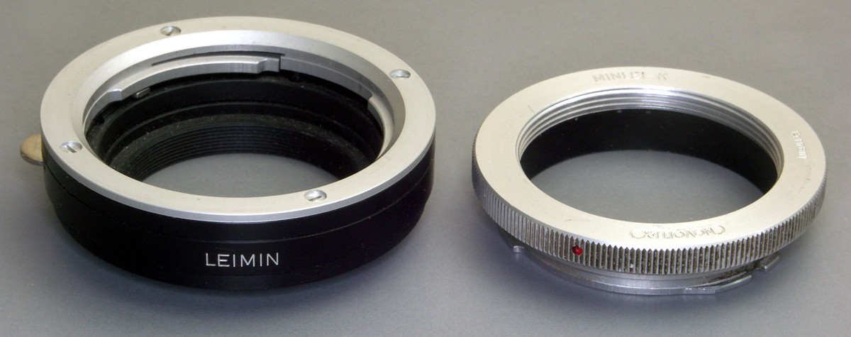

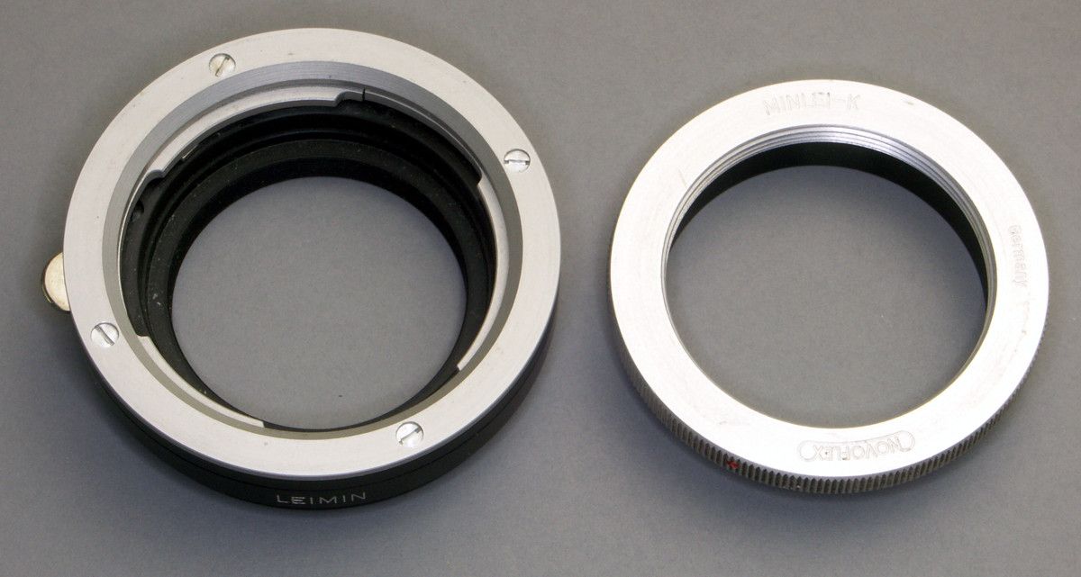

To complete this discussion, here are pictures of the NOVOFLEX LEIMIN and MINLEI adpaters. In each, the LEIMIN is on the left and the MINLEI is on the right.
The Novoflex LEIMIN adapter puts SR lenses on 39mm cameras -- Leica is on the rear, Minolta is on the front.
The Novoflex MINLEI adapter puts 39mm lenses on SR cameras -- Minolta is on the rear, Leica is on the front.
These and similar NOVOFLEX adapters (LEIPEN, NIKLEI, etc.) are easy to find, but you might have to hunt around or wait a while to get a good price -- whatever that means.
