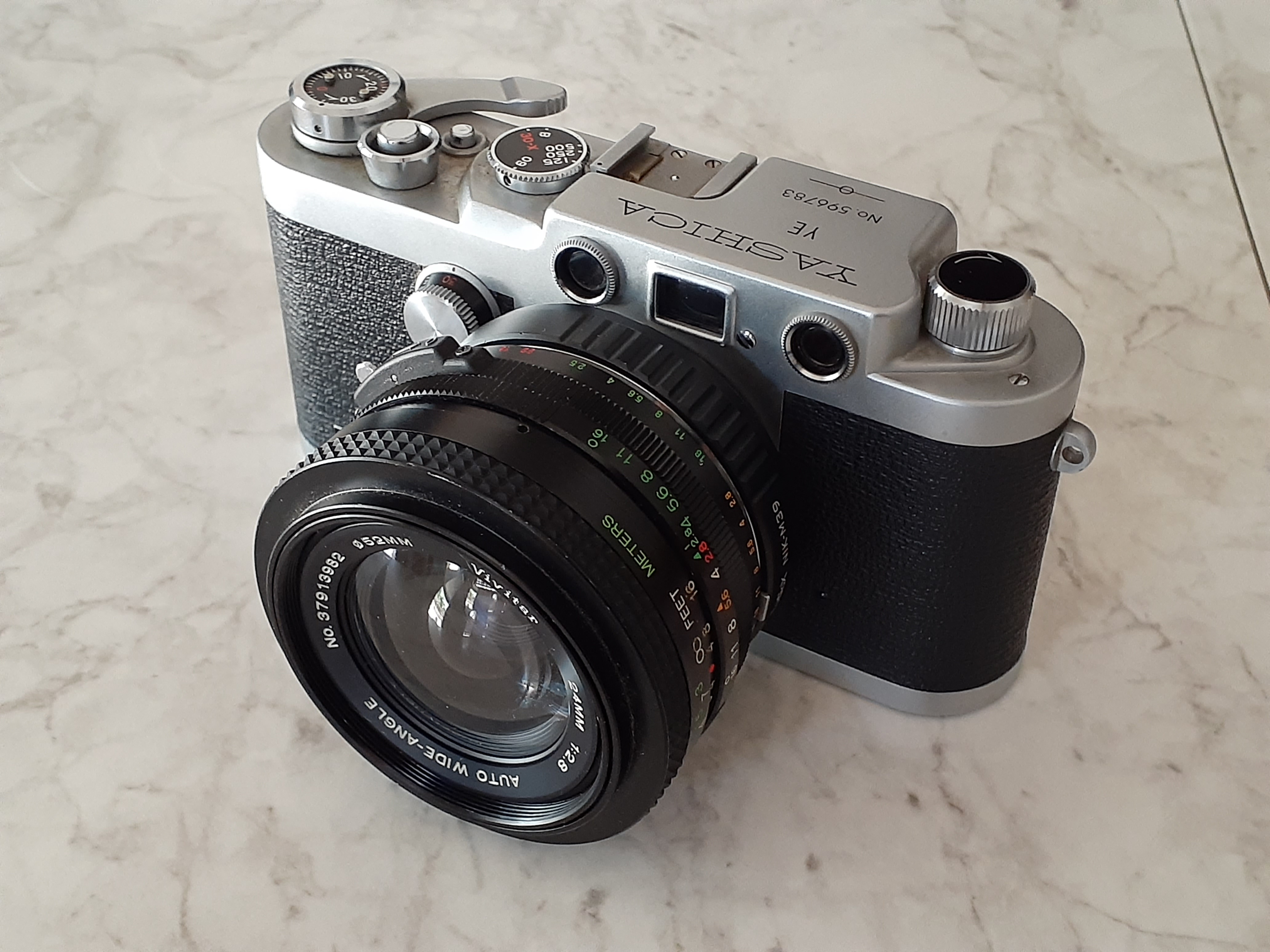

I received the Vivitar 24mm today and is shown on a Yashica YE. Interestingly, it has the Tokina TX adapter mount. I hadn't heard of that until today. Just waiting on the viewfinder.

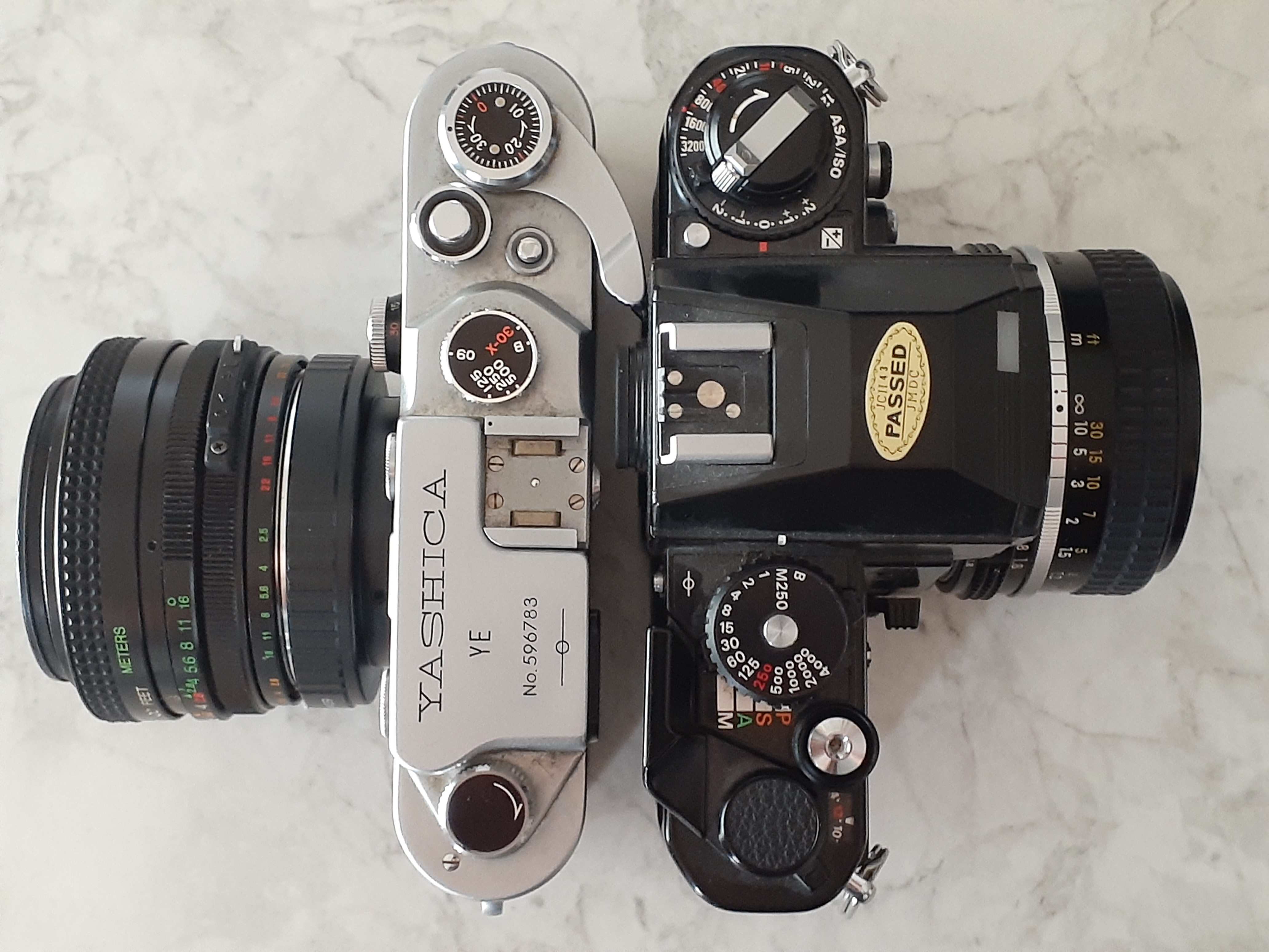

For comparison, there is hardly a weight or size advantage if I were to choose this setup over a Nikon FA with the same lens. The YE is 800 grams and the FA is 866 grams. The FA is a bit taller but nearly identical in width and depth.
