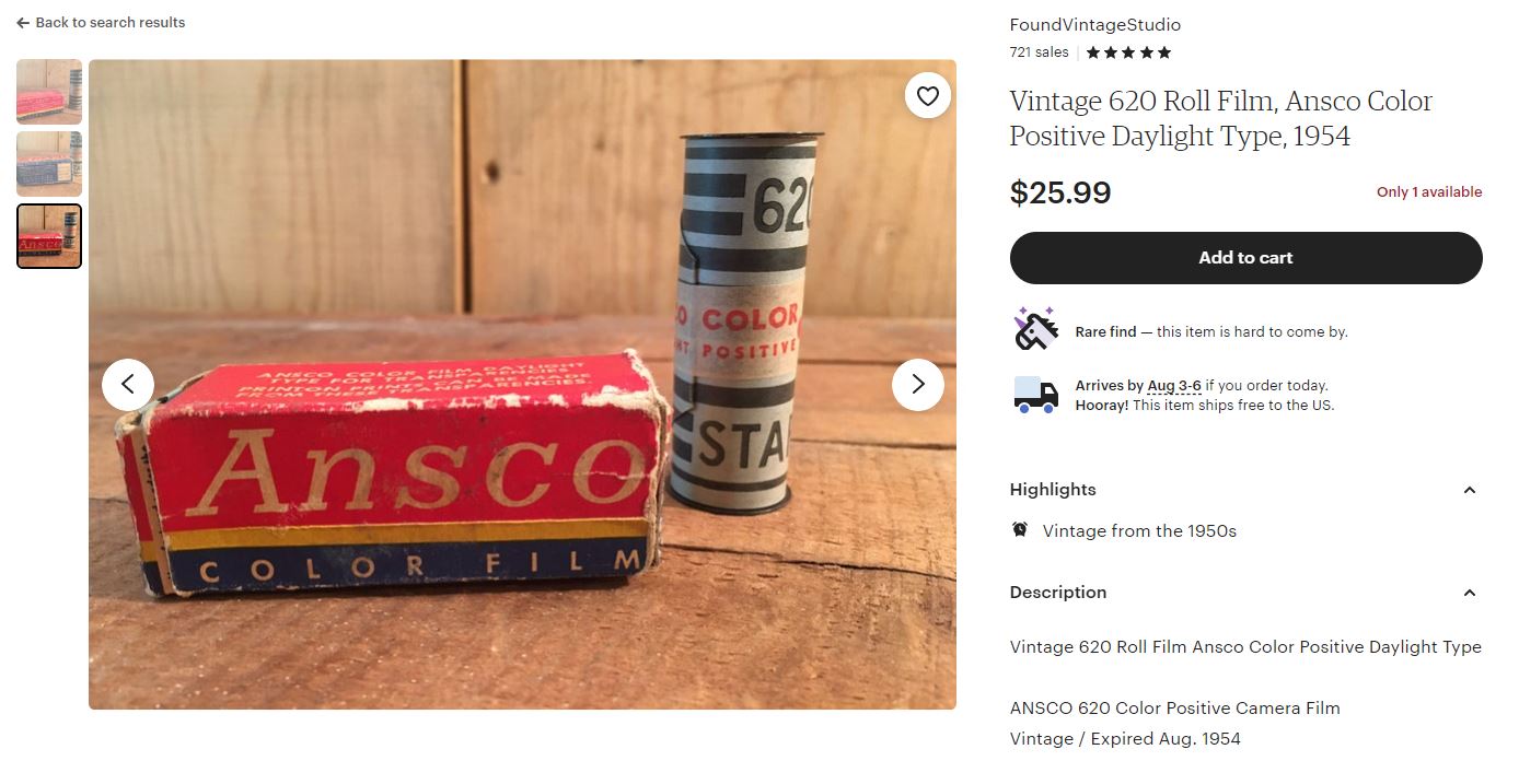

I was under the impression that Ansco introduced their own 620 film shortly after Kodak initiated the whole debacle.
Kodak's given reason for 620, that it made for smaller and more convenient cameras, seems rather idiotic when most of the cameras it went into were box cameras. Kodak's 620 loaded Medalist wasn't exactly known for being svelte. The 'thinner' camera angle only makes sense for folders - to the best of my knowledge these were only made by Kodak/Nettle.
Jeremy Mudd
Jun 28, 2019
541
Ohio
Apparently so, as there are a few rolls out there:
Donald Qualls
Jan 19, 2005
12,545
North Carolina
Ansco did produce 620 film, but it was only after Kodak sold enough 620 cameras to make it worth their while. There were a couple other American companies that produced 620 cameras, too, but I don't know of any that really took advantage of the "more compact camera" idea -- Kodak may have claimed that was possible, but that's like claiming that Mazda rotary engine enables a lower hood -- it does but that's not what it's for.
