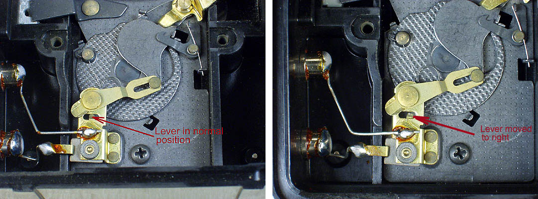

OP, you can try it for yourself, as noted in a post above - remove the back and trigger a flash with the brownie while you watch through the shutter/lens - you'll either see a perfect circle of white, or a sort of lunar-eclipse circle. If it's not perfect, the flash is firing before or after the shutter is fully open.
There are some tutorials on the web regarding bending the flash contact to get it to align. Takes a little trial and error.
Here's a pic swiped from the web:
