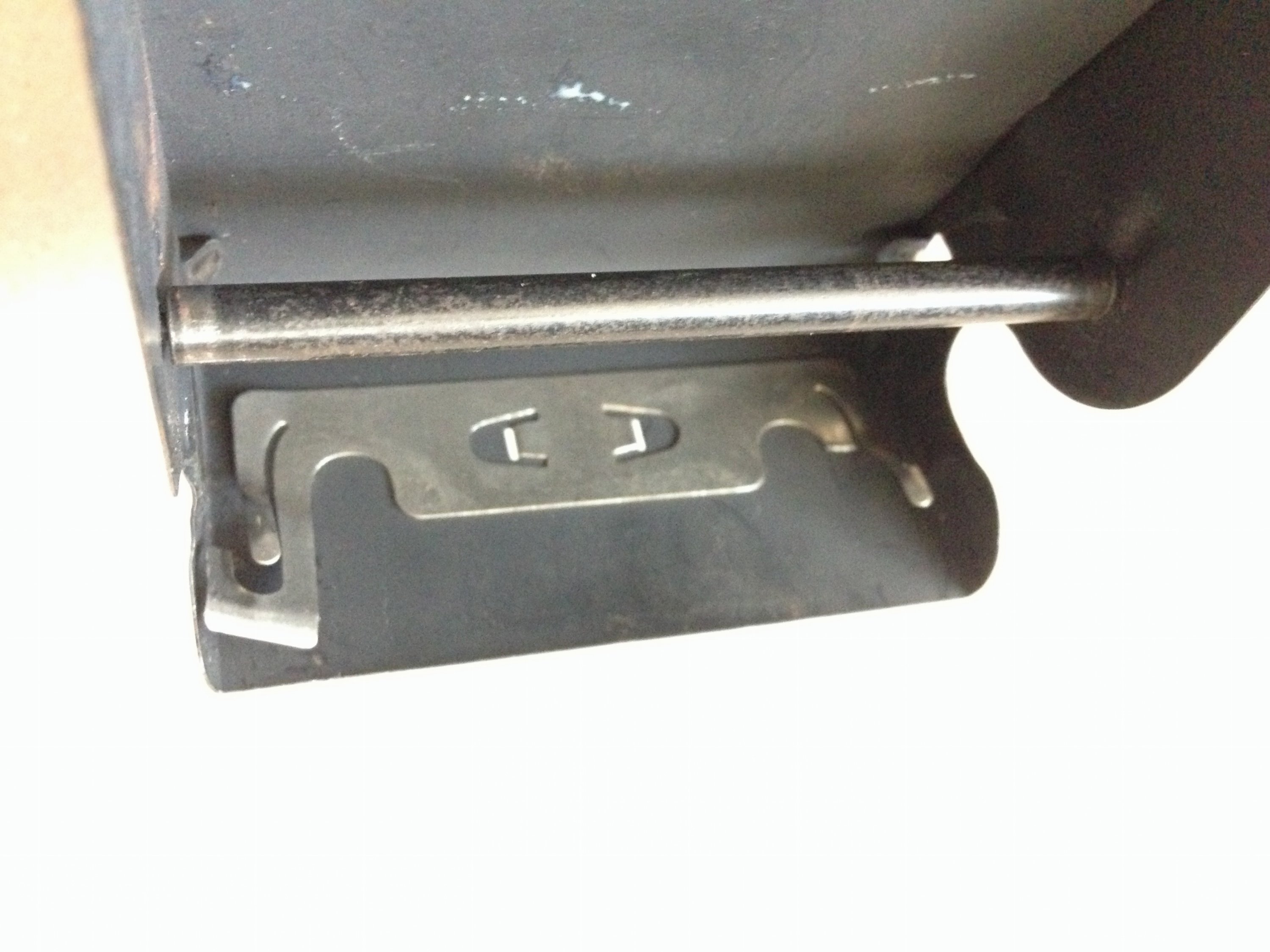

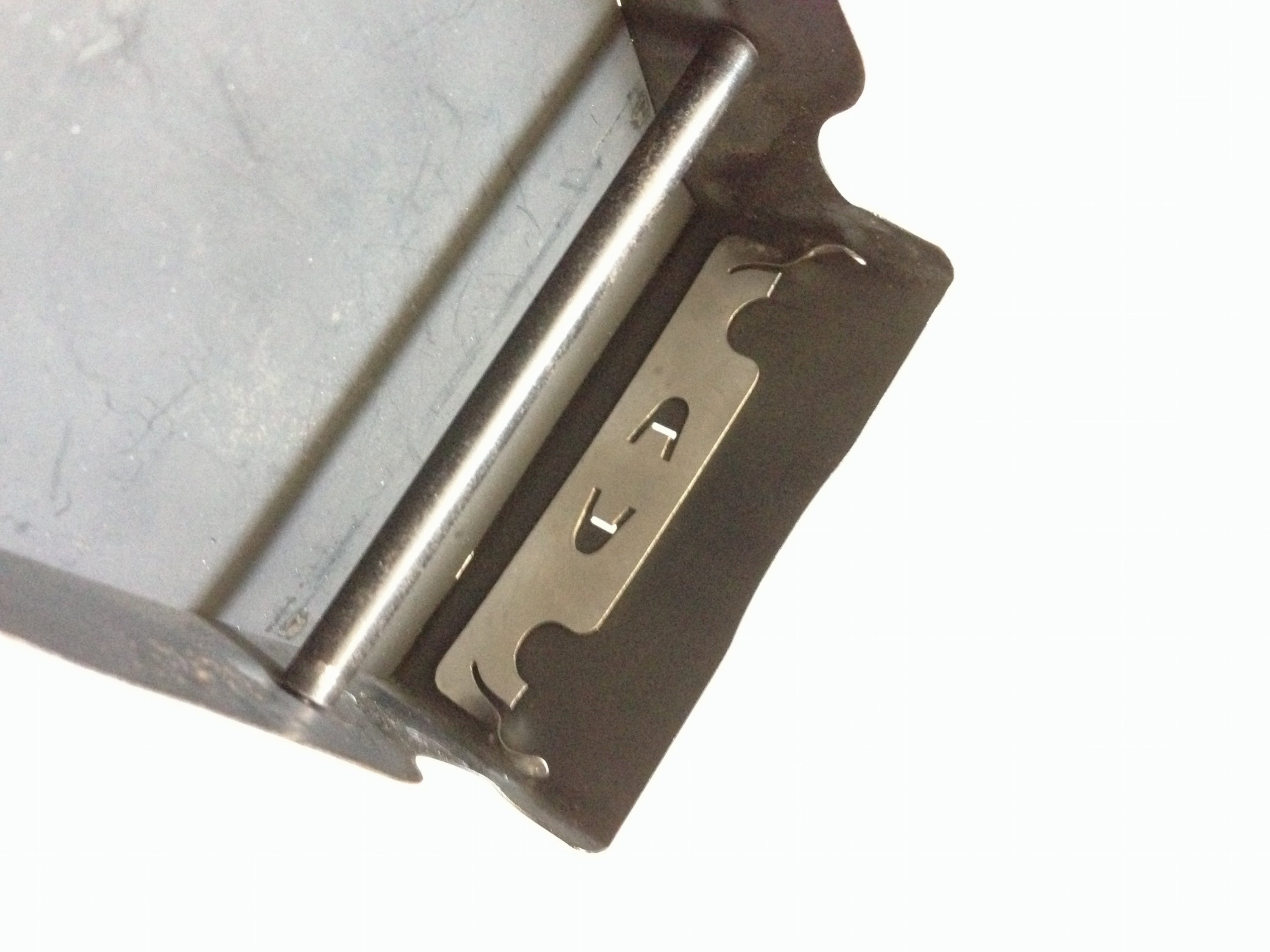

Here's some shots of the inside of my 2A model C. The first is the top where the film loads; the second is bottom where the takeup spool goes. Is anything missing here?

The springs in your first picture appear to be bent. They should look like the second picture. Their purpose is to hold the film roll in the slot.
I've only handled one Brownie, that was in 1977 and I do not know which model it was other than it used 120 film.
