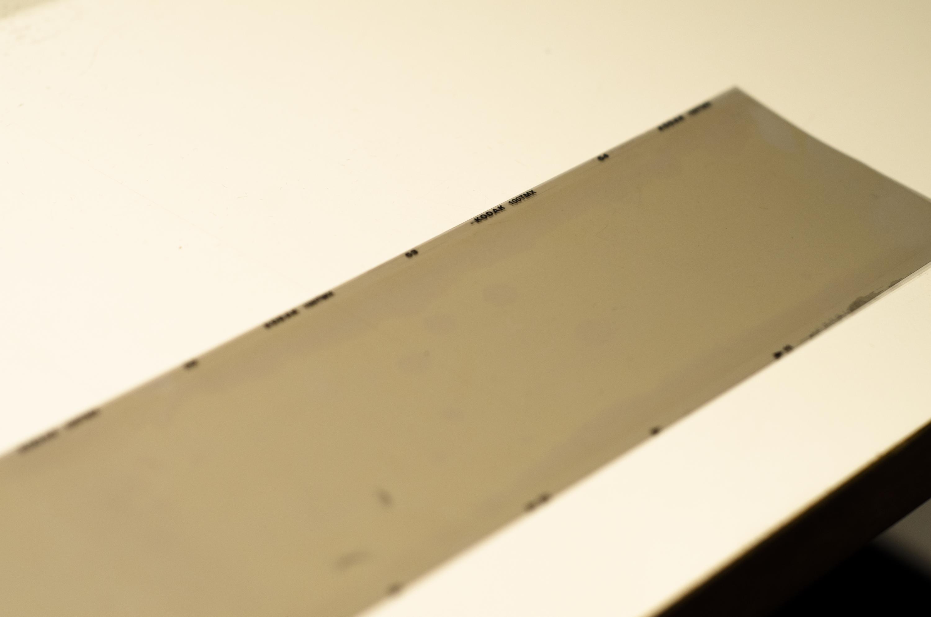

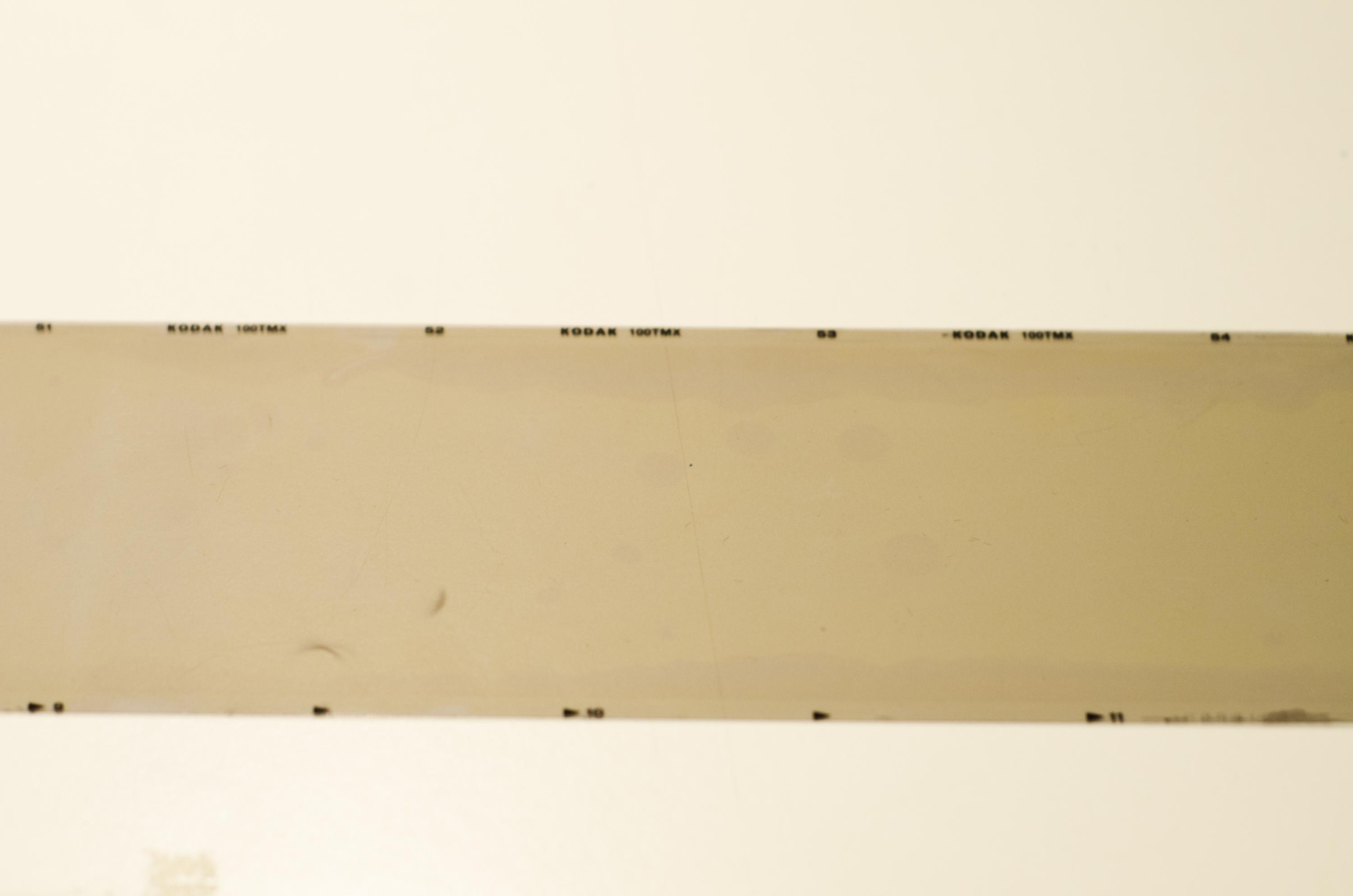

My negative is showing a brown/yellow stain in the middle of the film. I've been reading about bromide drag and dichroic fog but none of these seem to be my problem. I have been developing for about a year and this is the first time i encounter this stain. I'll go on and describe my developing method:

Lets hear a little more about your fixer and fixing:
What brand, what dilution, and how long have you been using the same batch of working solution (and how many films have you put through it)?
Because it looks like a fixing issue to me

Tmax needs twice as long as Tri-X, the tabular grain films are slower to fix than cubic grain, ACROS and Delta same as Tmax
The Kodak data sheets should say this. I fix by inspection, after three mins in plain hypo like yours it is safe to open tank and inspect, with Trix the film should be clear of milky appearance so you fix for another three, with tabular film like TMAX it may not be clear until five so you give it another five.
Fix and wash are both temperature dependent like development.
Put the film back in fix as soon as you can it may clear as normal...

It is a fixing issue because i let a strip in the fixer for some more minutes and it cleared out. I've always fixed t-max for 6 minutes 1:1 dilution but never controlled the temperature. At what temperature should i keep my fixer?
Fix temperature has two reqirements.
Minimise shock to gelatine swelling (emulsion)
Sufficient for archival stability
With Kodak film you can ignore the first almost, with e.g. Foma hold successive solutions within 0.5C or pay...
At 20C with plain fix you need more than 6 mins with Trix more then 12 with Tmax, you have little margin for reuse of fix, think archival stability for 50 years...
Don't try fix at 15C or below.
But fix by inspection is the cautious way - wait three minutes before opening tank in normal light is ok. They used to develop by inspection with ortho film... time and temperature is risky, old dev = film ruined
Put the film back in fix...

Kodak fixer mixes to working strength. Why did you dilute it further?
Hello,
beside the possibly too short fixing time there are two black spots like little crescent moons. This comes frome bending the film during handling. Determine the clearing time of TMax in your fixer and take three times of that time as your fixing time. You need a little glas with fixer and a little strip of your fresh film. The test can be done at daylight. Put one drop of fixer onto the emulsion side and wait until the film gets nearly clear on this area, then immerse the total strip in fixer and take the time until you cannot see any difference between the drop area and the rest of film. You can see it better if you put a piece of a newspaper with printed letters under the glas. "Normal" b&W films without structure crystals like TriX need only two times of the clearing time to fix completely.
With this test you can easily determine the correct fixing time of your used fixer too. With this test you can use even "oldfashioned" sodiumthiosulfate fixers for TMax.
Also I am wondering about your attachment - that was test film? There are no pictures on it, just plain empty negative.
Me too but it doesn't seem to have bothered anyone else and from what the OP has said this occurred in the middle of the film which suggests that there was no stain elsewhere??

Kodak recommends 5 - 10 minutes fixing with powdered Kodafix - depending on the film. T-Max 100 is one of the films that requires more fixing, so I would expect a single fixing bath would require close to 10 minutes.
I am assuming that your reference to "pure" fixer and 1:1 dilution is your way of saying that you are using stock (as in mixed as per Kodak's instructions) fixer without further dilution - that is correct. If you are actually diluting the fixer further, that is a mistake.
If you are using T-Max 100 in 120, my suggestion is that you buy a roll of T-Max 100 in 135 to be used for clip tests - you should probably be able to get 36 or so clips out of it.
Then for each developing session, do a clip test by checking on how long it takes to clear a clip of film while your subject roll is in the fixer. If it takes six minutes to clear the clip, your total fixing time should be a minimum of twice that.
The powdered Kodafix has to work really hard to fix the T-grain films like T-Max 100. Rapid fixers are usually better.
Thanks everyone for your responses. The film was not exposed and the two crescent moons are due to bending, when i develop exposed film i am much more careful. After reading your responses i understood it was too little fixing time, so i left part of the strip in fixer for several minutes and the stains were removed. This happened for the first time and in my opinion this is because it's winter over here and temperatures are pretty low, making the fixer less efficient. Next time fixing i will check the film and see if it needs more fixing time, thanks to all of you, your replies were very useful.
