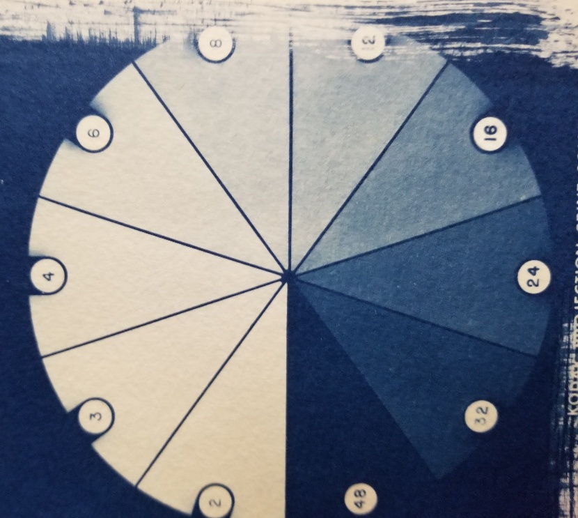

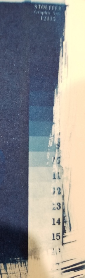

here are the 2 step wedge type images I have. I don't remember the exact exposure times, but I haven't left anything out in the sun for longer than 15mins

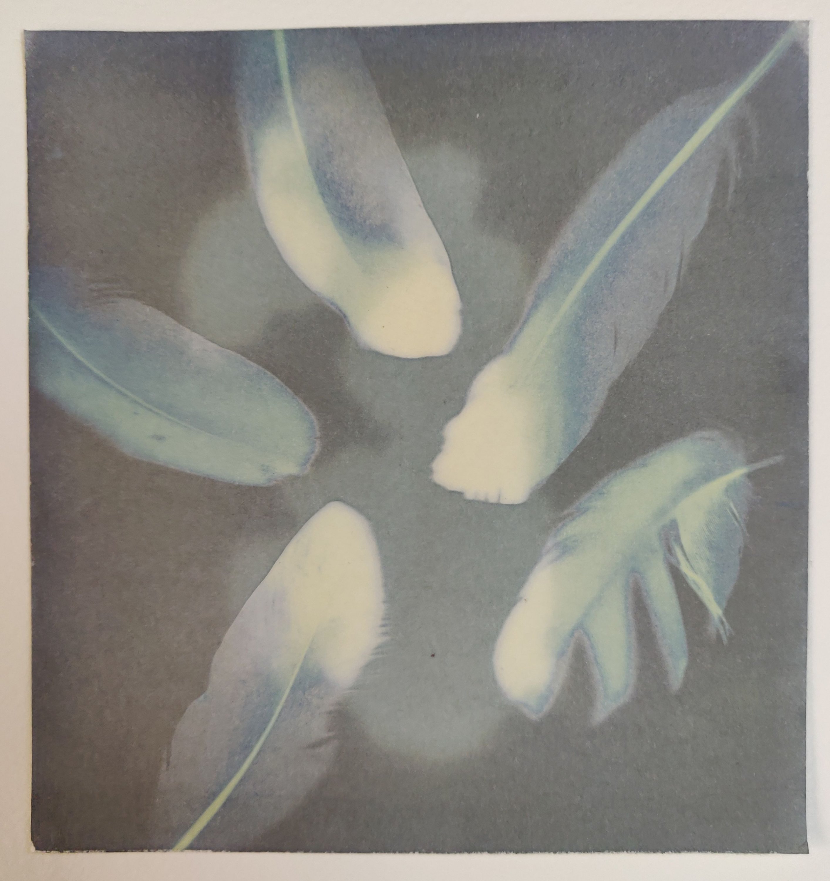

Thank you Niranjan! I have used aluminum foil to cover.. And I used the old batch of solution today to make some prints.. I followed your advise on the exposure time.. I washed them within 2 hours and it came out pretty well.. However a couple of them got foggy immediately after I exposed.. Attaching an image of the print before wash.. What could be causing the fog?

What do you consider to be the fog in the picture?
Thank you so much for this.. I guess my emulsion doesn't work that well.. Today I tried a 1 hour and 30mins exposure and the colors looked dark soon after the hydrogen. Peroxide wash.. However now when I see, it's faded quite a bit.. Not sure why. May be I have to leave it longer..?
In the center of the image.. Do you see a light grey blob? That's what I mean by fog.. Don't know what you call it in your cyanotype terminology!
It stays even after wash..
OK, I see. How did you coat the paper? Did you pour the whole quantity in the middle and then brush it out all over?
Can you please share the final print that goes with this.
No I didn't pour.. I used a brush to brush it all over..
I am not sure what could have caused it then. There is obviously some variation in the sensitizer coverage where the blob is. It looks to me to be lighter than the the rest - I would expect that the blue density would be lower there than the rest. Is that so?
Other than that the print at this stage looks very much normal. Lightest where there is minimal exposure, turning green with some exposure, then on to blueish with some more and finally turning gray with maximum exposure where there is no coverage by the feathers. The last stage is called "solarization" where some of the Prussian blue gets photo-reduced to Prussian white making it revert from the blue tone to more neutral one. When you are exposing in the Sun, you can judge the correct exposure by looking at the shadows of the print and allow the exposure to proceed just past where the shadows start looking lighter/grayish than the mid-tones. This Prussian white gets oxidized back to Prussian blue as you leave it in air or by hydrogen peroxide treatment.
The term "fog" has a specific meaning in this context, coming from the conventional darkroom world - it relates to density (in this case blue) in the print where there is no exposure. For example, if you just coated and dried a piece of paper with cyanotype chemistry and washed it out without giving it any deliberate exposure and it turns a shade of blue, it is said to have "fogged."
:Niranjan.
:Niranjan.

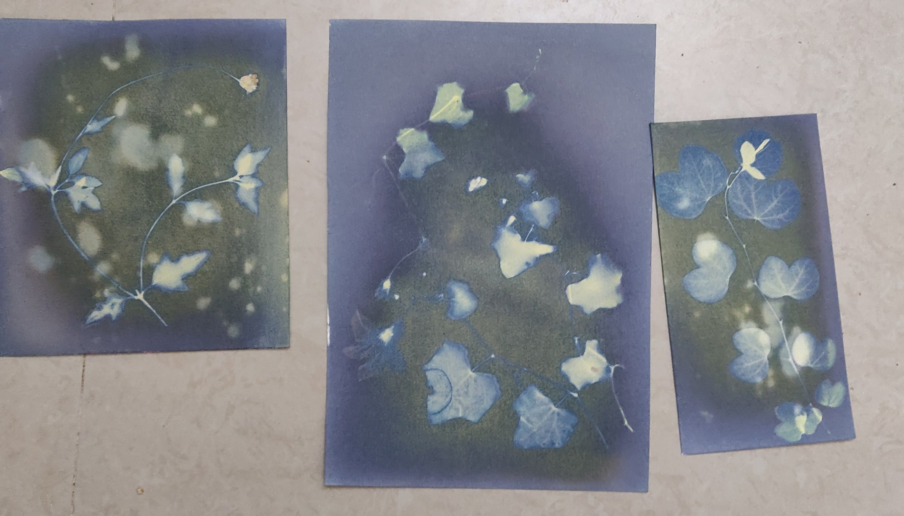

Hi Niranjan,
Here is the print from today's batch before wash.. If you can see the blobs are back! Don't know what's causing it.. In the first and last prints, you can see the spots which are lighter blue after wash. The prints are now drying and will send a pic..
Can you also tell me why I see some discoloration around the white areas of the print.. Which is again light blue after wash.. Is it because it's over exposed? I kept it for about 3 hours as last time with 1 hour the blue wasn't deep enough..
Nithya
Hi Niranjan,
Nithya
The blobs - they are much larger than the one before. Probably something to do with how the sensitizer is getting distributed and absorbed on the paper. Is the paper bowing or bulging in the middle when you start coating. How thick is the paper (in gsm or lb weight)?
About the white spots, no idea but again it is most likely due to sensitizer coverage - may be wetting problem, perhaps some spots on the paper have less affinity for water than the rest (due to contamination or defect in the paper) so the sensitizer is deficient in those areas. Watch the coating while you are brushing and look if the sensitizer flows evenly. If it is not wetting the paper in areas, you might have to use a surfactant like Tween 20 which will help smooth over those spots.
Not sure if I understand the "discoloration around white areas" of the print. Can you please circle or label these defects? May be still related to the issue described above.
Finally, I suggest that a controlled test for the correct exposure be done without any objects on top so you can get an idea what exactly is going on. If you do not have a step-wedge that was shown by hol571, you can use a simple test-strip method that is used in the darkroom, exposing different times on the same piece of paper to get at what is called "minimum exposure for maximum density." Your exposure time might be in minutes and you might be playing in hours. Too much exposure can also decrease the blue density - above a certain level. Exposure times will also differ depending on the time of the day and whether it is cloudy or clear. So that's an another variable to be kept an eye on.
Niranjan.

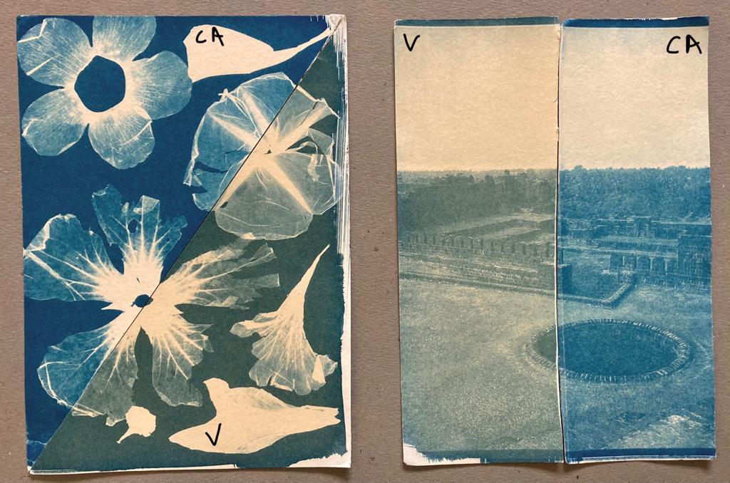

Here are my unsuccessful attempts at removing yellow stains from highlights using 17% Brown FAC for Solution A. Used Citric Acid 1% for 1st development bath, and then another bath in the same, followed by rinse and hydrogen peroxide soak (made no difference). Followed the same method for vinegar. Contrast is greatly lowered and while I like Citric Acid experiments for photograms, I find it useless for digital negatives, which were working perfectly with my older good Green FAC.
It says in Cyanomicon Appendix III.5 that Brown FAC has "a much greater tendency to leave residues of hydrated ferric oxide in the paper, with consequences both for the colour and the stability of the resulting cyanotypes"
HI, Vandita:
Just judging by the comparisons in your attachments, I wouldn't call this unsuccessful at all. That is a dramatic difference, even on the 2nd digineg-based print. The yellow haze that made the blue turn greenish is by and large gone. If anything, seems to me that there is blue staining the highlights - which tends to increase on acid (either citric or acetic) development. To counter this tendency, my favorite process has been developing in plain tap water first (which should not be alkaline, distilled water if that's so) for 1/2 to 1 minute followed by a couple of citric acid baths. That seems to give me a best combination of cleaner highlights (blue as well as yellow) and a good Dmax.
:Niranjan.
