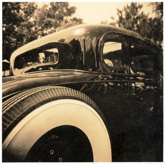

Brovia and Lith
I don't know if you can call this success or not. It's all in the eyes of the beholder. I know I like the results, and that others detest them.
Fotospeed LD20 developer at 1+30 dilution at 75*F. Processing time in developer about 30 minutes.
- Thomas
