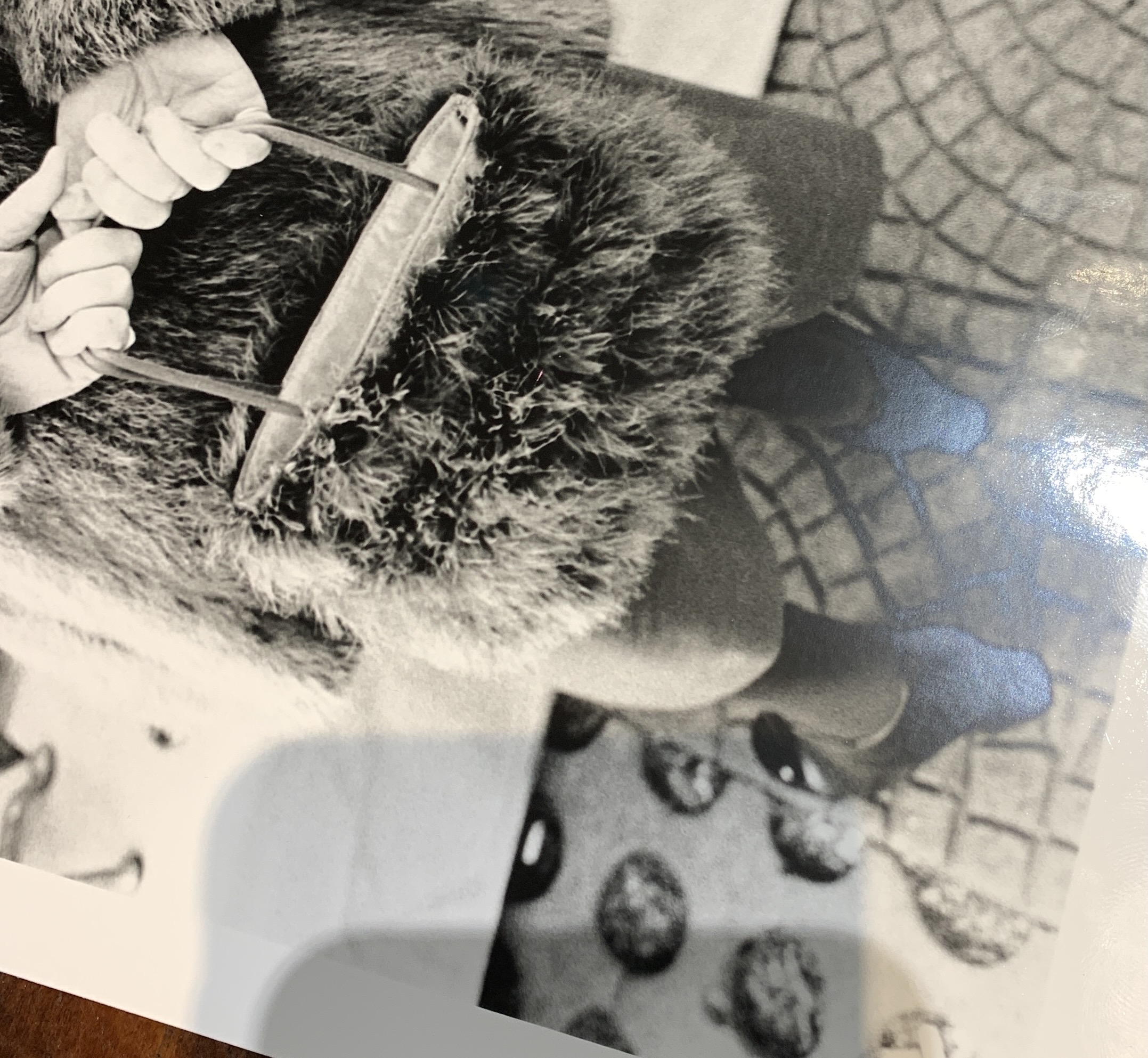

Hi. If I hold my prints at an angle in strong light, the deep blacks appear to separate or show a bluish hue - a bit like an inkjet print! I'm using Ilford RC VC paper and Ilford chemicals. I was wondering if this is normal or if anyone has any idea what might be causing it. I am using a red LED bulb rather than a specific safe light, so dont know if that might be the problem. Any advice gratefully received. You can see the effect in the feet of the woman in the image.

I don't think that is silvering out.
I think you are seeing how the surface sheen manifests itself when you are viewing a print under certain types of light, at particular angles.
If you look at the print straight on, does it go away?
If you look at the print under different light, does it change or go away?
Do you have different paper surfaces available to you? If so, do you see the same thing with them?

Thanks Guys for your helpful comments. Under normal viewing the effect is not seen. Its only under light (various sources) and when the print is angled to the light. Only have gloss paper so DK about other finishes. The paper and chemicals are all fresh. Maybe "it is what it is" I just wasn't expecting it. I develop for 1 min, stop 30 secs and fix 1 min. I wonder if these might be variables?

I have this issue with pretty much every glossy RC paper with many different developers and processes. It's just how glossy RC tends to be. Matte and pearl finish RC papers do not give this effect and it's only visible at an angle

All I can say is I've got an album of MCP310 prints that nearly all have started to silver out / bronze. The cause seems to be the combination of insufficient fixing (I heavily overused the fixer) and very limited washing. I'd suggest using 500ml of fixer at 1+20 dilution or so, run a few prints through it to get it down to its knees and then start feeding through your actual prints. Stick with a 1 minute fixing time or so.
It'll be a balancing act between fixing insufficiently so that the bronzing occurs, but not so short that you end up with too much retained silver that will print out over time and create brown spots.
It takes a few months to a few years for the bronzing to take place; be patient.
I thought the bronzing was most often caused by exposure to paper with residual manufacturing chemicals in it (acid) and varying humidity levels. So, you see it in photos in albums and you see it in matted photos around the edges. I had a few sheets of 75-year-old kodabromide paper that were actually bronze coloured straight out of the box, where they had been between the black paper and pressed up against the cardboard of the box. I tossed them in fixer and the colour stayed. So, @jnantz, if you want the effect, just wait 50 years or so....
