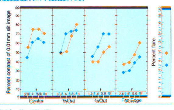

Even if money is no object, I would go for the Bronica and spend money on more lenses, workshops or travel, without worrying about sharpness. Remember, e.g. the 80mm PS originally was about 60% of the Zeiss C 80mm 2.8, and not a cheap lens by any means (about the same as Pentax and Mamiya lenses). Now it can be had for about 10% (or less?) of the Zeiss price! Of course the technical value did not decrease by the same amount, here is a overlaid graph from Pop. Photo comparing the older S (not PS!) 80mm (blue) and the Zeiss F 80mm (red).
