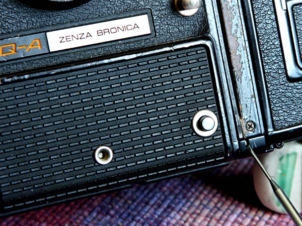

At the bottom of the darkslide slot is a separate little slot where the interlock tab from the darkslide slips in. The tab is about a sixteenth of an inch long and not quite as wide. The slot looks a bit narrow for a typical paperclip, but a little sliver of something pushed gently in there about 1/16 inch should allow removing the back.

While I'm not sure how much can be accomplished by removing the back without the darkslide in, I confirmed my earlier post. Pushing in through the little slot below the darkslide slot does release the back interlock. The 1 mm wide jeweler's screwdriver shown here worked nicely.
(And yes, the grody combination shown is from my backup components, currently assembled with a pinhole body cap.)
