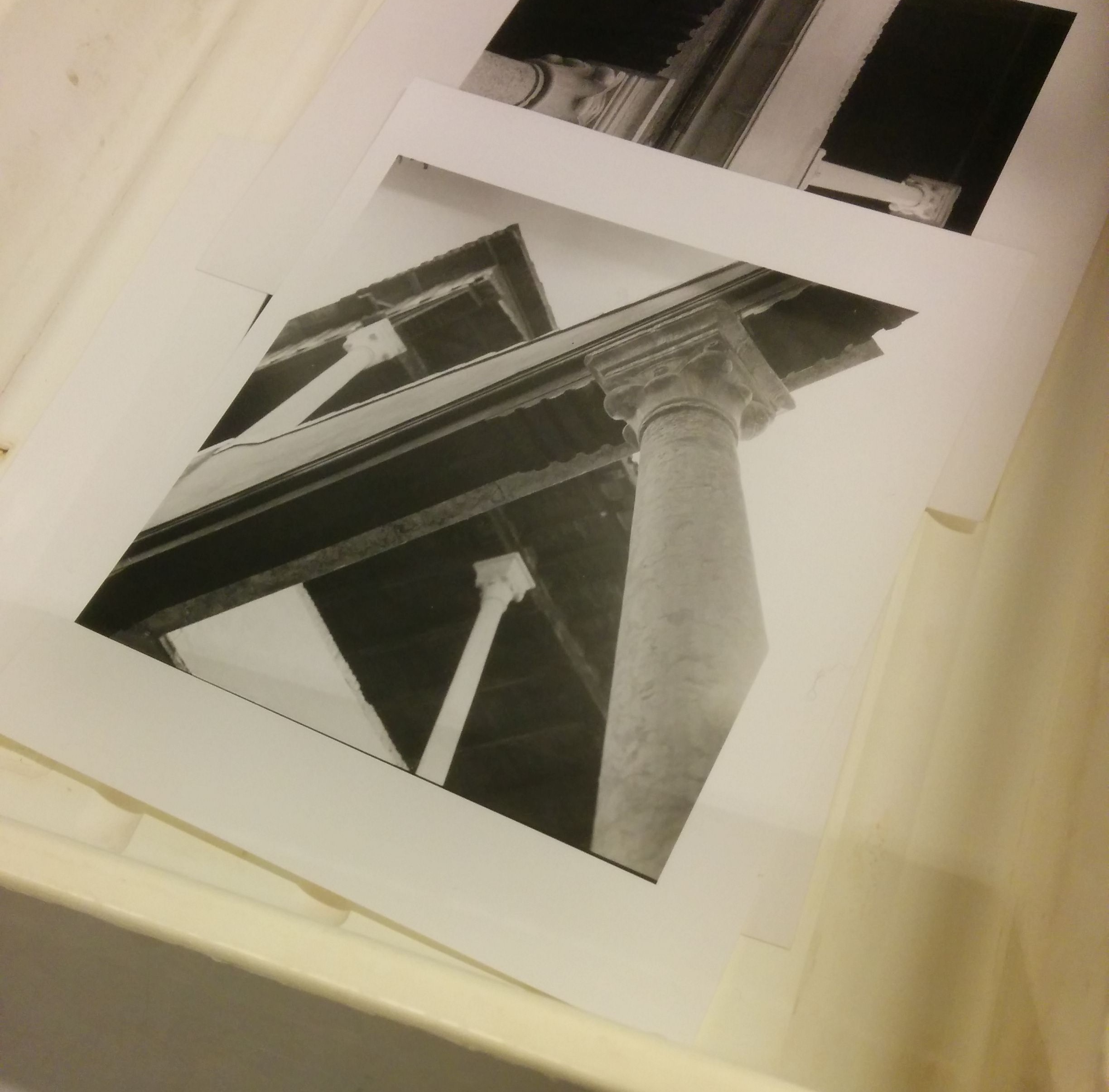

I dont have the negatives with me, but I can show you one of the print. Even though the strip is clearly seen in all the negatives as well.
Thomas, the slice on print is darker, the slice in negative brighter, so Im more for the mirror argument more than light leakage.

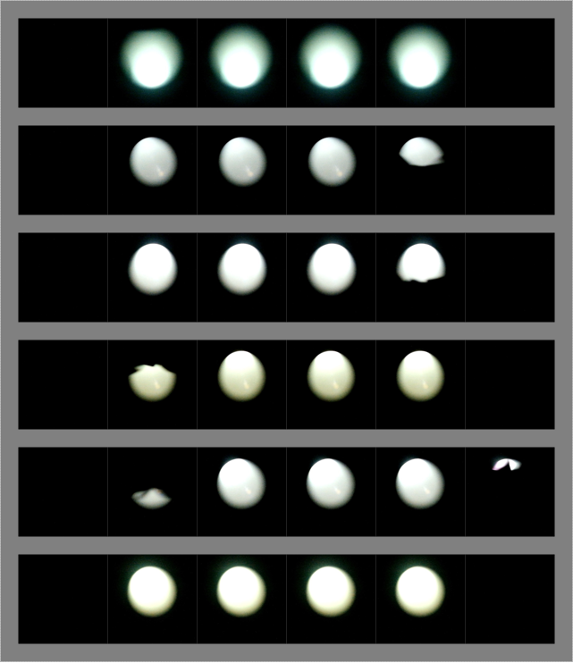

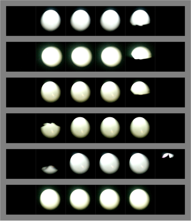

I tried with my two lenses (50mm and 80mm), doing a digital video of 1/15 secod exposures. The video rate is very low, just 60 fps, and each frame is 1/4000 speed, at 6400 iso. In this situation, one would expect 4 video-frames fully open in average. If the mechanism were perfect though, the shutter would be fully open by the time the mirror is completely up. So, I presume two hypothesis: 1) The star-like shape of the shutter leafs shouldnt be seen in any video frame. 2) The white circle (shutter fully open) shouldnt be never cut by the mirror.
Here I put strips frame-by-frame for both lenses (first 50mm second 80mm):
Already in the first example on the 50mm, you see the mirror blocking. In the 4th and 5th example you see the leafs.
In the 80mm series... well... sorry I thick I took the same video...
