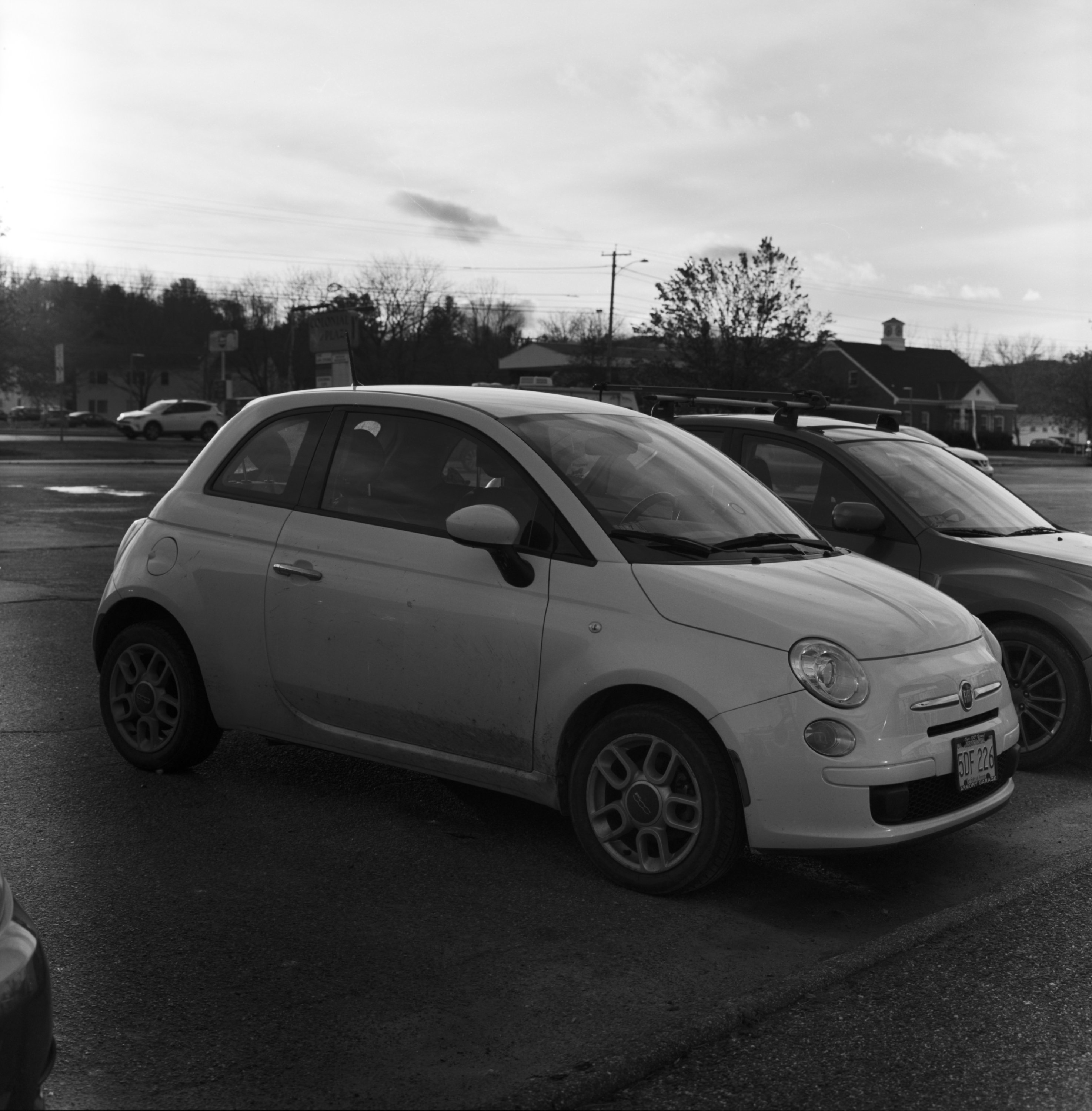

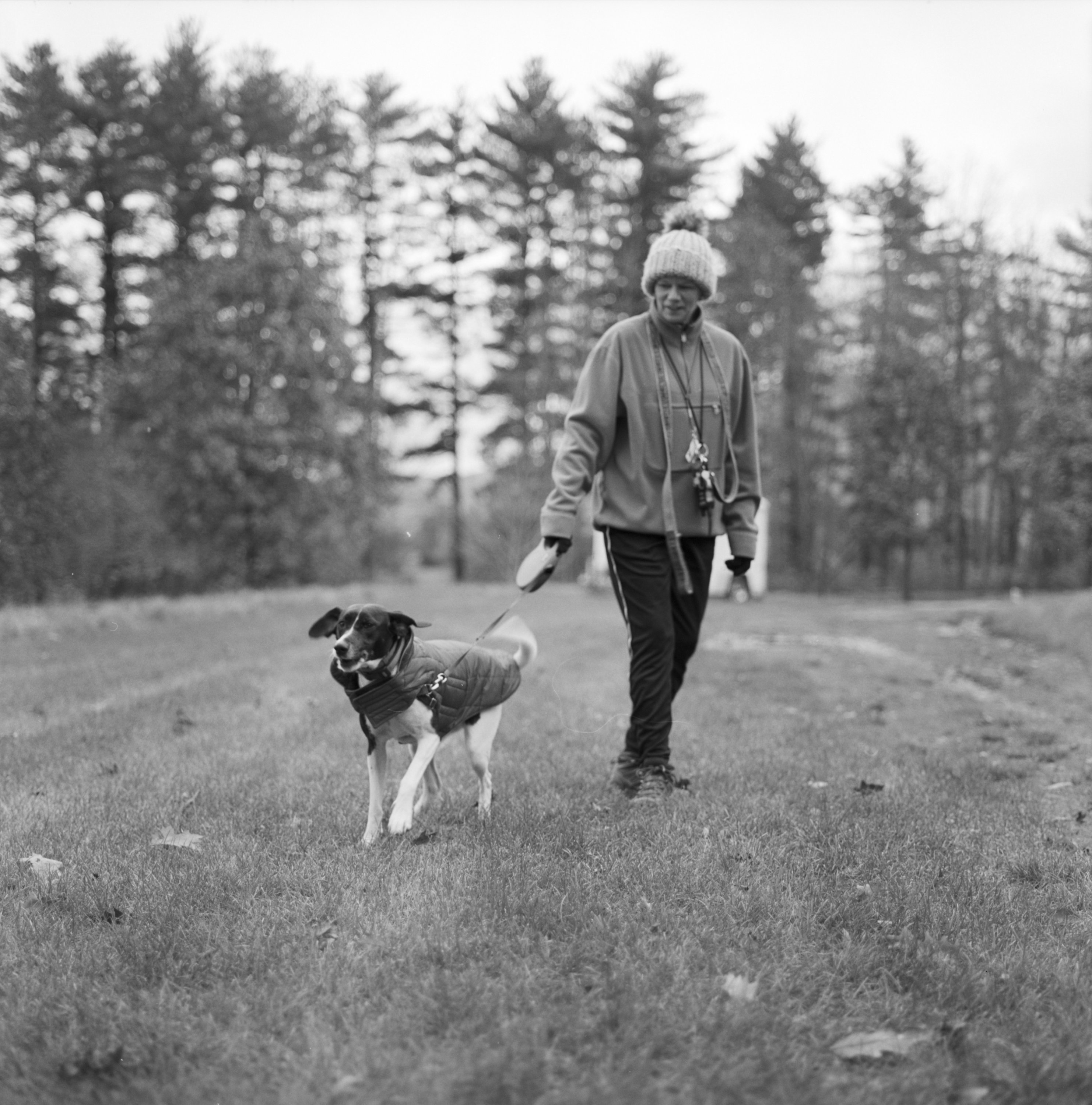

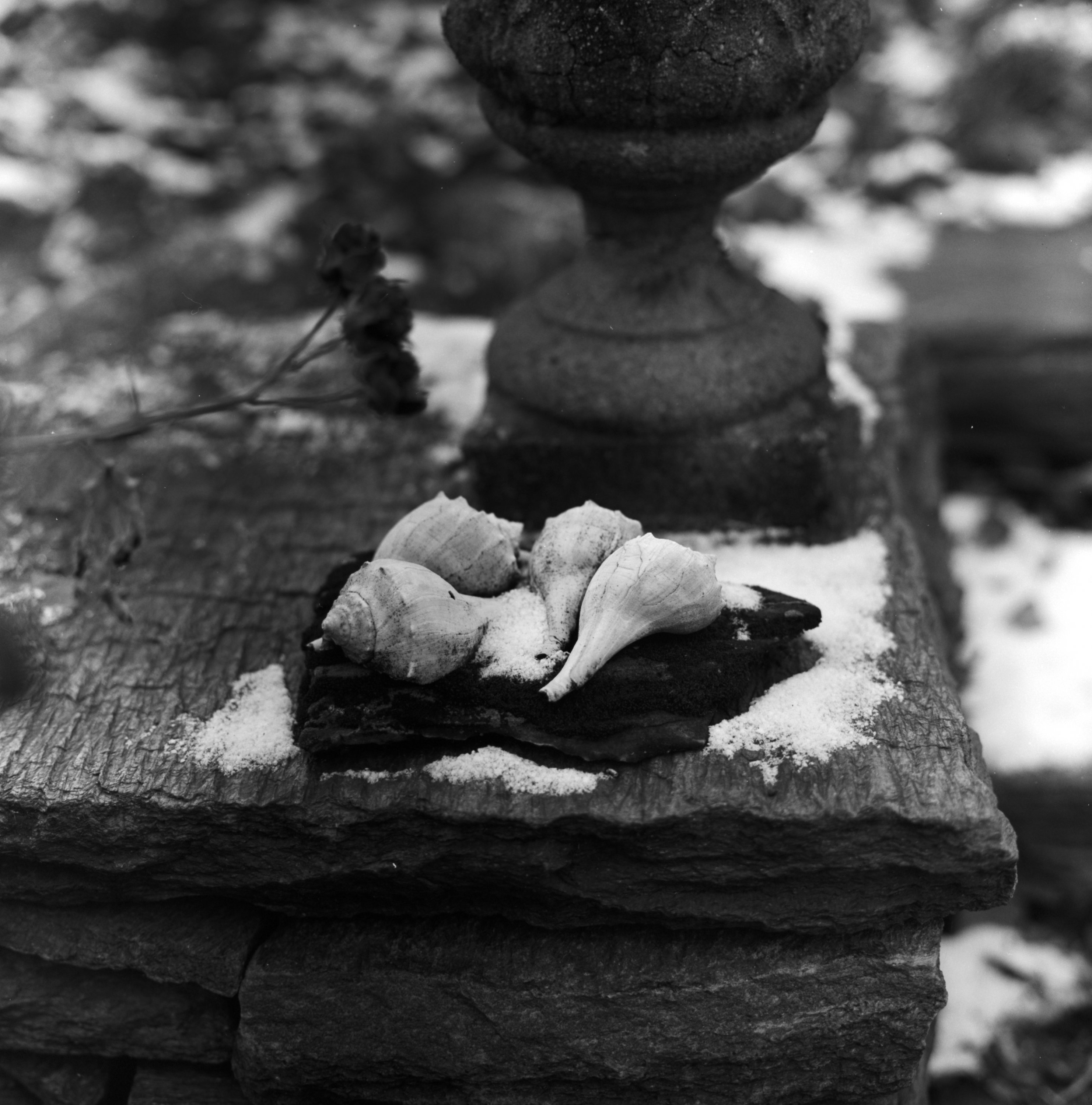

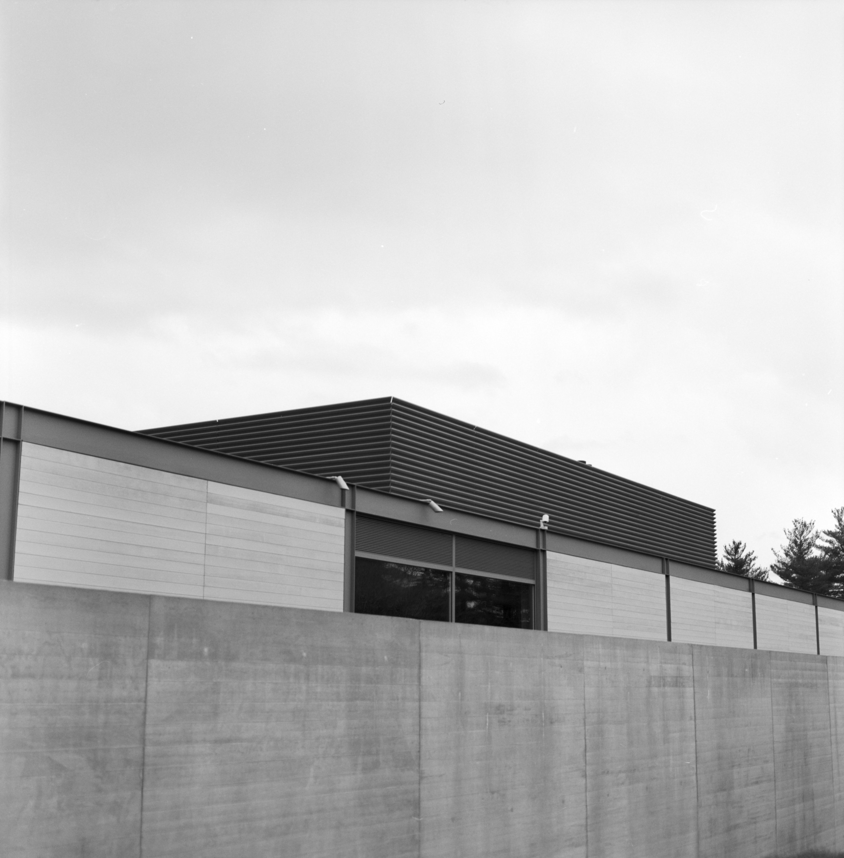

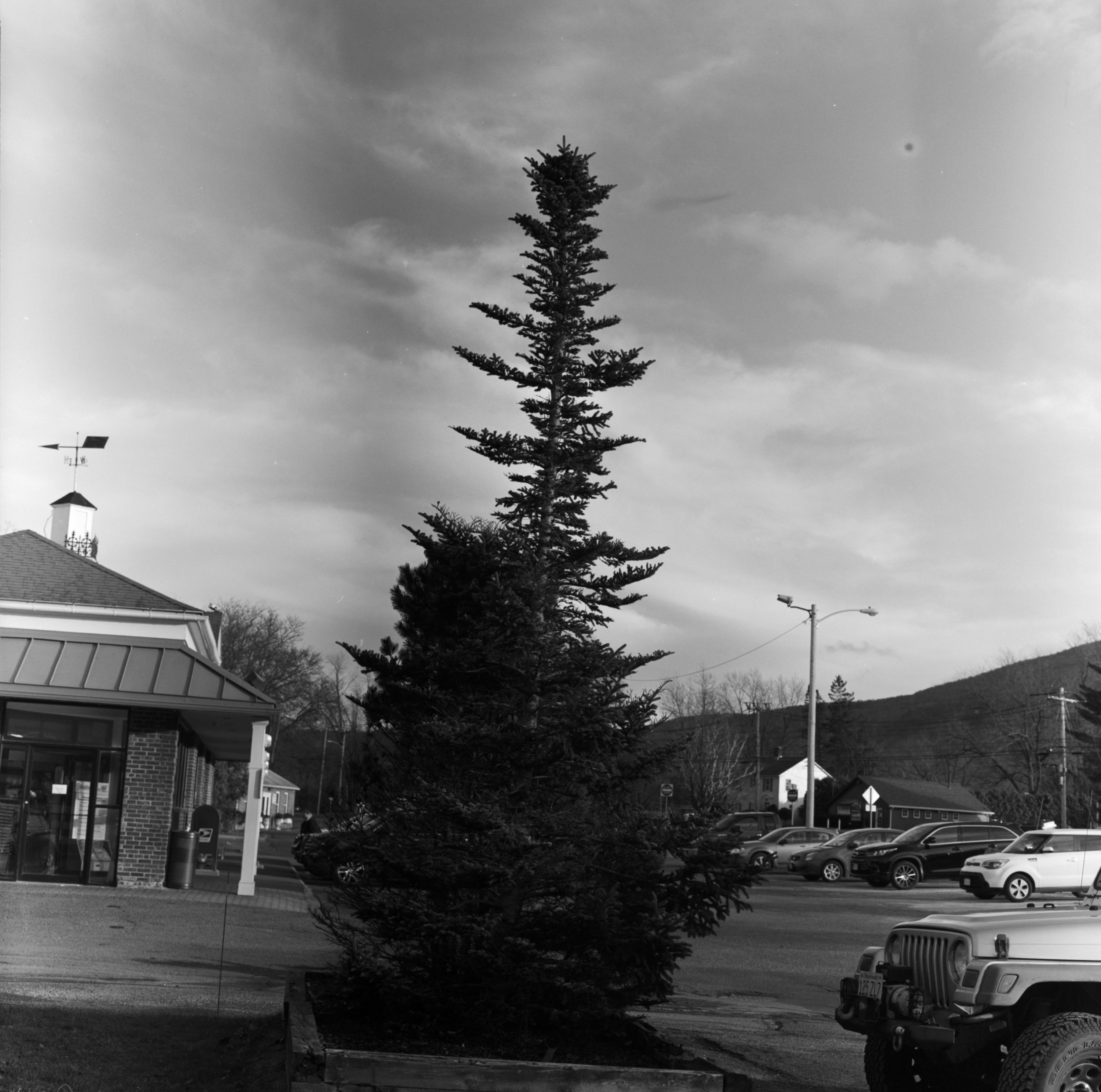

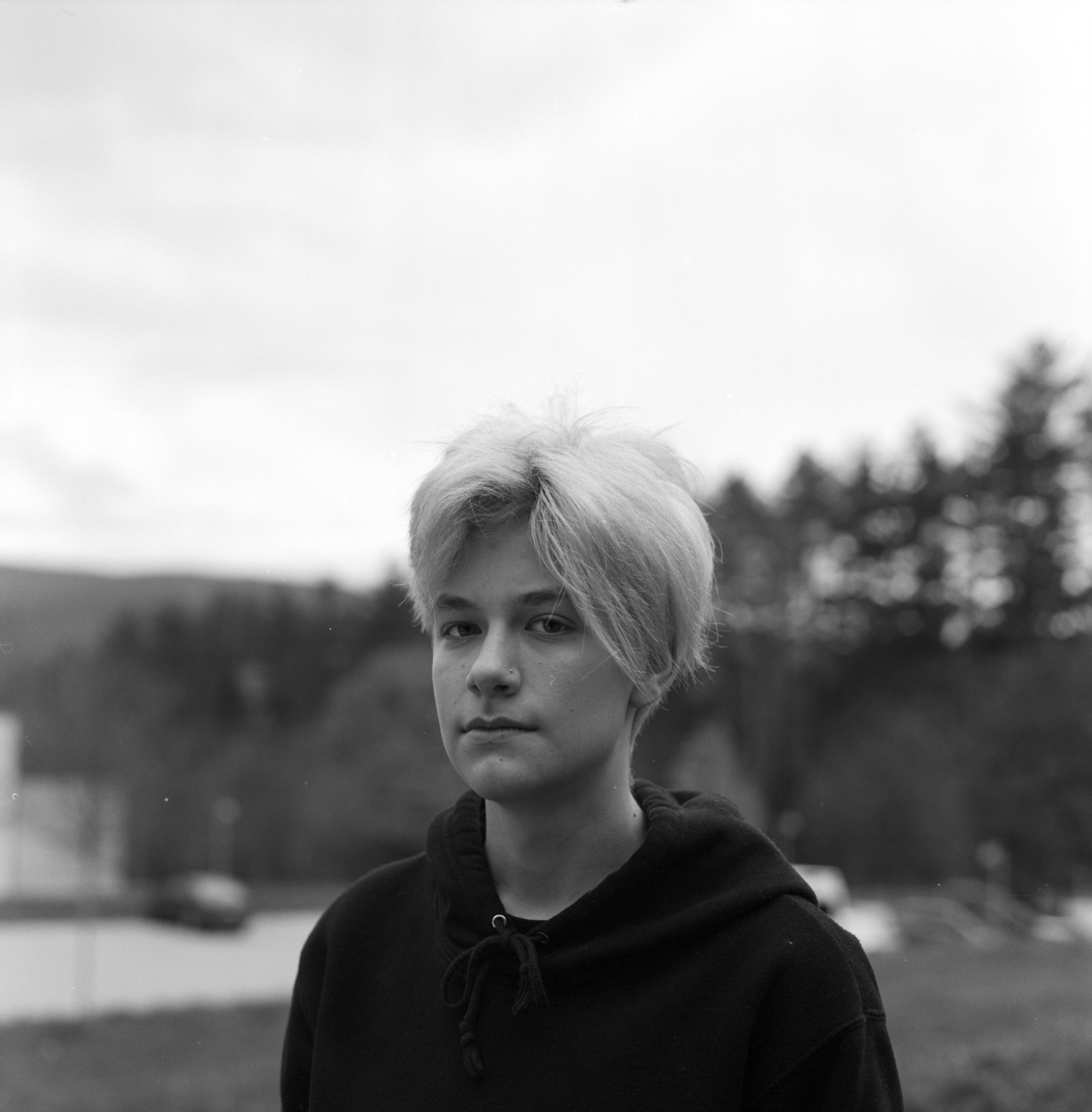

So we had developed the second test roll on the Bronica SQ-A. It came with a ME prism finder which certainly had it's oddities regarding metering so the second roll was shot using the WLF and an external meter. Metering was better but the images have some bars on the sides which look like they could be light leaks or flaring or... and it's not in all of them. It's very subtle but there. It could be:
Film allowed to get a bit loose during loading, or unloading, which could be since when he loaded it, the film ran a bit past the arrow and he wound it back to the arrow.
Flaring, some were shot sort of towards the sun, which was low in the sky, but a rainy day... but they are regular bars, not what you would see in flaring usually.
I'd like to rule out leaks from the back since it's the same back as before, but you never know.
Processing?
or the WLF, can you get light leaks from a WLF? It fits the same as the prism finder, it moves a bit, you can push it back and forth on it's seat.
Too cold film, he gets a little hurried in his excitement to get film loaded!
The last 3 images were shot with the prism finder and do not have the same affected areas.
Any insights would be greatly appreciated, thanks!!!

I don't think this looks like light leaks. Do you see anything on the negatives?
hsandler
Oct 2, 2010
472
Ottawa, Canada
It looks like processing to me, not a light leak. I used to see overdevelopment along the edges sometimes if I agitated the tank too vigorously when developing, creating turbulence near the film edges. When I switched from using a tank with one of those dipstick agitators that rotate the film reel to a Patterson tank which has a lid and allows inverting the tank to agitate, it largely went away, but I'm still careful to do the inversion slowly now. You could try shooting a roll and having it processed by a lab just to change up the development regime to see.

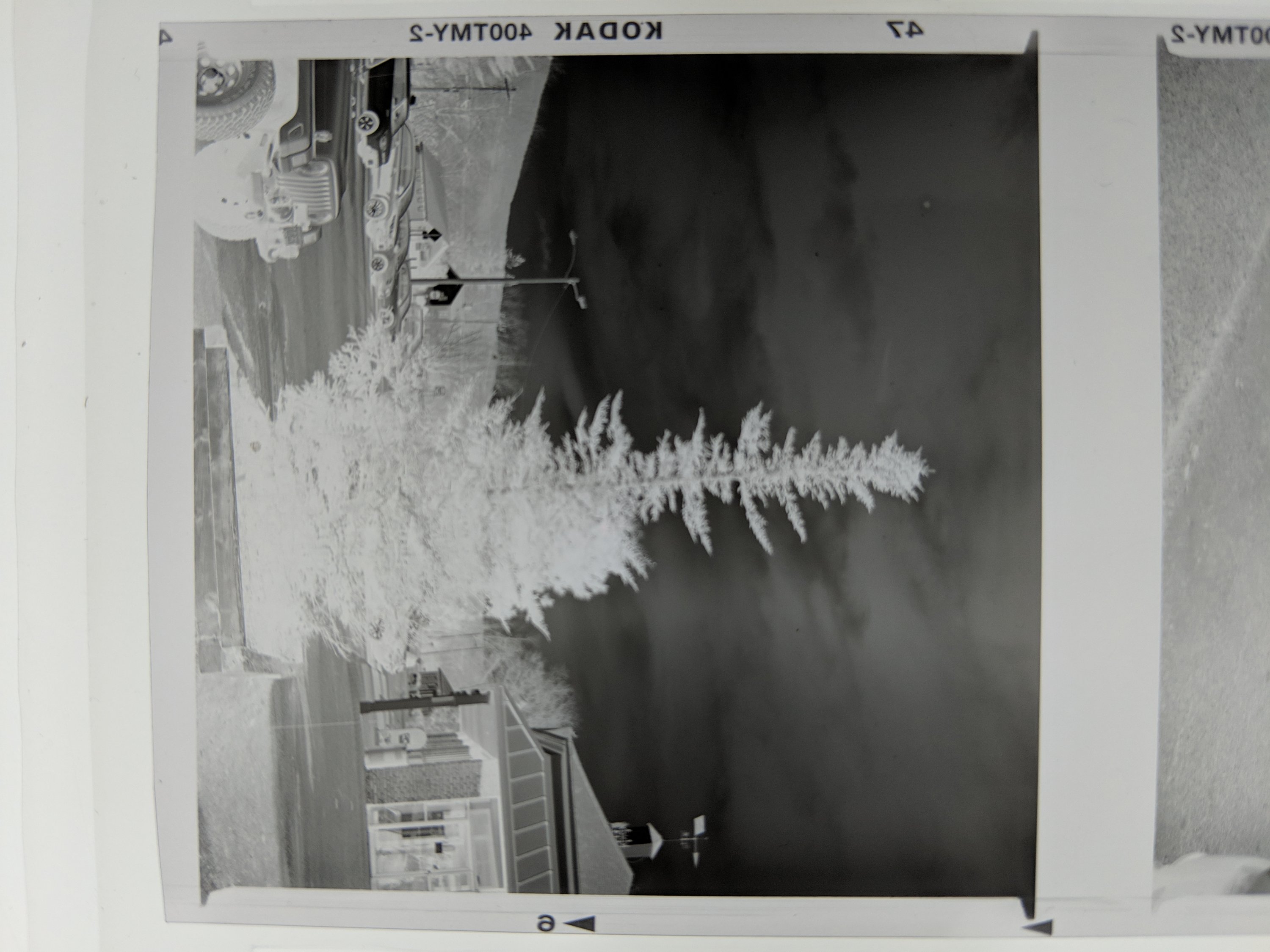

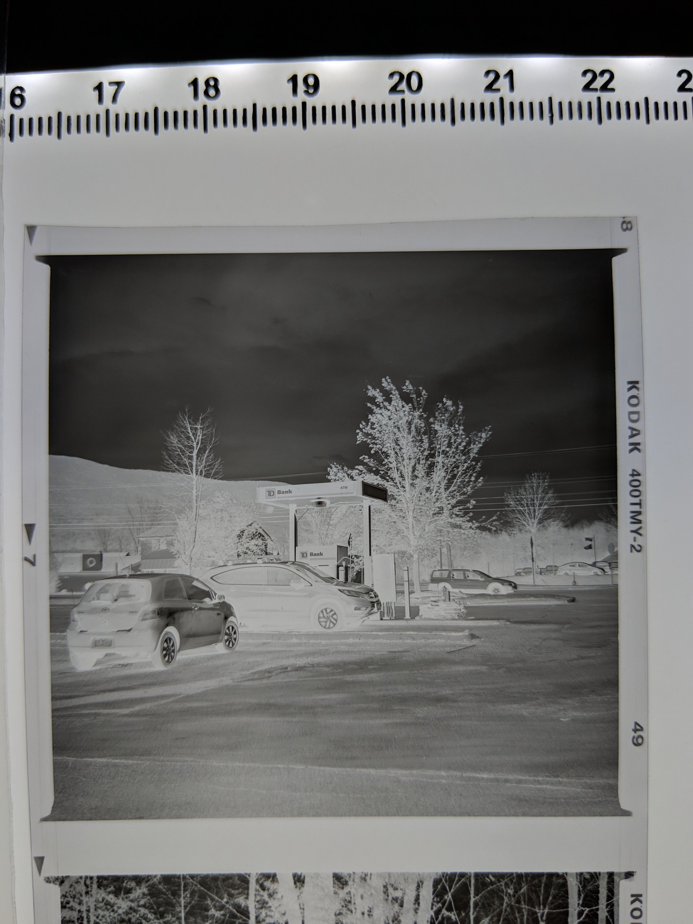

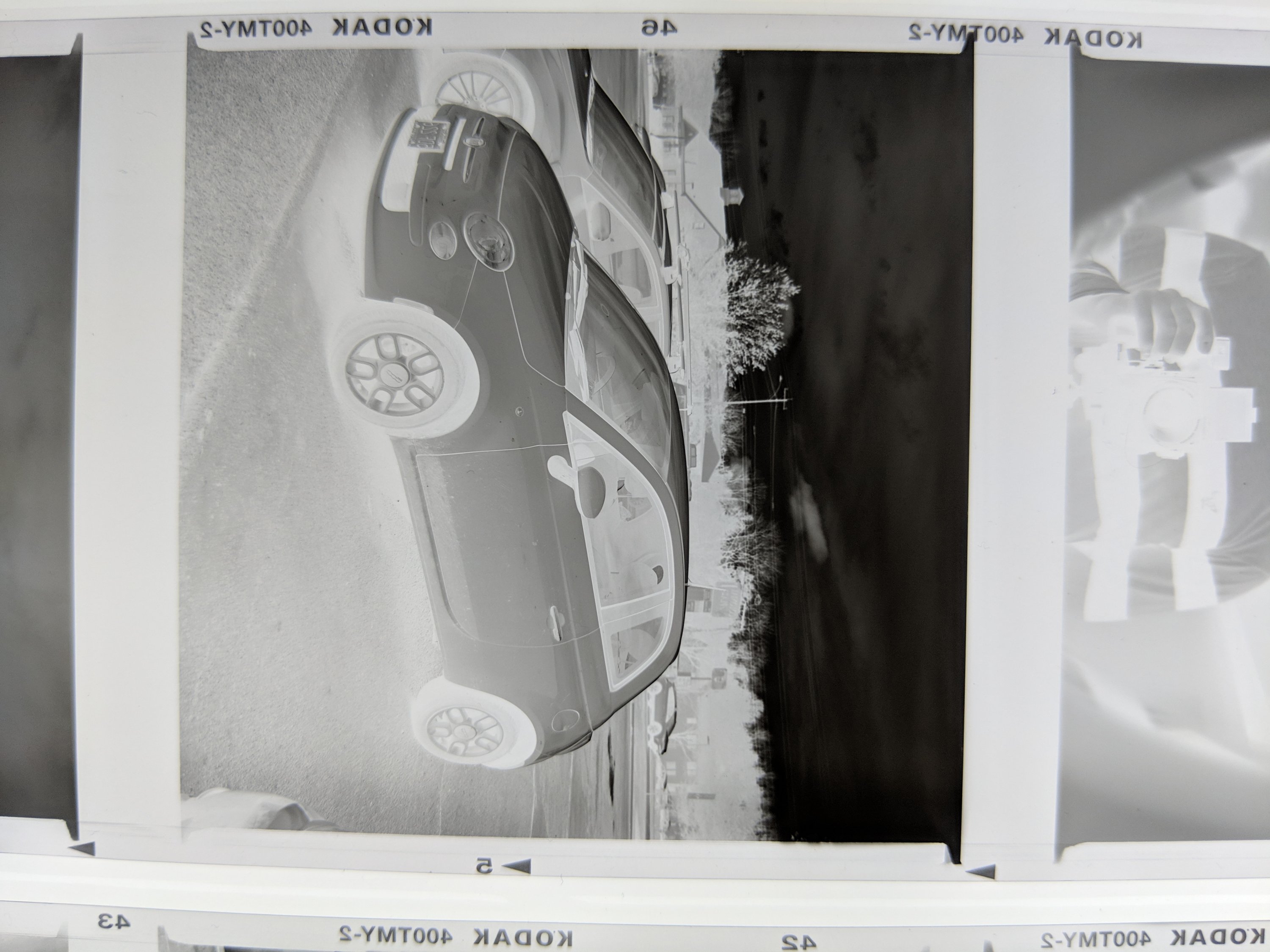

We would need to see a shot of the negative including the outside edges for an accurate opinion. A light leak in the back will show outside the image area. Developing problems can make the increased density as well but only in the image area. A light leak around the mirror may make problems similar without density outside the image area. You can check that looking through the back with a flashlight in the front end without the lens.
Meow7
Meow7
Oct 10, 2016
127
Berkshire County MA

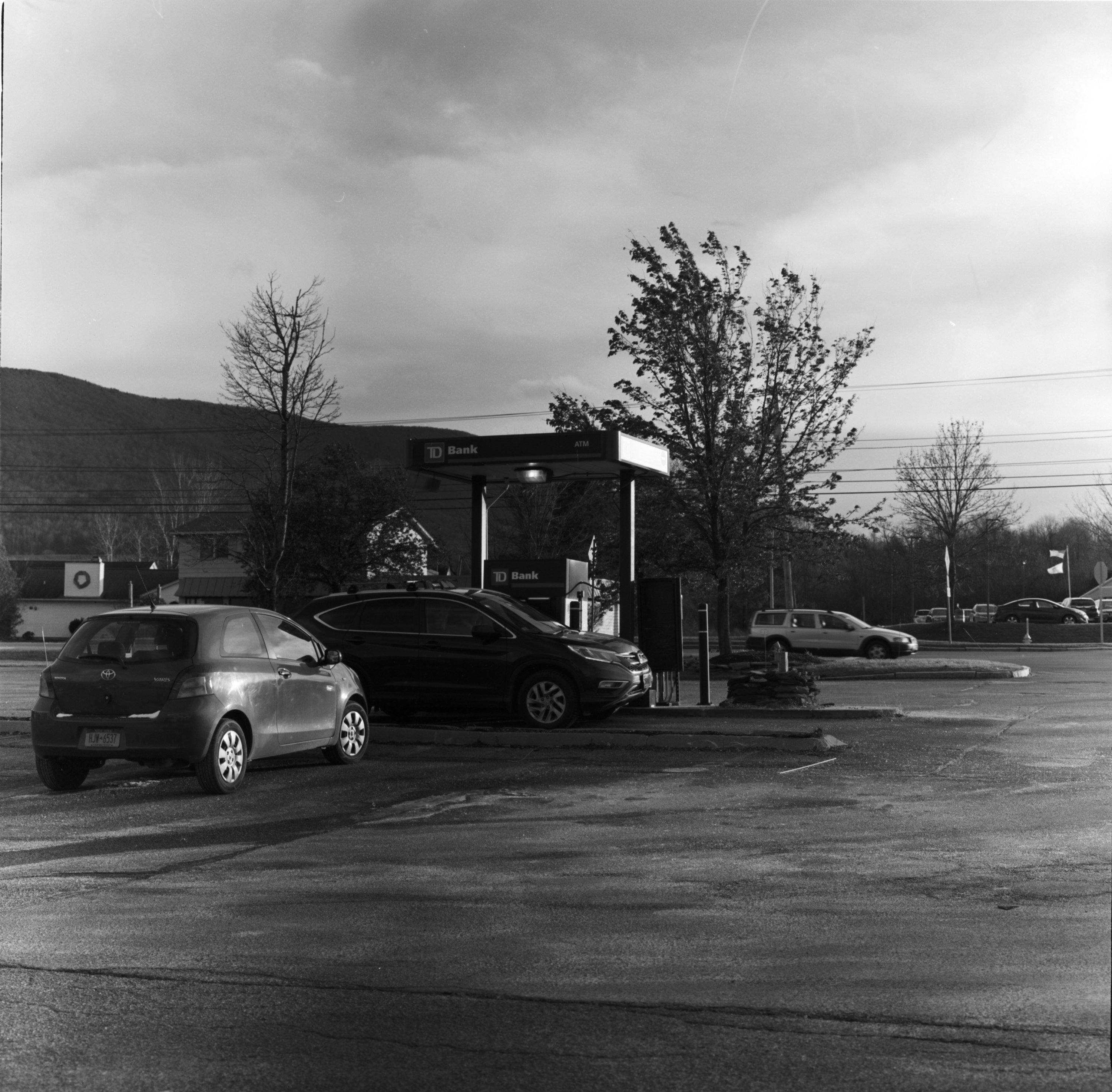

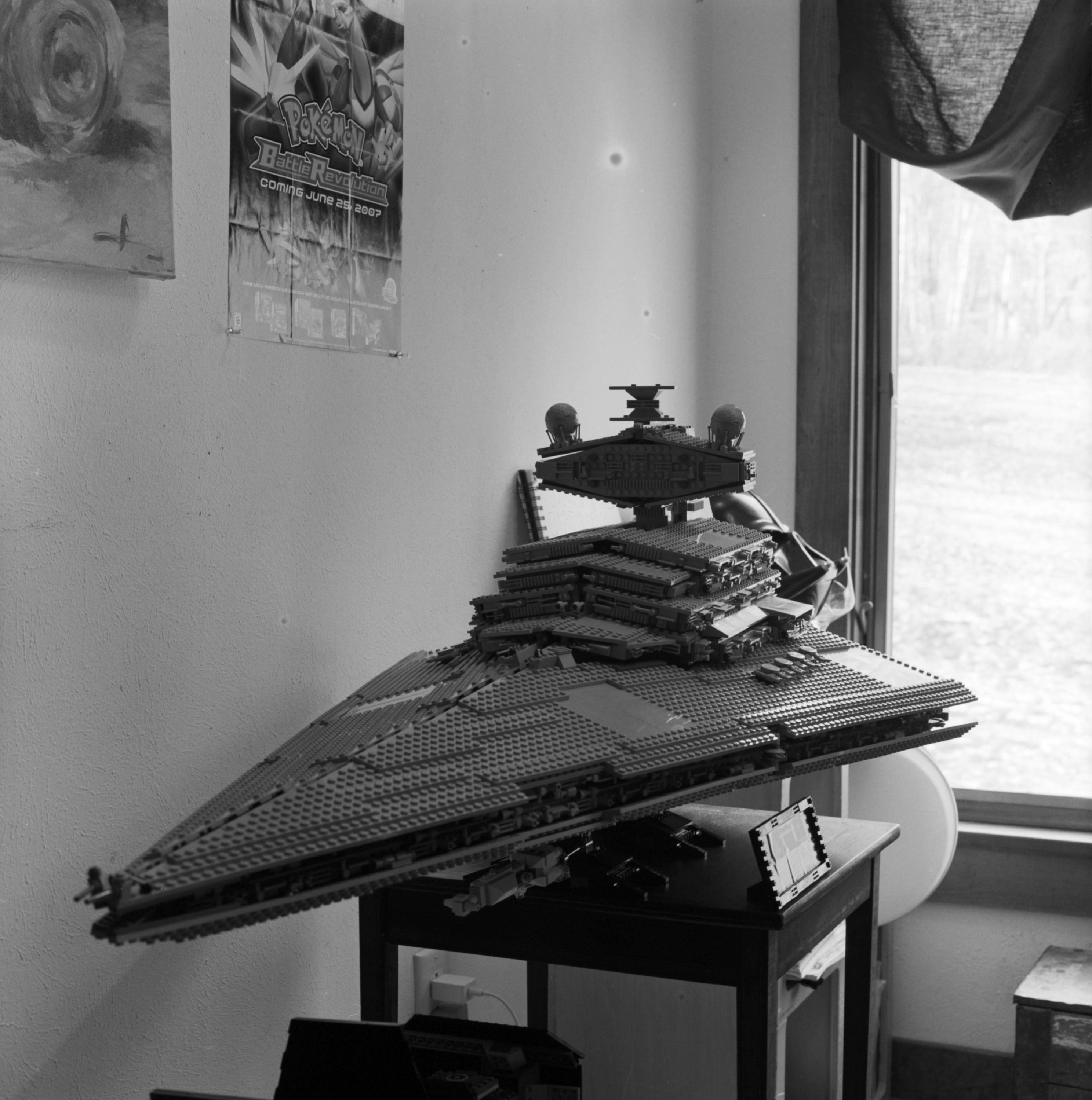

Thanks for the replies, here are some images of the negatives. The outside of the image area is not affected. It could be the pricessing, I developed the first roll and I'm fairly.gentle in my.agitation, my.son did the second, he could have been a bit more enthusiastic with the agitation! It doesn't show up in all imahes tjough, some.shots talken inside seem to.be.fine...

This one seems to be fine, so I am not sure how processing would affect that, unless the processing issue only affected images at a certain point in the roll.
