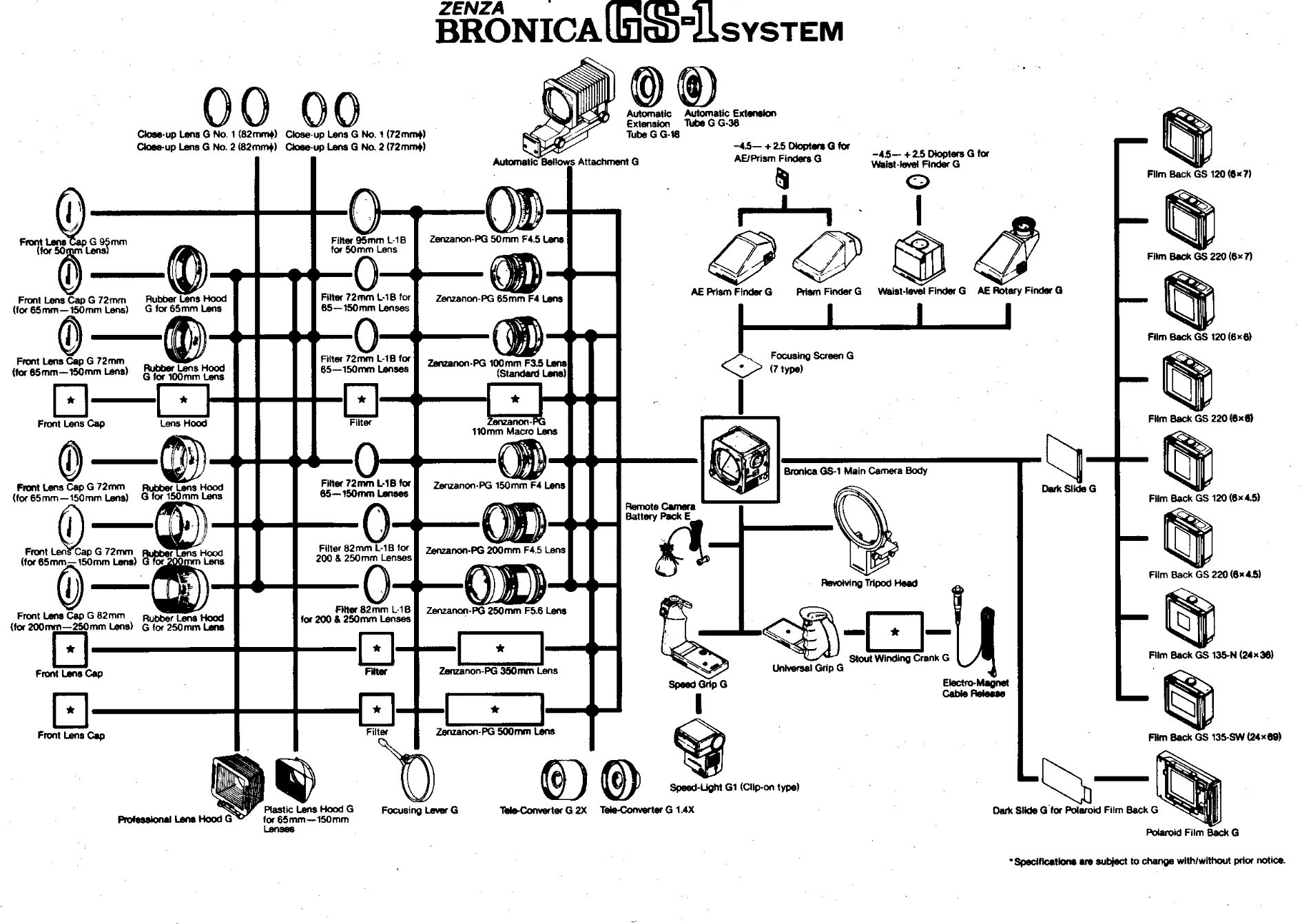

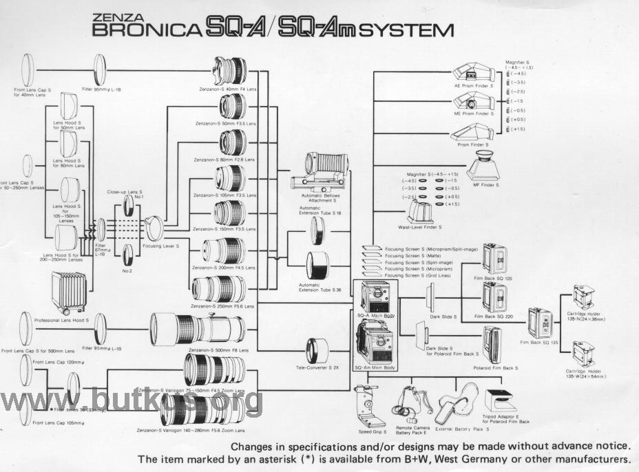

No, the SQ cameras and the GS-1 cameras each have their own set of lenses.
The Bronica GS-1 system (6x7):
The Bronica SQ system (6x6):

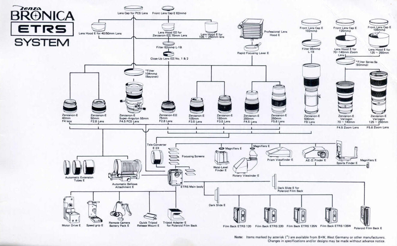

The Bronica ETRS system (6x4.5):

Really helps me pick the Bronica I would go for.
I think I have a slight preference for the GS-1 camera over the SQ camera. For me the 6x4.5 film format of the ETRS is too small.
