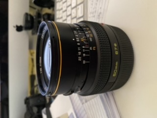

My Japan Post order from April arrived today, containing a 50mm lens. I attached the lens and everything seems functional, but it will not focus on the ground glass. My two other lenses (80mm and 150mm) are just fine. The helical is not binding and the rear element moves in and out, just like the other lenses. Any ideas? I'm thinking something is wrong internally, but I have no idea what. Google is no help, and there's nothing in the manual.

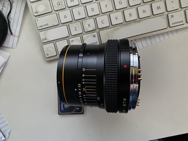

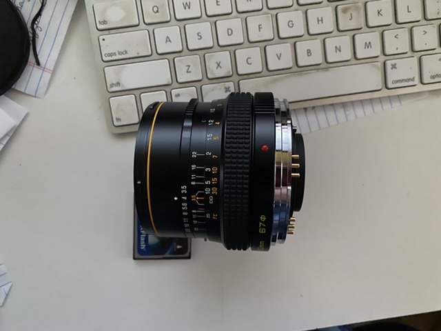

If it does have an extension tube left on it you may have to mount it on the camera to take it off the lens, a good reason the seller may not have realised it doesnt belong there. How about a picture of the lens from the side so we can see?

I'll post a better photo tonight.

Definitely no extension tube on it. Have you looked through it towards a bright light source to see if anything doesnt look right?
