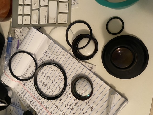

With the focus on infinity, the 50mm lens produces a focused image at a distance of about 60mm from the breech lock. The 80mm lens produces a focused image at distance of about 90mm. The 80mm image seems larger. So, the lens CAN produce a focused image, just not at the film plane. I did locate a schematic for the 50. It has 11 elements in eight groups (see below). It seems possible to reverse one of the central elements, so that's what I'll look for as soon as I can get into it. IF, I can get into it. lol I think I found the spot of locktite as well.

So far I’ve only succeeded in removing the nameplate and the retaining ring for the outermost element, which I put back. Hmmm. I’ll have to give this some more thought over the weekend.

Still working on getting the front elements out. Does anyone know they come out as a group, or one at a time? I got the rear elements out easily, and confirmed the fourth element from the rear is properly oriented.

Got it apart, and (miraculously!) back together. I reversed the center elements (one piece assembly) but it made no difference. It’s like it’s in macro focus. My fingers are in focus when I hold them directly in front of the lens.

Took everything apart yesterday and tried reversing the end element of the large assembly. No change.
