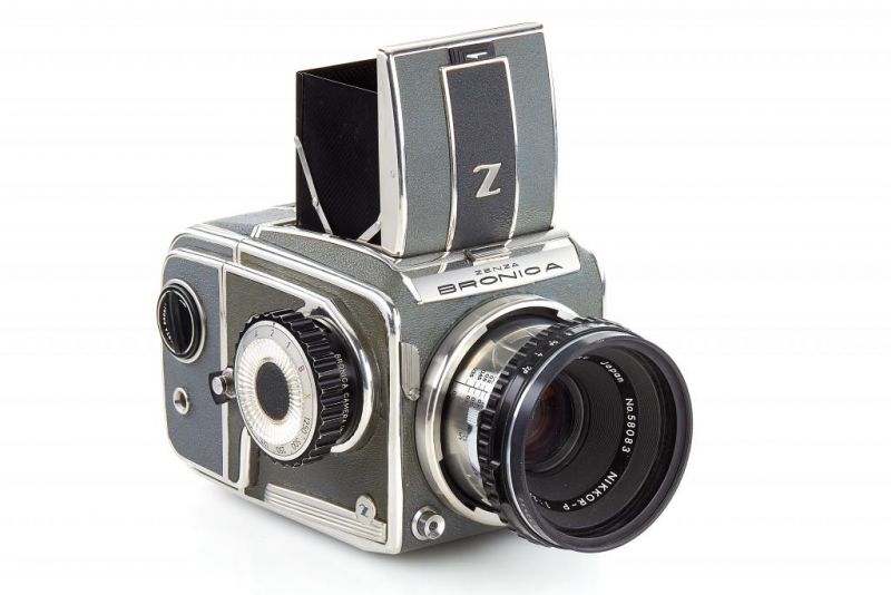

My GAS is rising again ! Had an S2 years ago , sold it after loosing interest in 6x6 , but they were a pleasure to look at :smile: . Peter
Let me introduce you to Mr. C and Mr. D.
