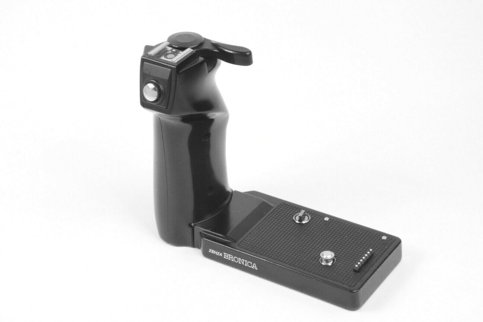

If you look closely at the GS hand grip, it is electronic trigger, not mechanical trigger. When you push the trigger button, nothing moves mechanically.
Deleted member 88956
Yes but that is not the point. Mechanical release will trigger shutter at 1/500 without power, I'm not sure if speed grip mounted prevents mechanical operation of shutter button, never checked on that, but I'd be surprised if it does (and I sure hope when shutter is locked, speed grip is not going to trigger it).

That is exactly the point. GS-1 body is electronically operated. It won't operate properly without battery. The body and shutter are triggered by front trigger button, hand grip or the remote cable. They are all electronic operations and powered by battery. There is even a power switch on GS-1 body.
Hand grip has nothing to do with GS-1 mechanical trigger. There is no such a thing since GS-1 is never mechanically triggered.
Get a GS-1 body and test it...
Fine, still GS1 will trigger at 1/500 and in timed exposure without power, check manual.

The shutter button on the right of the GS-1 body and grip are electronic. However there is a separate mechanical shutter release (mirror pre-trigger) on the left side of the body, which allows 1/500 and T with the camera power off, or battery removed, and is the recommended release for long time exposures to limit battery consumption.
