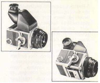

Hi folks,
I ended up buying a multiscope adaptor for the meterless prisms on my Bronica ETRS and realize it's view is too small for me to focus using it. Too bad :sad: Was hoping to use it for street and candid photos (me looking down instead of at the person).
I was browsing the interweb and saw that there's a "rotary finder" option for the ETRS. I'm curious - what's the benefit of a rotary finder?

The eyepiece rotates so you can use it like a magnifier at waist level or an eye level setup.

I have it, and find it less useful than I hoped.
The benefit -- no matter which way the finder is rotated, the image is erect and left-right correct, just like with a prism finder.
The drawbacks:
It's darker than looking into the waist-level screen directly, and harder to focus than using the waist-level with the magnifier flipped down.
I thought it would be a useful tool for when I shoot handheld portraits (allowing me the corrected prism view, even when shooting vertically and shooting from a lower position than eye-level.) But the rotating finder conflicts with either the speed-grip or the Metz flash when rotated to vertical.
I think this finder would work best:
- without a speedgrip or handlemount flash
- on a tripod
- in good light
- where you need the speed of having a left-right corrected image

While an old thread, is there anyone who can offer more input on usefulness of this rotary finder, especially when it comes to focusing vs. WLF? Is it correct it has zero magnification factor?
Deleted member 88956
Resurrecting this thread as there seems to be very little info on this finder. Is it so unpopular?
Meanwhile I have found magnification ratio of 0.81 with supplied -1.5 diopter, so same as plain prism with same diopter installed. AE III in comparison is listed at 0.75 magnification and zero diopter. WLF is 1.15 (and 3.85 with magnifier flipped up).
I'm guessing it should not be much different for focusing then standard prism, which I find quite useful. Any takers on this for comments? Is it darker and harder to focus with then any of the other finders?

This is a specialty finder, not any unpopular. It is popular and useful to some people. Here is what Bronica says about it:
Rotary Viewfinder E- The accessory makes reflex view-focusing very easy, as the eyepiece
rotates 90 deg. to the left or right for view-focusing a very bright and distinct erect image
which moves with the lens. For reflex viewing in horizontal/vertical formats, as well as eyelevel
view-focusing from the side.
Features:
1. Reflex view-focusing in both vertical and horizontal formats are very easy because the eyepiece section can be rotated 90 degree left or right
2. Idea for reflex-viewing from above or reflex-viewing of low-angle moving subjects
3. Easy view-focusing with bright, distinct upright image moving in the same direction as the lens
When you rotate the finder 90 degree, you can flip the camera body and shoot vertical, both ways. You do not need the grip and you can move the camera very quickly and easily. Since this is reflex viewing, it is much faster than the WLF which is laterally-reversed.

Thanks, I have one coming and will give my own side of things. When I suggested "unpopular" it was due to rather small talk about it just about anywhere I looked. Not a problem Bronica material on it, just user actual experience.
Some people do not know how to use it. Some people do not use it often. For the people who use it, they love it.
It is the same as the WLF. Some love it and some hate it for being too slow and cumbersome....

I'll have personal input once I get in a week or two. It does add bulk to the camera in a substantial way, also weight (it's just under 0.5 kg by itself) and I can only hope to see a side benefit from that to make me smile at least once in a while. My main concern is actual viewing and focusing experience vs. WLF or plain prism. Large rubber eye cup can be of help to "sink" eye into the finder and focus on what it shows.
I always enjoy shooting with WLF and this purchase is more about finding the truth and if not too helpful shelve it. Just got a rather rare sports finder for ETR which I think Bronica stopped making quite some time before the whole camera production ceased. Might use it for pinhole set up on ETR.

A quick update on the rotary finder for the ETRS which I have received today. Not much time spent yet, but to get one thing out of the way, rotary finder is significantly darker than WLF (that is expected), and it is also slightly darker than the standard prism. When I get the AEIII prism in a week or os I'll have full comparison for all of them.
As far as build and function goes, it is well made, solid, rotary reflex part moves with confident resistance, large rubber eye cup is comfortable and swing around easily enough to adjust as one might want to depending which way it is swung.
Even though finder is darker, split image on focusing screen behaves as well as with even the WLF. As magnification ratio is far below WLF (0.81 vs 1.15 by Bronica), in many situations it might be problematic to focus with it without a split screen variety.
Finder is also a large piece with weight of some 480g and switching from WLF is expectedly very noticeable. Not really an issue from my perspective, but for hand holding, quite a bit of extra beef. Also camera has different balance, not precisely top heavy to the point of falling over, but handling will need some getting used to.
With eye piece in vertical, camera body drops down like another level from WLF use, so in some cases this would be welcome for easier low shots.
Eye piece on either side puts camera close to face and well face can be used to stabilize the camera. Eye piece in side position almost intrudes into the film back handling wise. I don't see as a problem at all, but I can imagine some users complaining about it.
Eye piece will likely interfere with Speed Grip. I have not tried this configuration yet, but it probably does. I have to spend some time with it to what extent that is the case and whether speed grip is still usable.
Overall the price was about right, so no regrets, but I think anything above 120 EUR is quite a stretch of value vs. usefulness. It is not an everyday add on, unless someone is on a specific project where it helps. It can be used for general shooting, but darkness and ow magnification needs to be considered before leaving home with it and nothing else.
