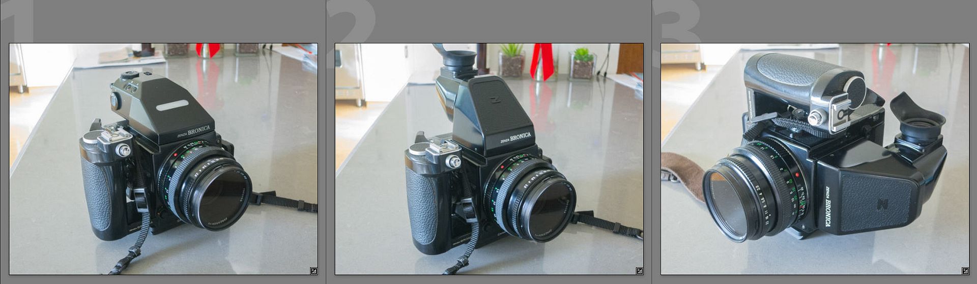

Just took these shots for the thread.
  1. is an ETRSi with Speedgrip and AE-III meter prism
  2. is an ETRSi with Speedgrip and rotary finder in Landscape orientation
  3. is an ETRSi with Speedgrip and rotary finder in Portrait orientation
The offset of the eyepiece of the rotary finder makes it very usable even with the Speedgrip (or any generation of the Motor Winder and even the Motor Drive) mounted.
For the OP to also consider, there is an accessory L finder that slides onto the eyepiece of the non-metered eye-level finder, but it does not slide onto the AE-III meter prism
https://www.ebay.com/i/264497459189...gj51dsb93D4ZpuHX5-9Ge-AnNXQmpHnsaAgwAEALw_wcB
Methinks the rotary finder is simply less popular than using an eye-level finder, so fewer were made/sold, not that it is a poor design. The rotary eyepiece has click stops for 0 and 90 degrees, but a sufficiently tight rotary motion to hold its position easily even at odd angles, although the corners of the focus screen are clipped when the rotary finder is at odd angles. The rotary finder weighs 15.5oz, compared to the AE-III weighing 12.3oz.
