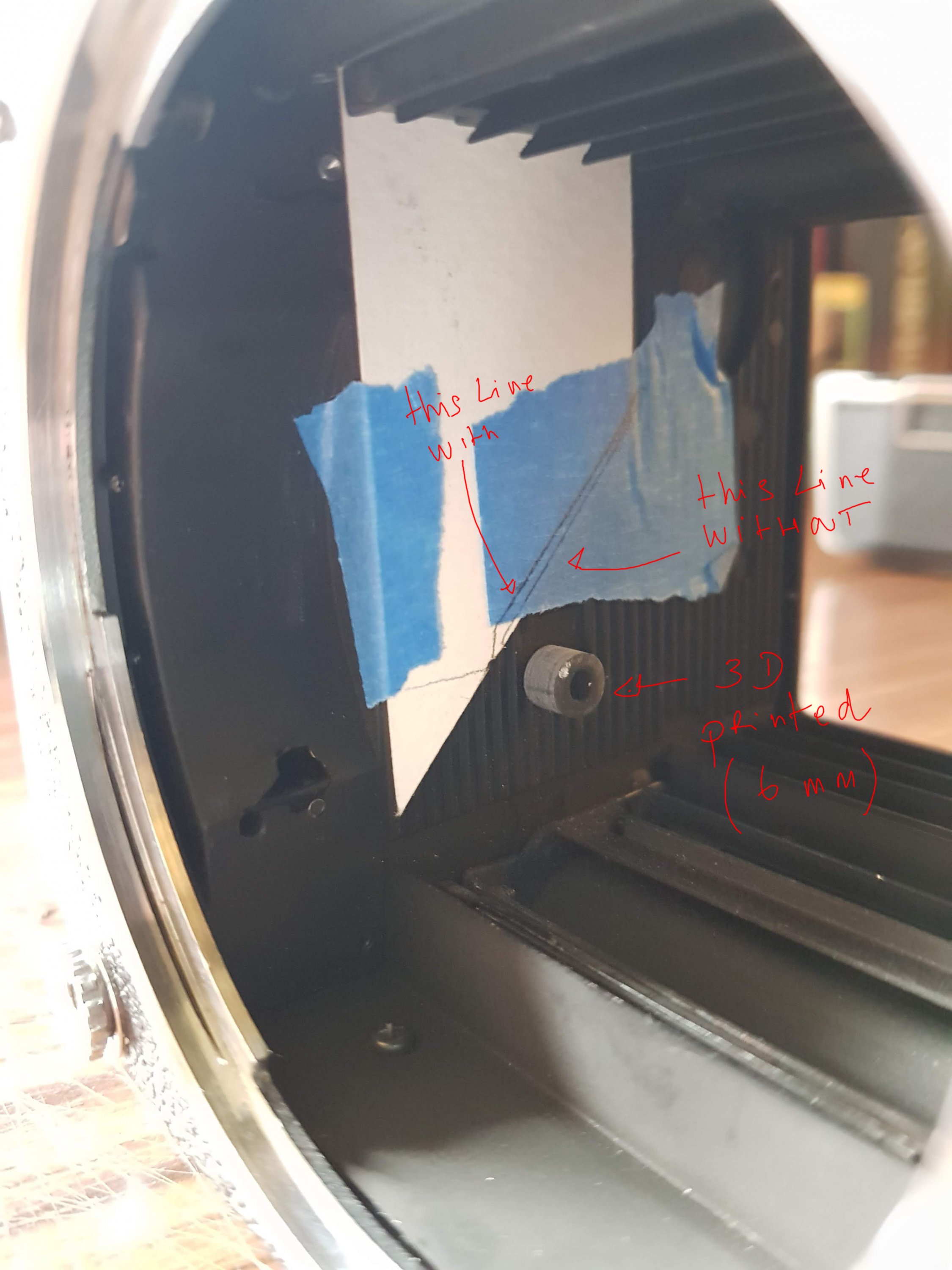

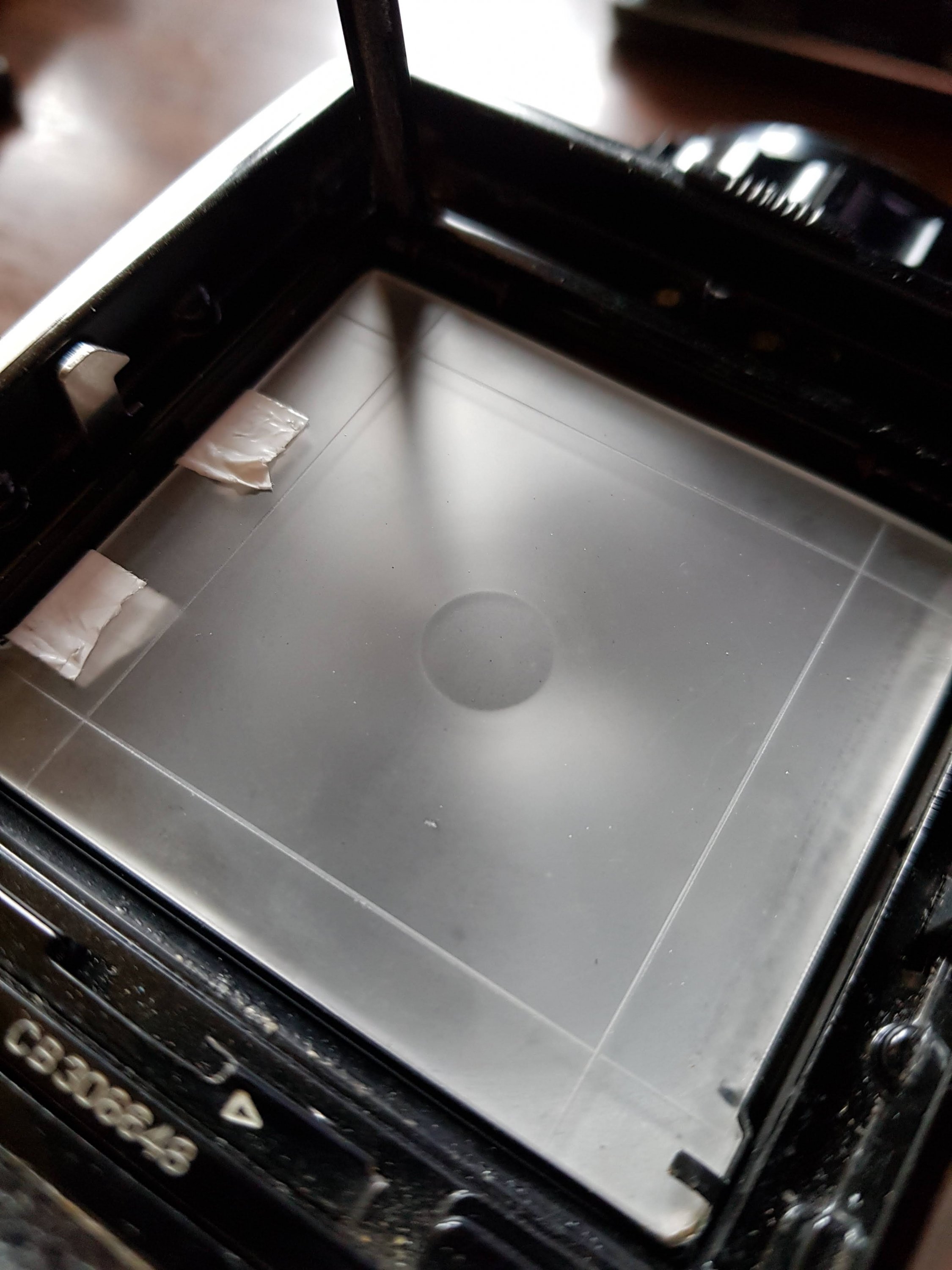

I'm trying something, I know it's not ultra precise, but :
1 : with my 3d printed bumper and the GG, this side (like others says, the "good" side) i CAN'T reach infinity
2 : with the same 3d printed bumper and the GG on the other side, it seems i can reach infinity

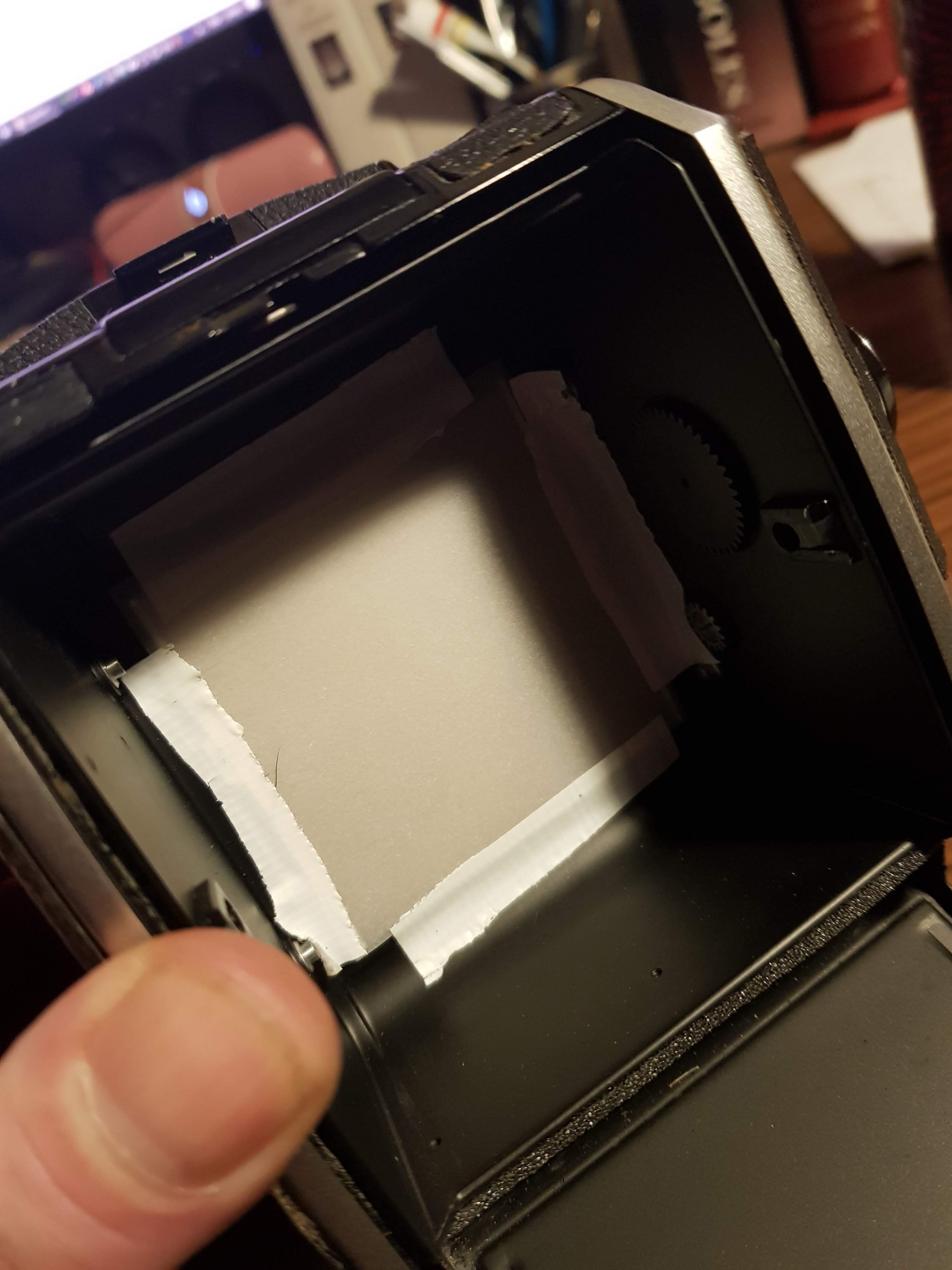

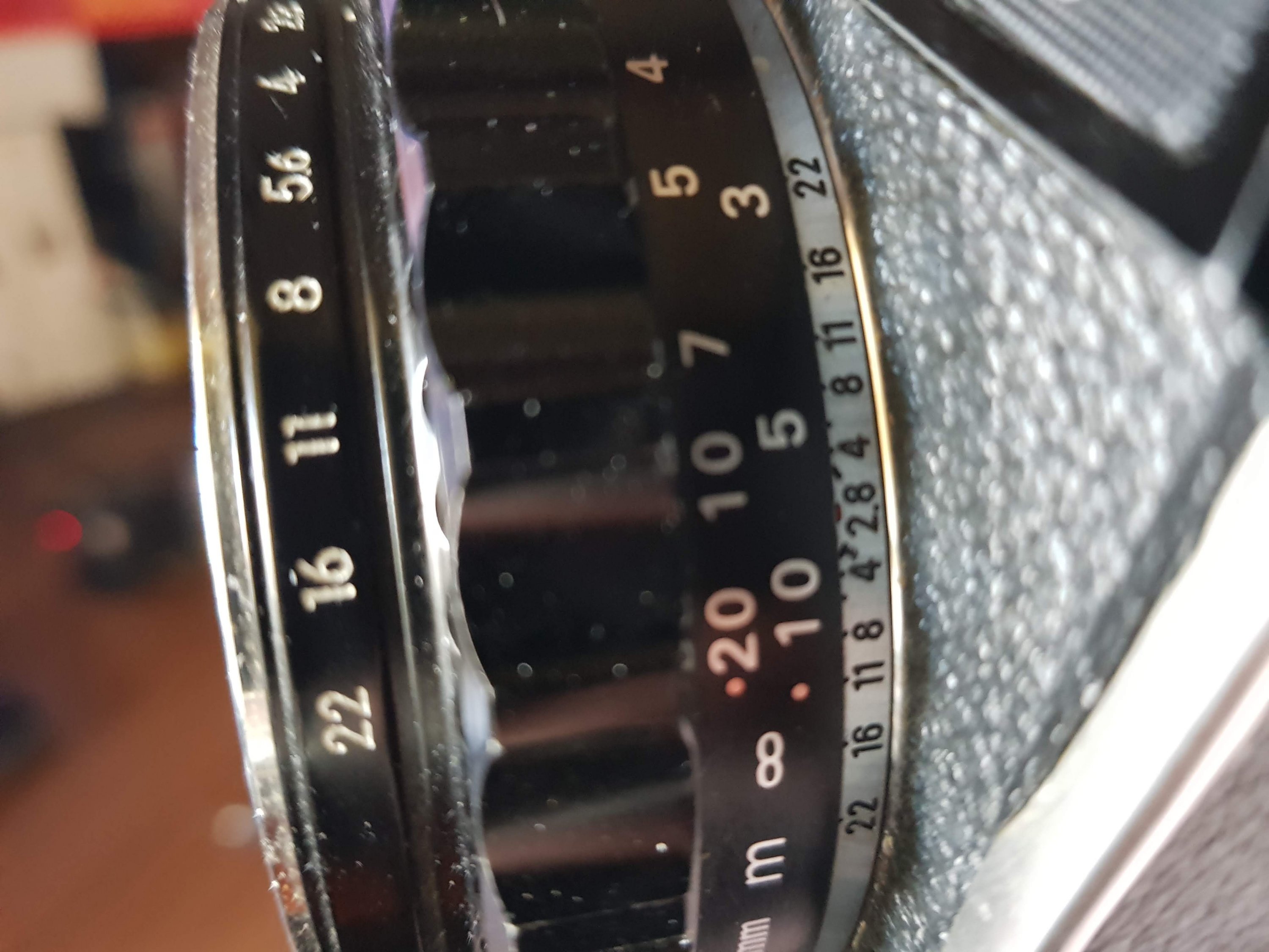

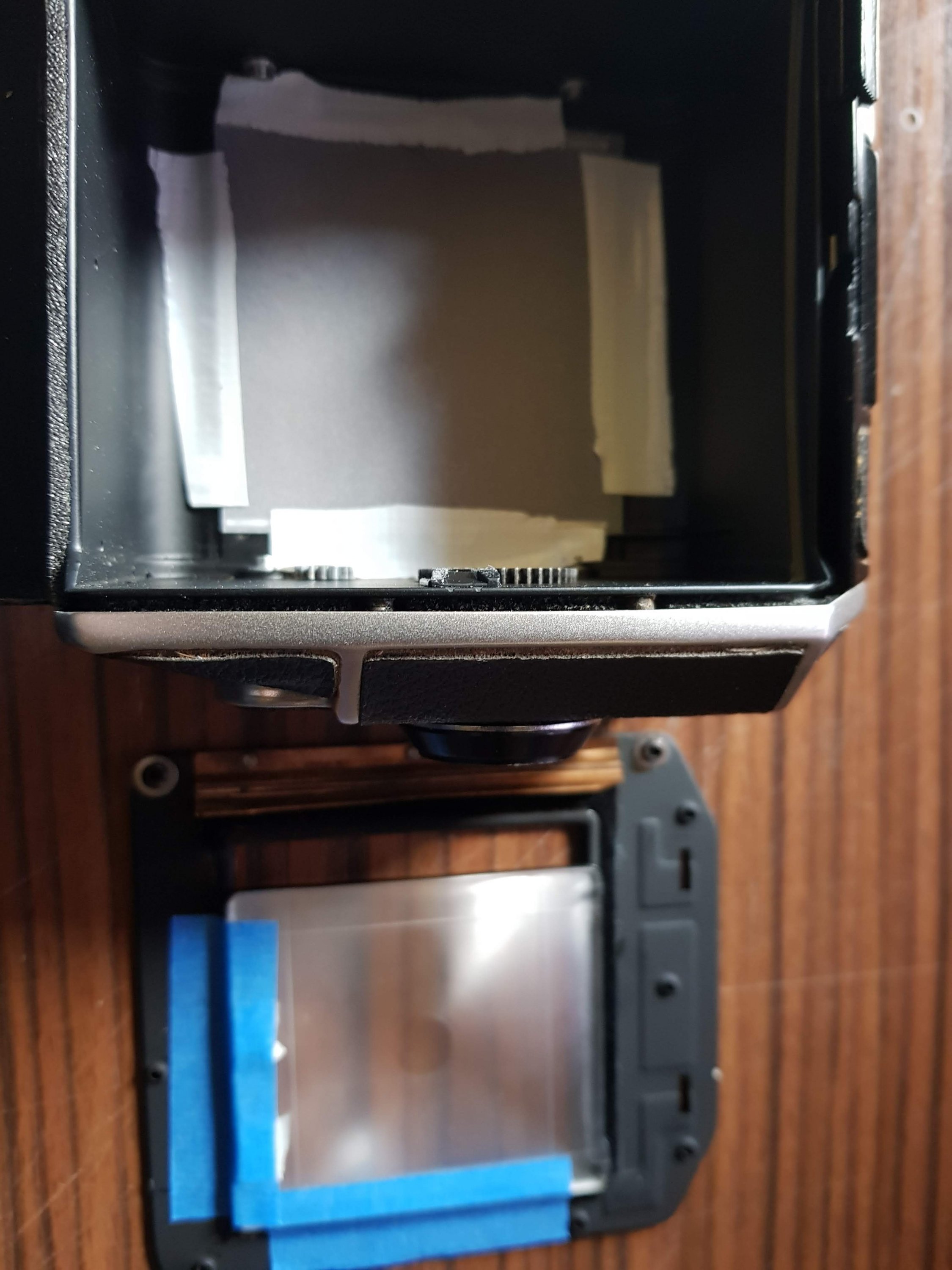

i've checked helical, and it's good it focuses to infinity with tracing paper (checked with a lupe):
so now i'll try to find the axe of mirror with printed protractor taped on a side, if you have better ideas your welcome :tongue:

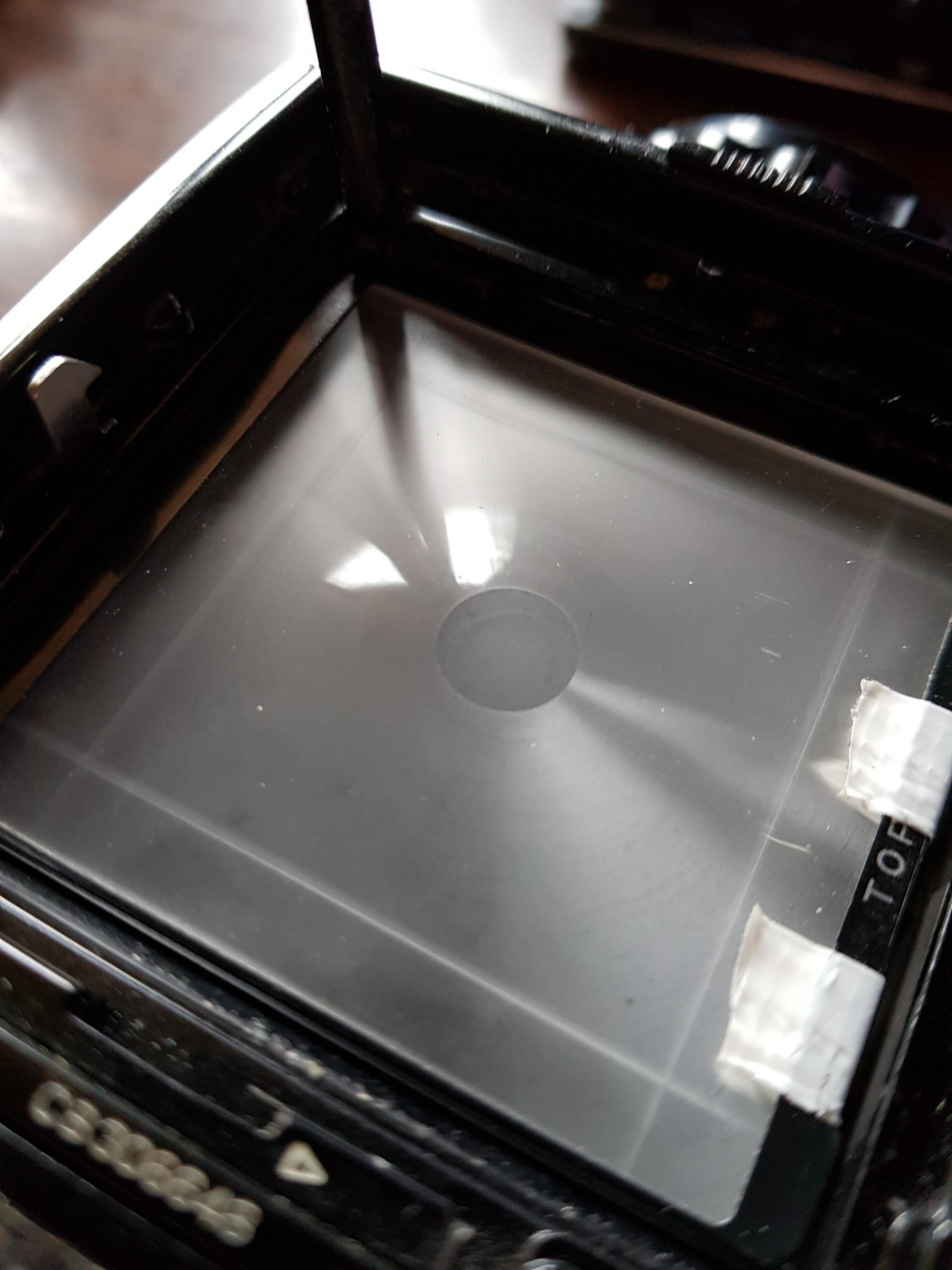

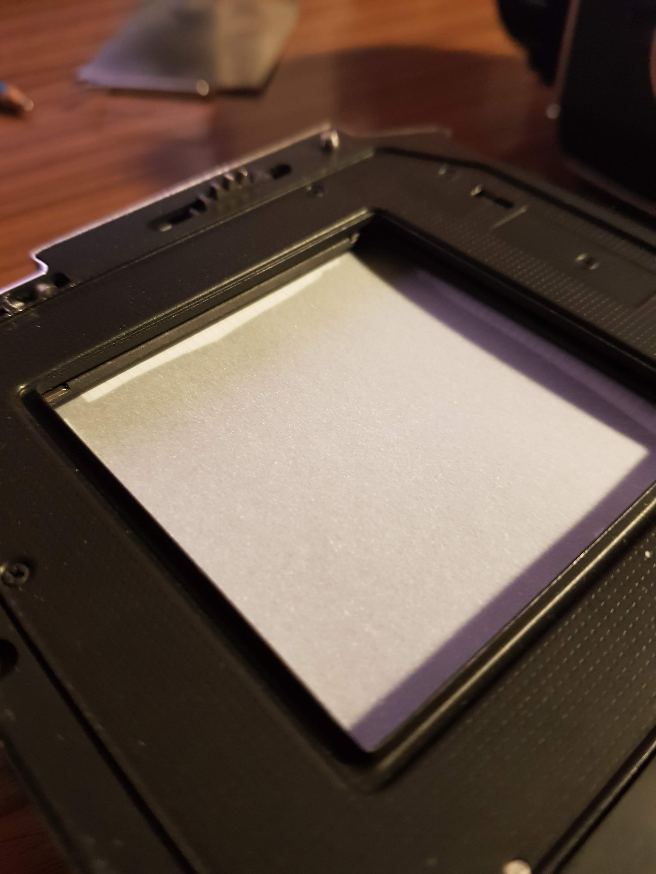

I did a check again and i don't understand what does it mean :/
1 > with the original ground glass (frosted toward lens)
2> with tracing paper

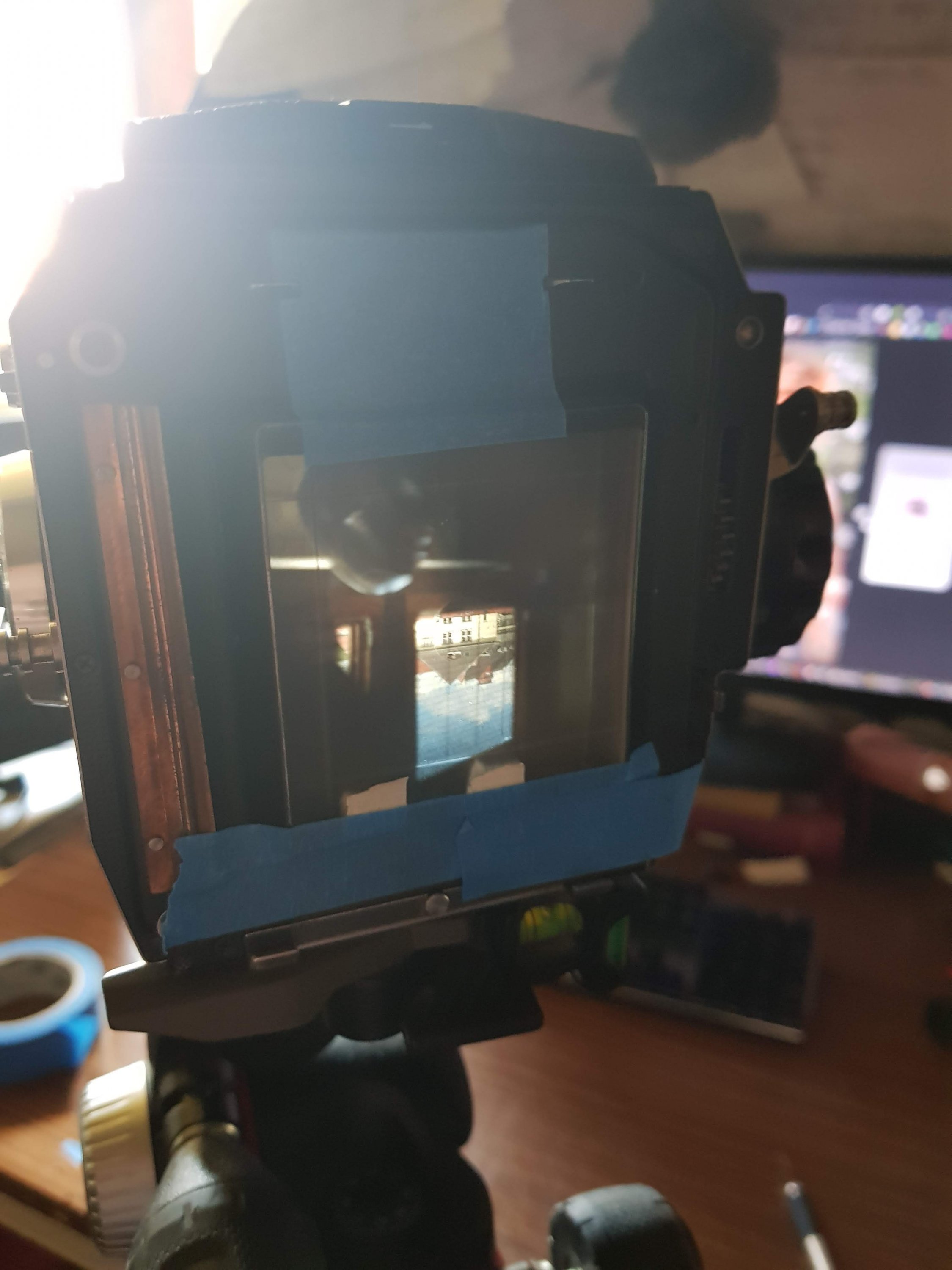

This means the mirror isn't aligned correctly or the waist level GG needs to be adjusted.
If you can focus at infinity using a GG or tracing paper here, your GG is not at the film plane. You need to have the back on, insert removed to be able to put the GG at the film plane. In these photos, it is directly on the camera body which is a few mm forward of the film plane. Thus, you are unable to focus to infinity where infinity is supposed to be on the helical.
The waist level GG and film plane GG have to agree at infinity. It's not likely that the film plane will be incorrect so you either have to adjust the height of the waist level GG or adjust the mirror to match the film plane.
If, when you think you have them in agreement, you focus on a plane perpendicular to the camera (e.g. brick wall), you can check mirror alignment. If the brick wall is in focus top to bottom, then the mirror is probably close enough to call it good. However, if either top or bottom edge is out of focus. the mirror is not at the right angle. The top edge would be more easily seen as out of focus since the bottom edge of the mirror would be physically farther out of position than the top edge of the mirror.

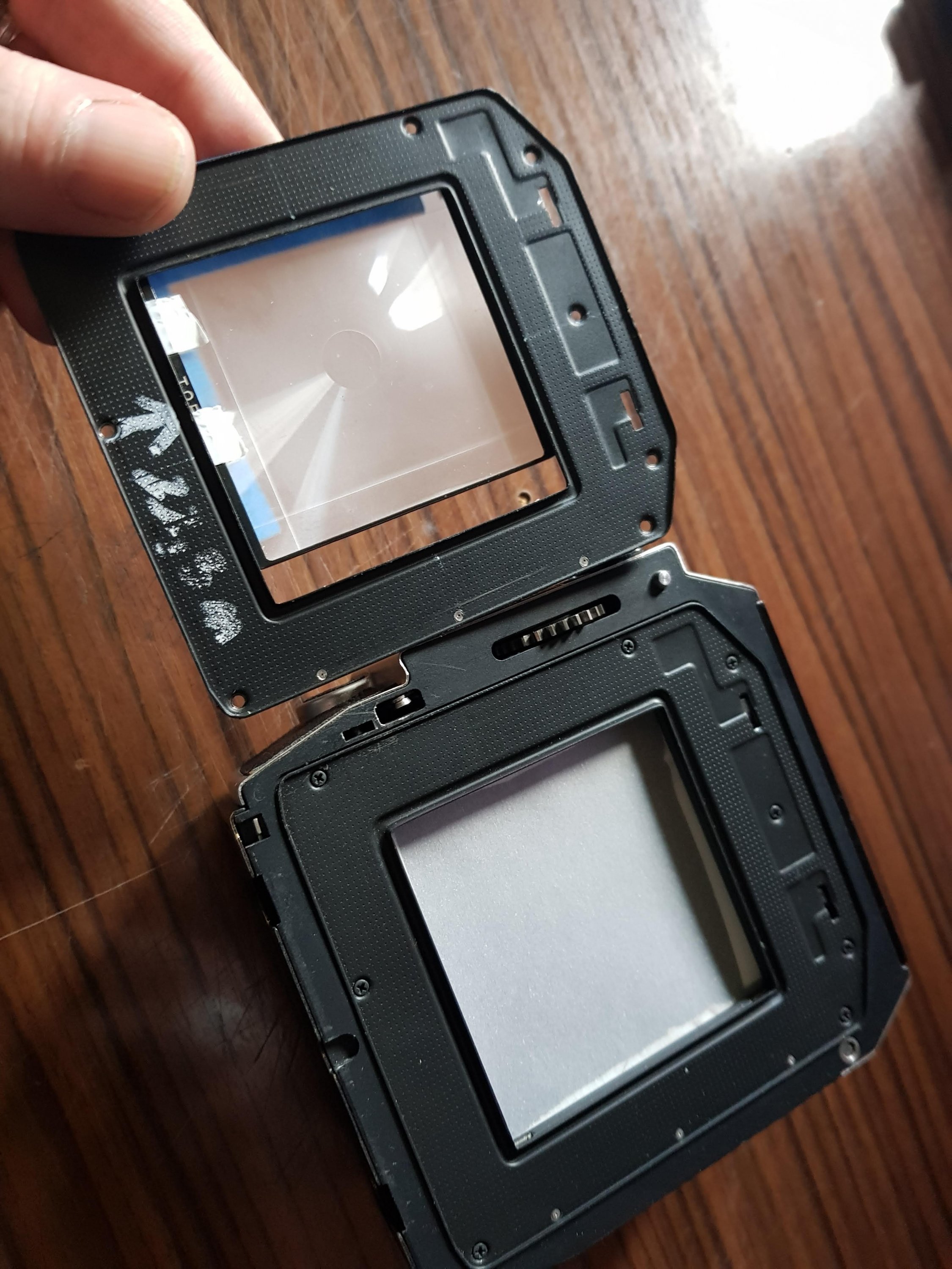

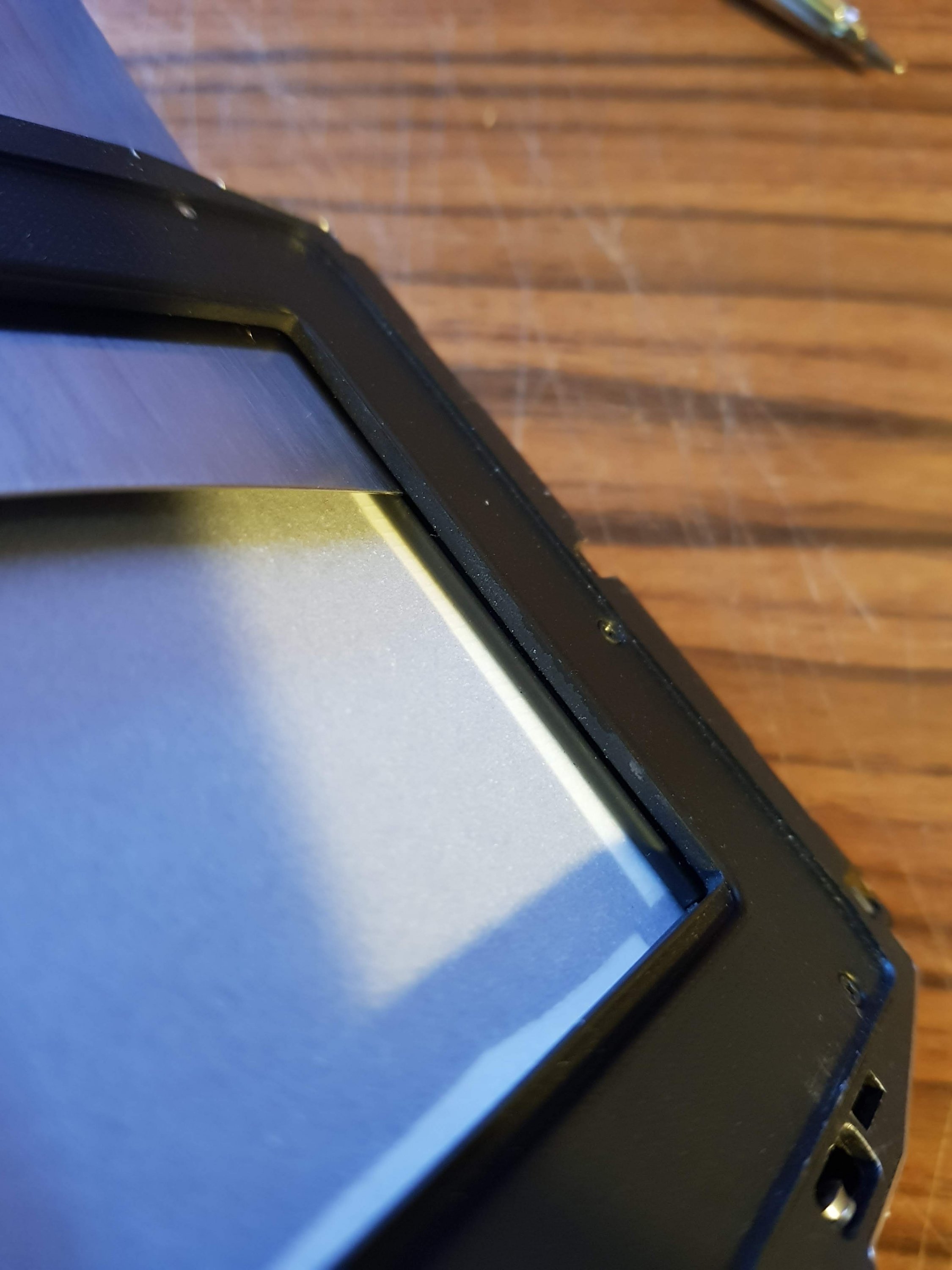

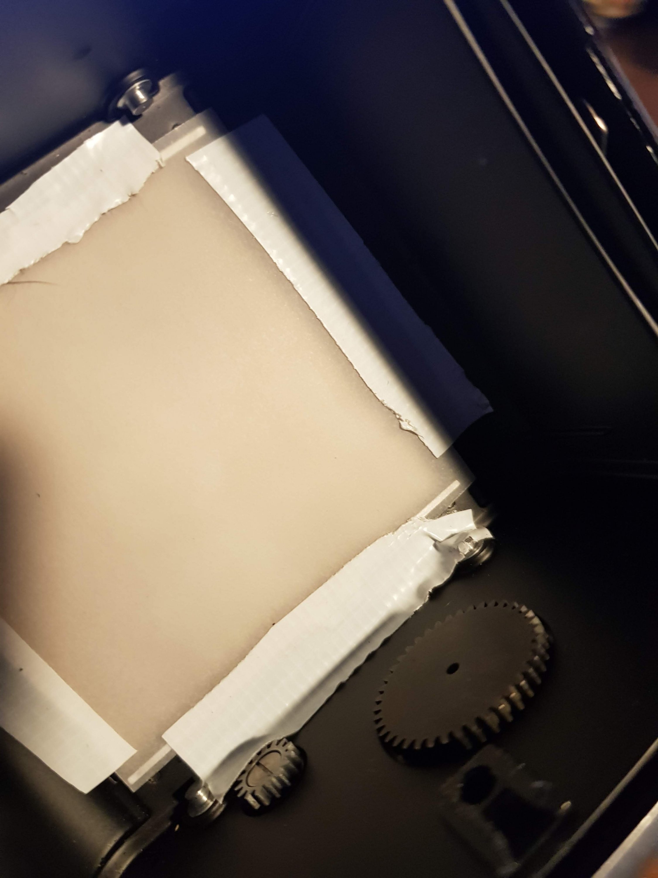

Same distance I use "frame" from a broken back
choiliefan
Dec 27, 2013
1,314
Your tracing paper is exactly the same plane as the film would be when loaded?
It appears closer to the body in the pics, no?

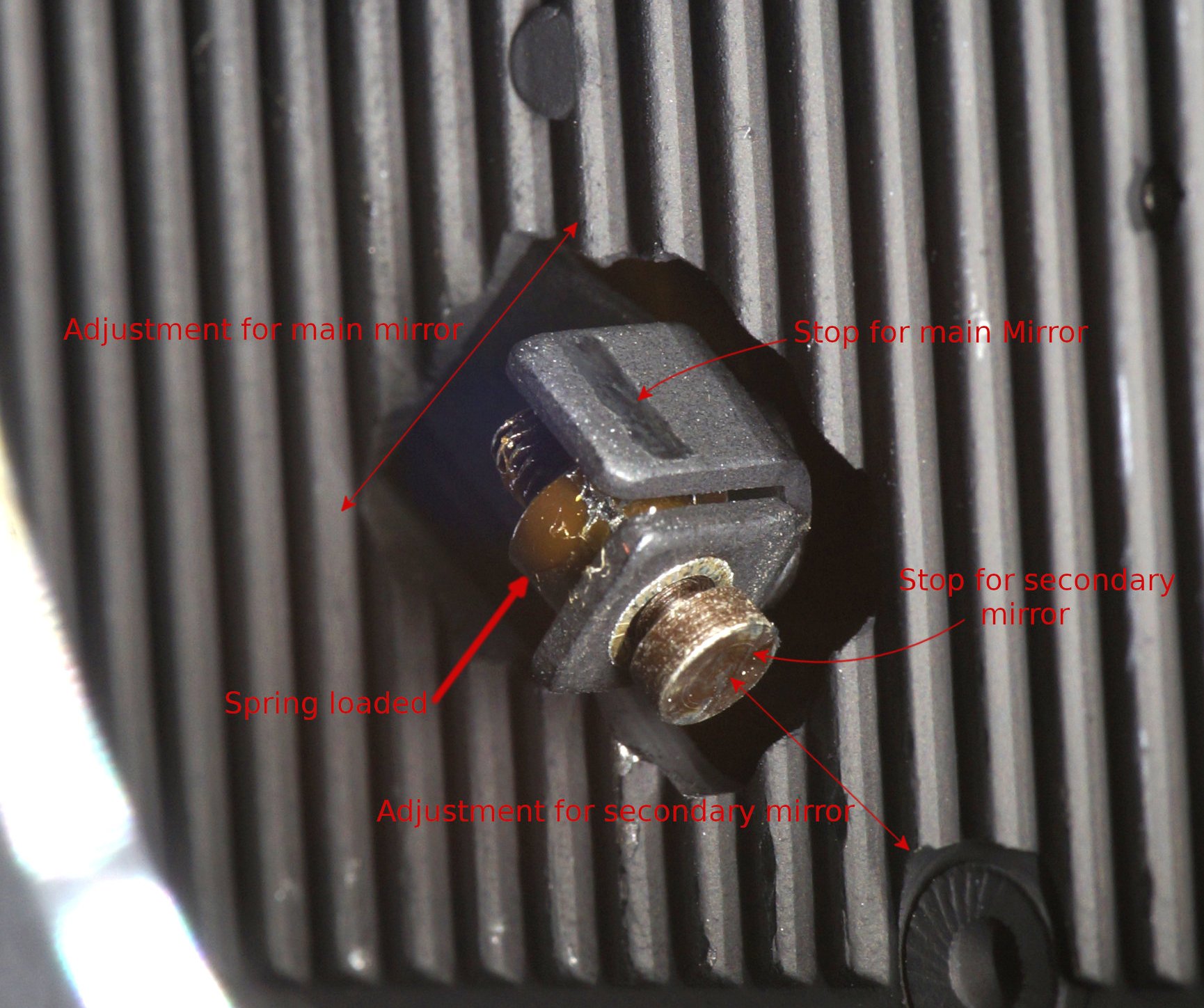

Its been a while since I worked on a EC-TL.
Before you adjust anything, check the reflection of some object on the mirrors (ie, the lens mount or focus screen) and check to see if the mirrors are aligned. If the reflection across the mirror looks aligned, then do not adjust the stops. That is my advice.
Also, check that the mirrors are properly mounted in their carriers. Cover the secondary mirror and check the view. Then the primary mirror.
This is what my mirror stops on my EC-TL looks like.
The black metal arm with the flat stop for the main mirror can be adjusted up and down from the other side of the mirror box, you will have to disassemble the camera to get to it. The round screw like thing with the flat head threads in and out to adjust where the secondary mirror stops when it swings up. You grip the head with a special cup-plyer to turn the head (early Hasselblad had similar adjustment screws). Again, easier to do with the camera disassembled. These adjustments are not easily accessible because they do not usually need to be done.
The whole mechanism is spring loaded so when the mirror comes down, the spring, along with the rubber bumper on the other side, can cushion the main mirror's return.
Again, do not adjust it if it does not need it. Make sure everything else is checked first. I've warned you.
Of course someone else may have already done that, which is why it's off...
