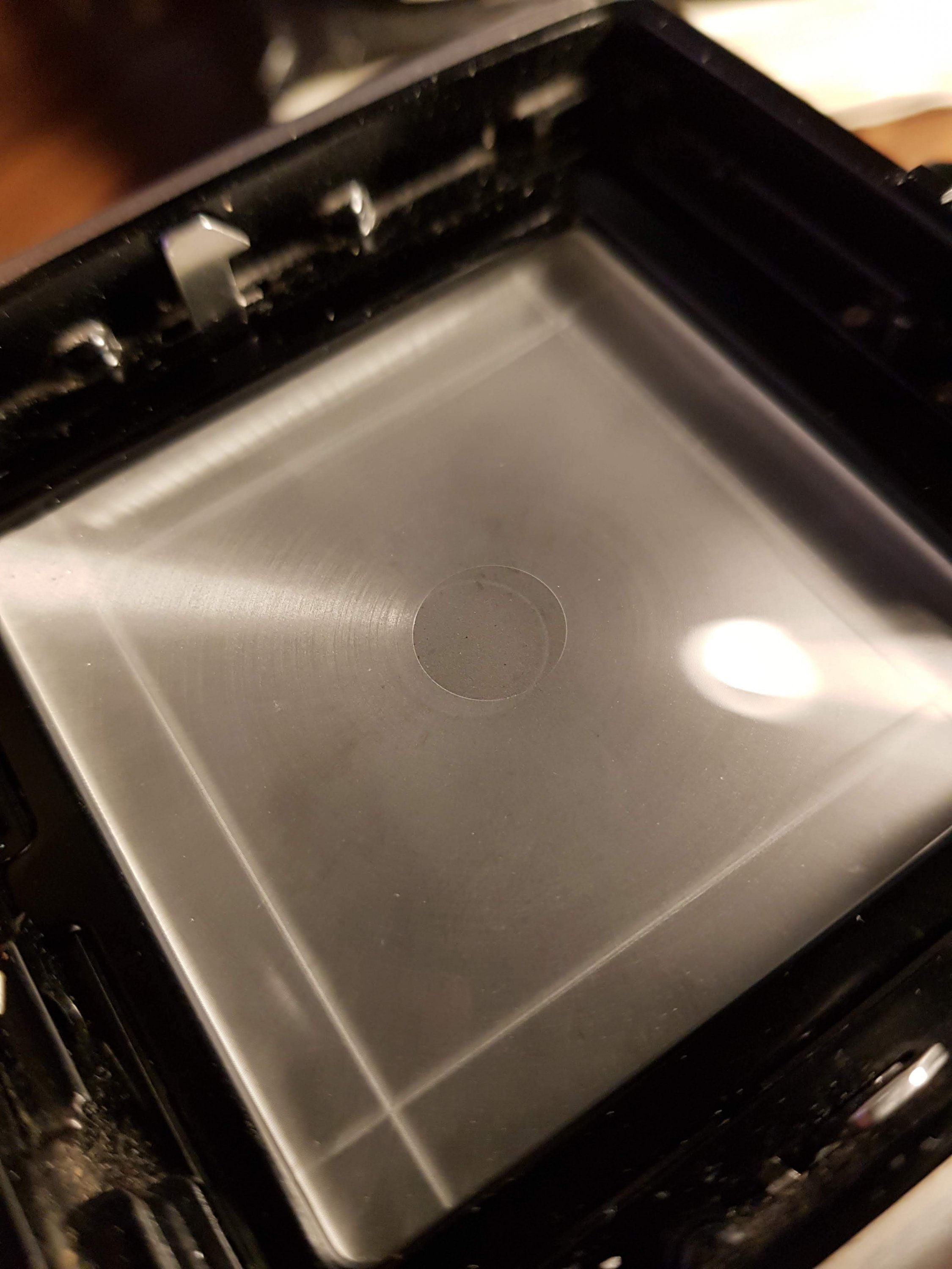

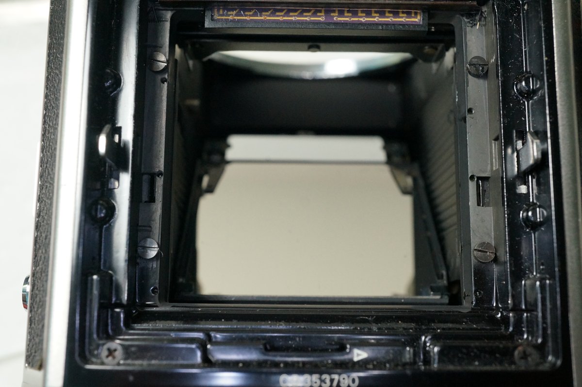

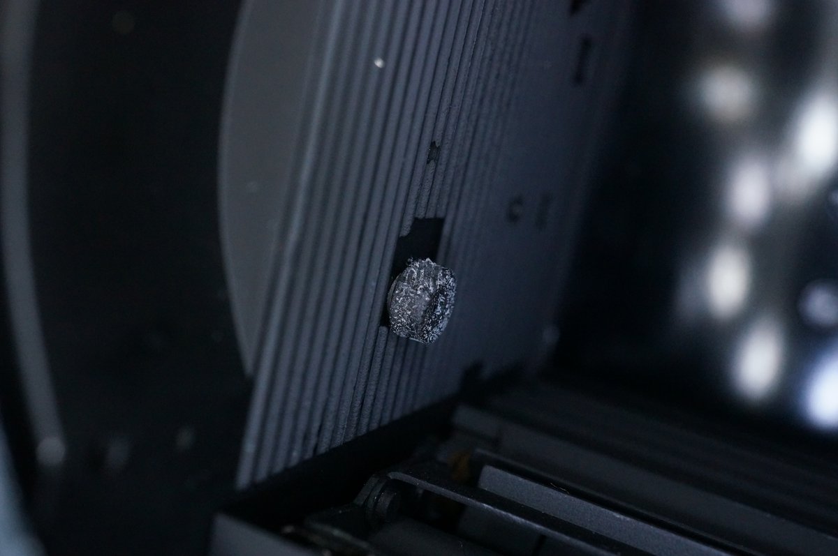

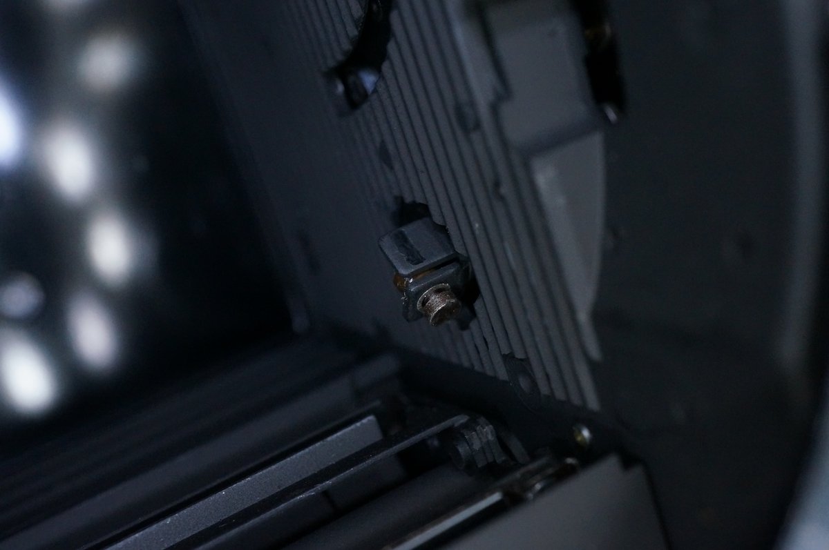

Hello from France,
My Bronica EC got problems with his mirror's bumpers :/ (picture link) i'll try to find solutions, 3D printed plans, spare parts, ideas etc. if anyone can help :tongue:
https://flic.kr/p/2m4Df12
thanks !

Here are some links related to this issue:
https://www.photrio.com/forum/threads/bronica-ec-possible-gummy-mirror-bumper-repair.117578/
http://35mm-compact.com/forum/viewtopic.php?f=13&t=53005&p=813010 (in French)
I had a similar issue and made a temporary fix by putting one wrap of electrical tape around the post and then a small rubber O-ring from an eyeglass repair kit over that. I haven't got around to doing anything more to it. The post on, I think, the viewer's left side of the mirror box sets the resting position of the mirror, so it affects the focus, and you have to test whatever bumper you use to assure correct focus. Your picture is of the post on the viewer's right side, which may be a shock absorber and not set the mirror position (but you should inspect the post on the viewer's left as well).

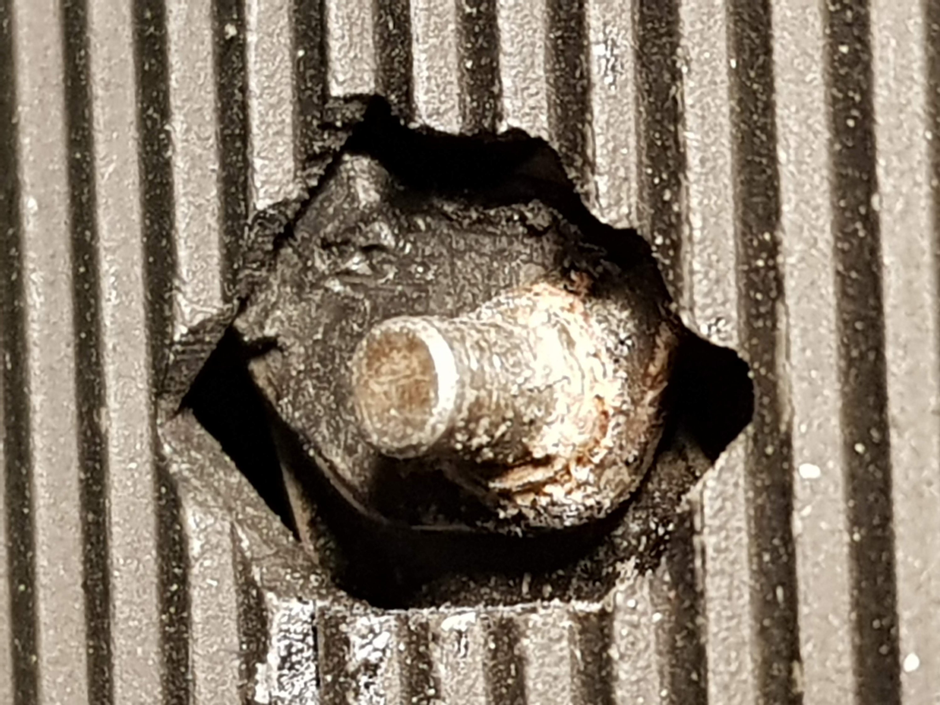

Both sides of my bronica's bumper are broken/wrong, i know that one of them isn't "useful", the link of the picture i've sent is the actual side who affects focus :
20210610_222245.jpg 20210610_222353.jpg 199503544_439632777206196_3547066299541977473_n.jpg
the "useless" side :

I'm not near the camera at the moment so I can't check, but my memory is that the post on the side you're calling "useless" doesn't move and is the side that the mirror rests on, so you need to experiment with the size of the bumper (I used an o-ring) to get the focus correct. I think the post on the other side is spring loaded and moves under finger pressure - it's the shock absorber.
Basically your choices are to find an experienced camera repair person to fix it, or to experiment with it yourself until the focus is correct. The person in the earlier Photrio thread seems to have given up before figuring out whether it was the mirror or focusing screen that caused his problem.

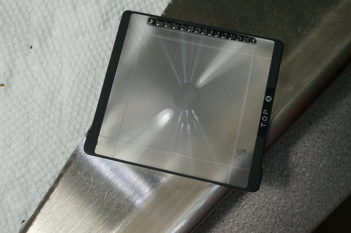

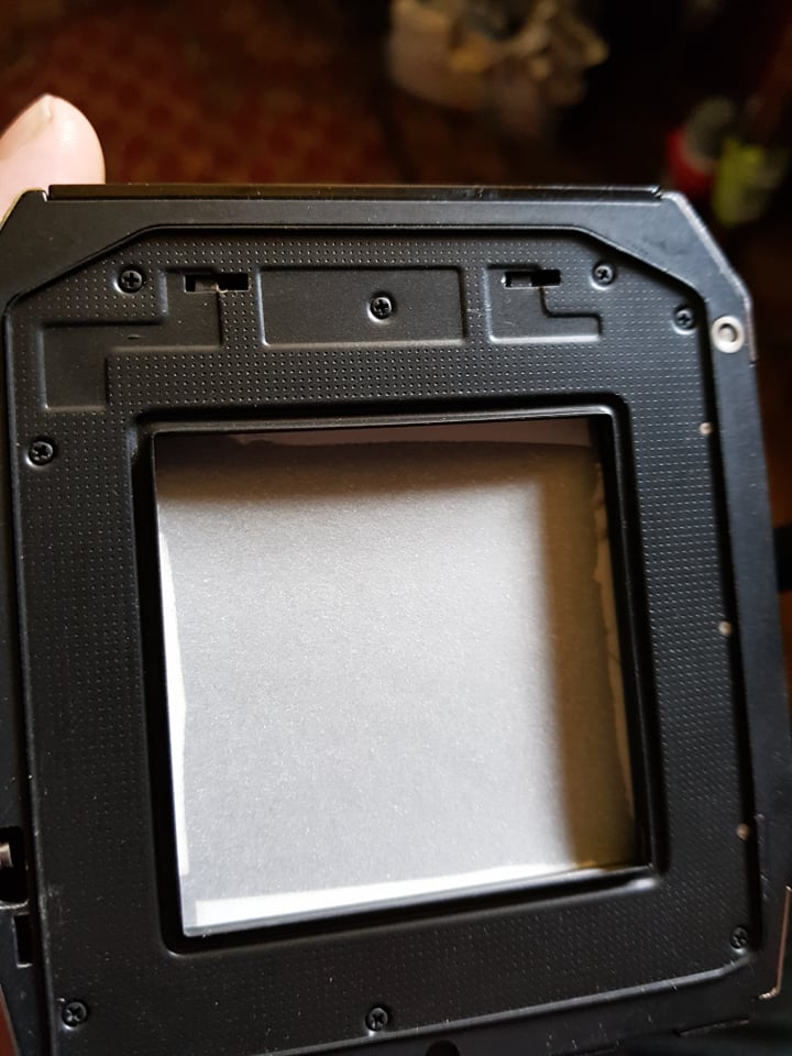

oh i'm stupid :D i've checked the focusing screen and his metal frame, foam etc... but don't remember which side is up :D the bright or mate ? :D

Nice pictures in that flickr link. The focusing screen goes matte side down (toward the lens).
The Bronica S2 and EC both have issues with foam involved in locating the mirror and focusing screen into place that can degrade and alter the position of the focus. But the issues are different - the S2 has foam under the mirror pressing it up into place, and I think foam on top of the focusing screen pressing it down into place. The EC is a little easier to deal with because it has a user-interchangeable focusing screen.

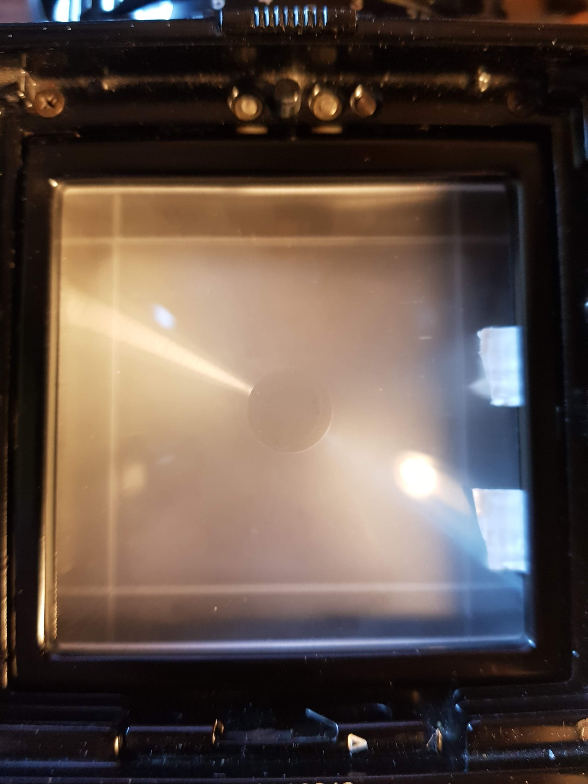

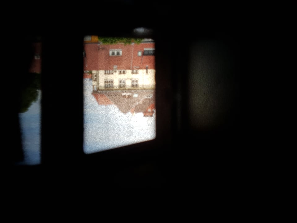

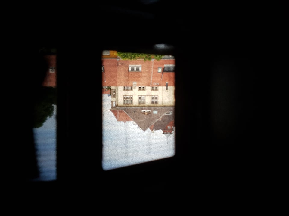

i follow the fix of the guys on flickr (6mm "spacer") but whatever the side of focusing screen i can't reach infinity :/ :
It's just a test, but the moral of the story : it doesn't works /.
1 : with "matte" side & matte center focus circle toward lens, i turn to infinity the focusing ring at maximum, and it's blurry :
2 : with the "shiny" side & "matte" center focus circle toward lens, i get infinity approx 8-9 meters, infinity is 1 or 2 meters earlier according to numbers on lens focusing ring

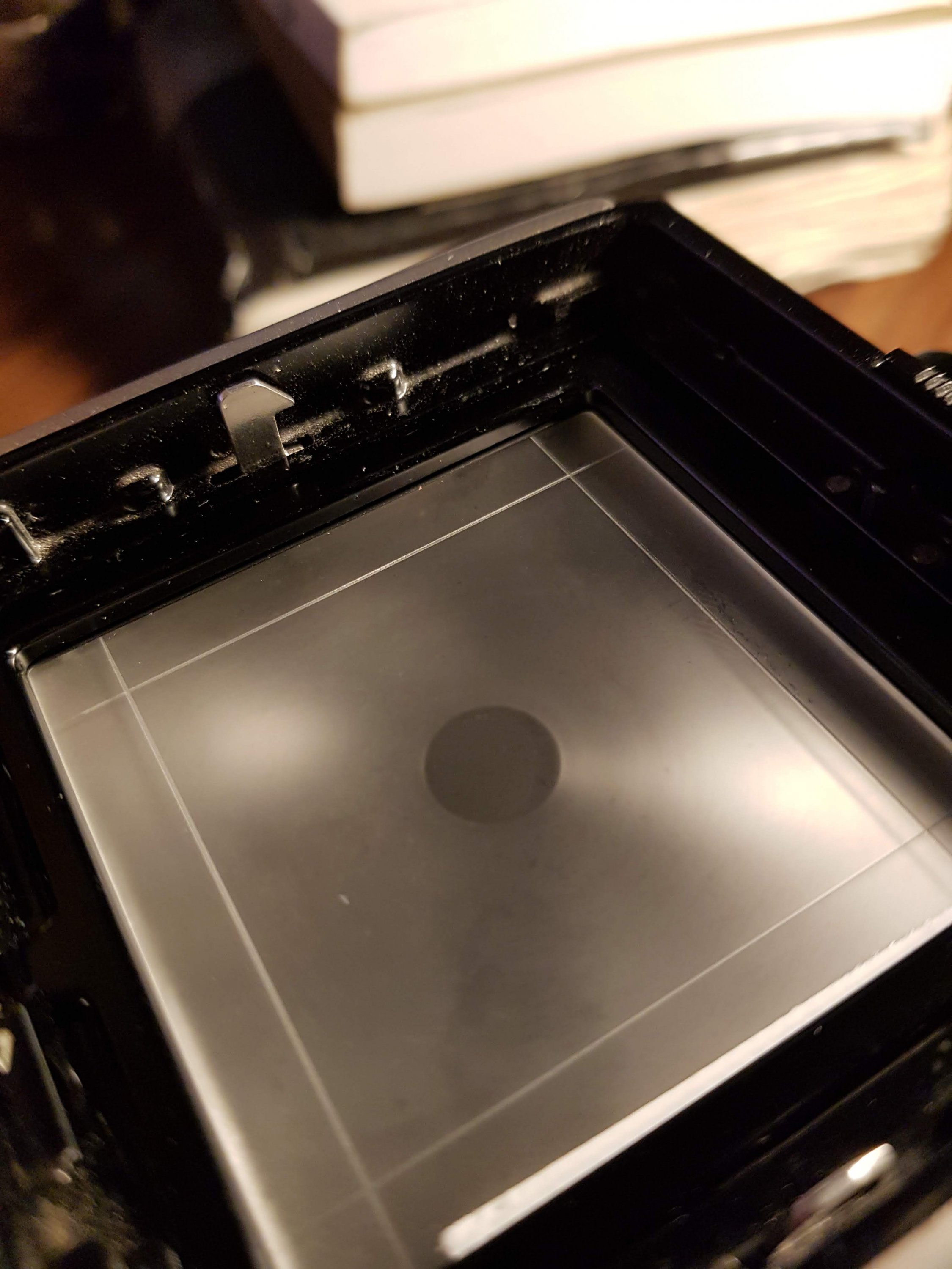

For reference, here are the mirror stops for the EC-TL.
Left side with the adjustable stop for the lower mirror.
Right side:
Any time theses are replaced, some adjustment would have to be made to the mirror stop or screen. Focus screen matte side down towards the mirror.

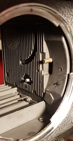

Thanks, but do you have measurements, diameter of the right ? size of left piece ? i guess/hope there is no difference (for this 2 pieces) from EC (mine) and EC-TL ?
so this side is top ?
and this one toward lens/down :

The rubber mirror bumper on the Right sdie looks similar, it's ~6mm like the Flickr site said, but you can't really measure accurately, and regardless, you need to adjust the focus when you replace these parts. The mirror position is set by the Right spring loaded stop for both mirrors (on the EC-TL).
The focus screen side on the EC-TL is obvious, probably because people had this issue?
The screen adjustments are the 4 slotted screw that the screen sits on:

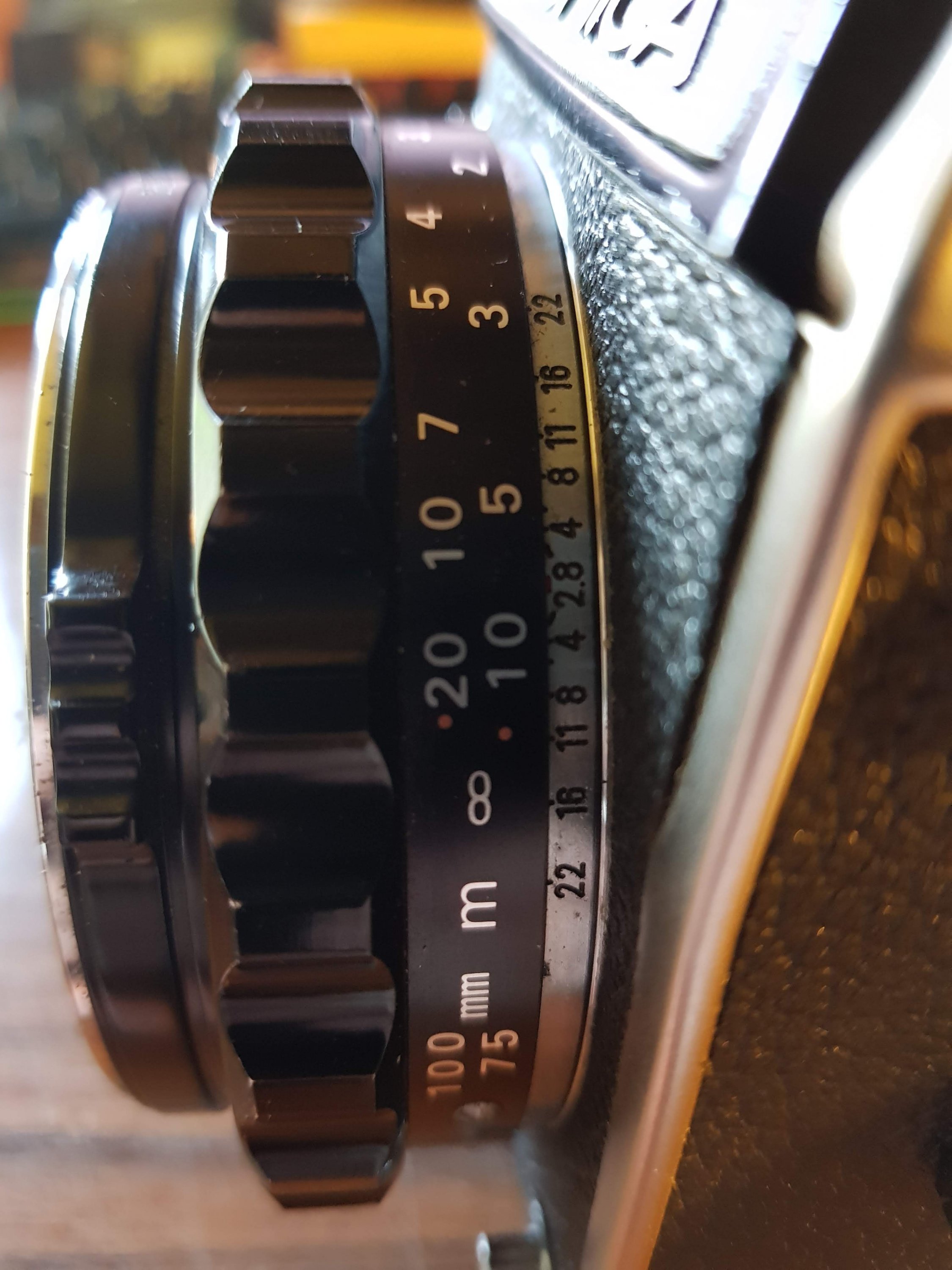

For the moment that doesn't matter anymore, a test with tracing paper (instead of the film) on infinity showed me that the lens has problems, and i think i'm not able to fix that myself
with lens on infinity (according to my read on the lens ring) :
i reach a good/sharp focus between 3-5 meters (when i read lens ring) :

If that lens had previously been apart , it's quite possible it was reassembled with the helix ( the correct word ? ) threaded in from the
wrong start thread . Not that I've ever done that :sad: . Peter

Keep in mind, the helicoid and the lens are separate parts on the EC's (except for the longer telephotos). You'll have to figure out which one is out of spec (or has been incorrectly reassembled).

@wakks what lens do you have? If you post pictures of the lens someone may be able to to tell if it's mis-assembled. Are you sure you're reading the correct distance scale? Most of the focus helicals have scales for 2 or 4 lenses, and the index mark for the distance is not at 12 o'clock but some place to the left, so I often have to double-check myself when trying to read a distance.

@reddesert I've bought a new helical ring, now I've infinity focus with tracing paper placed on film place, but i don't have fixed the mirror's bumpers for now, can't find the "good" measurements etc.
