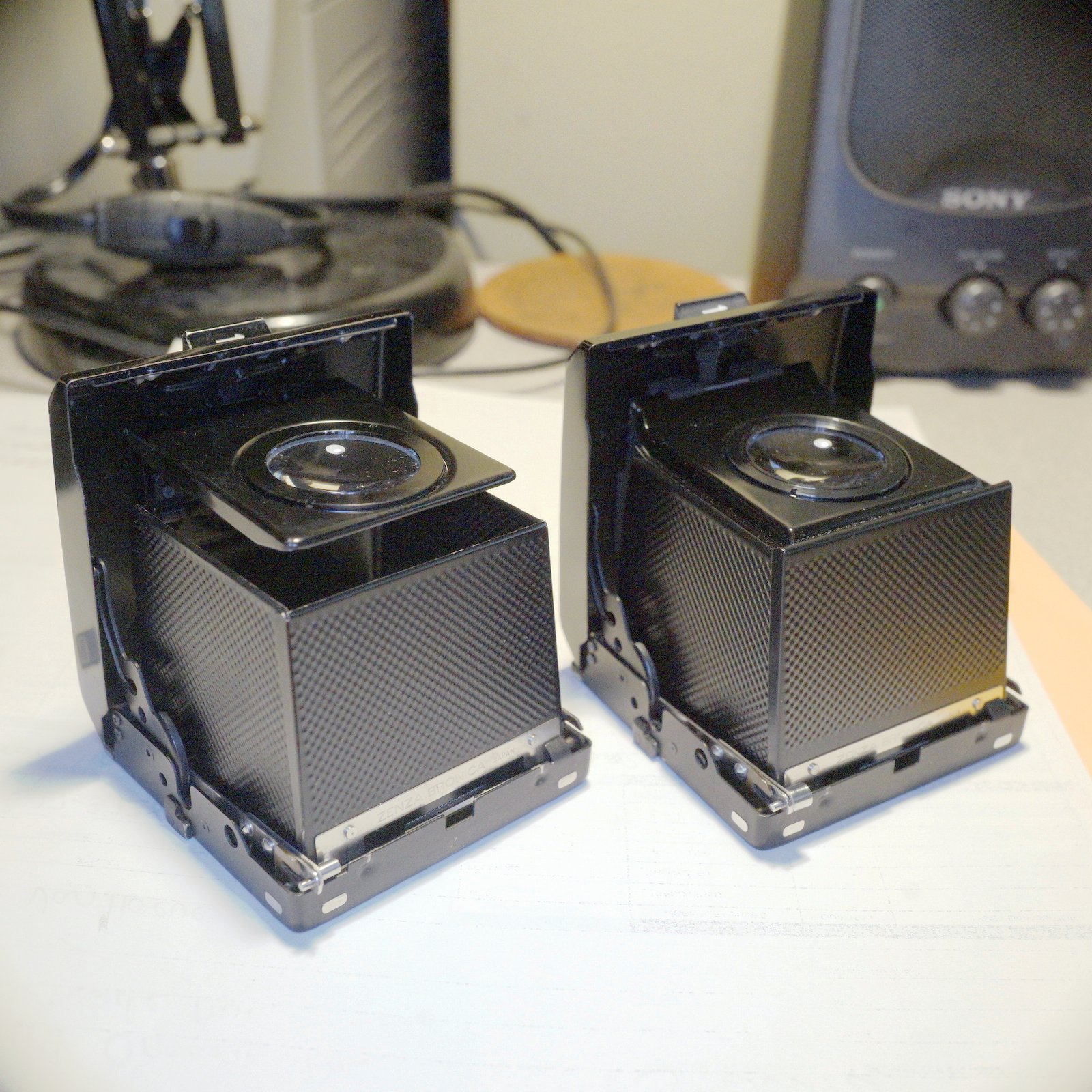

I have an EC-TL only, but I do have 2 different waist level finders for it.
The newer one on the right has the magnifier lower and sealed against the baffle, and the release slider (the slider on the top with the arrow) is plastic as opposed to metal. I use the older one (on the left).

The newer WLF for EC-TL improves viewing in bright side light. Older model has magnifier quite a bit above the level of side curtains and bright light from a side can drop right into the viewing experience. So if there is a choice, it is the newer one for that particular difference. otherwise there is no difference as far as camera function goes.
